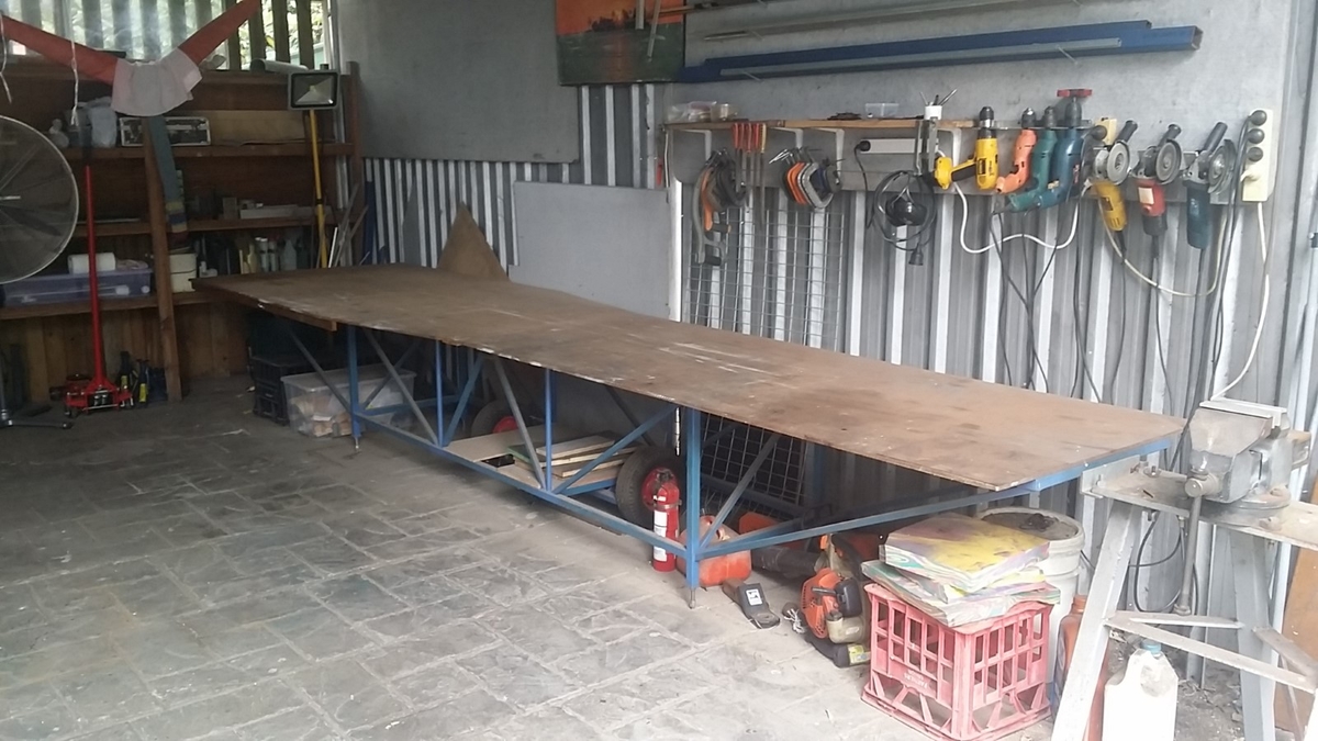

So - having had the big tidy-up and all the various half-done parts of the project have their own project box on its own shelf in the relevant steel cabinet among the line of steel cabinets (oh, joy, I can find everything in an instant now), so it's time to get back to productive work.
Here is what I think of as rather an historic photo of the work-bench - taken yesterday, and historic because it's ancient times since the bench was last completely clear -

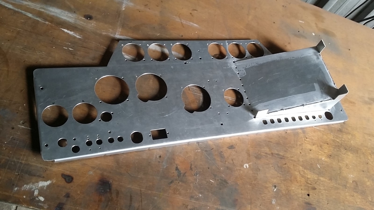

Right now there is just one thing on the whole work-bench, so even I can't confuse myself and start wondering what I was working on last! Here is a photo -
That is how far I got with building the instrument panel about two months ago. The instrument positioning looks a bit unconventional because they have to be located where they won't clash with the truss which resolves the landing gear loads, which is directly behind the panel. There's only about 3mm clearance around each instrument, so they have to be placed quite accurately, especially since the panel is rubber mounted, though it doesn't move more than about 1-2mm each way. Down the track I will invest in a pair of MGL digital instruments and do away with most of the steam gauges but for the moment, due to their $6-7k price, they will have to stay on the wish-list.
The angled flat portion of the panel is for a nav tablet and the pieces sticking up will be folded over and trimmed, to hold the tablet in place. Next stage is to make up the parts to complete the flanges at the corners and weld them in - I suppose I can still remember how to weld ...
