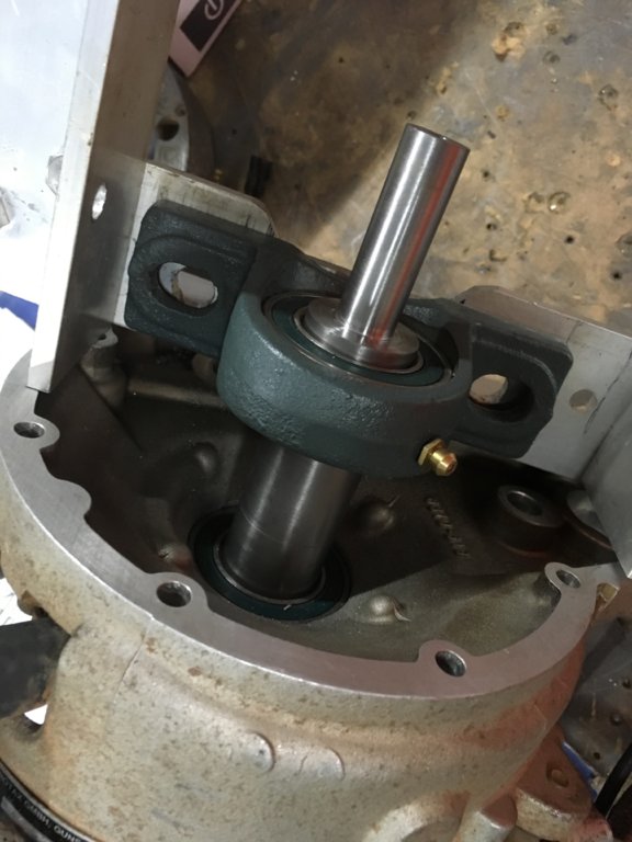

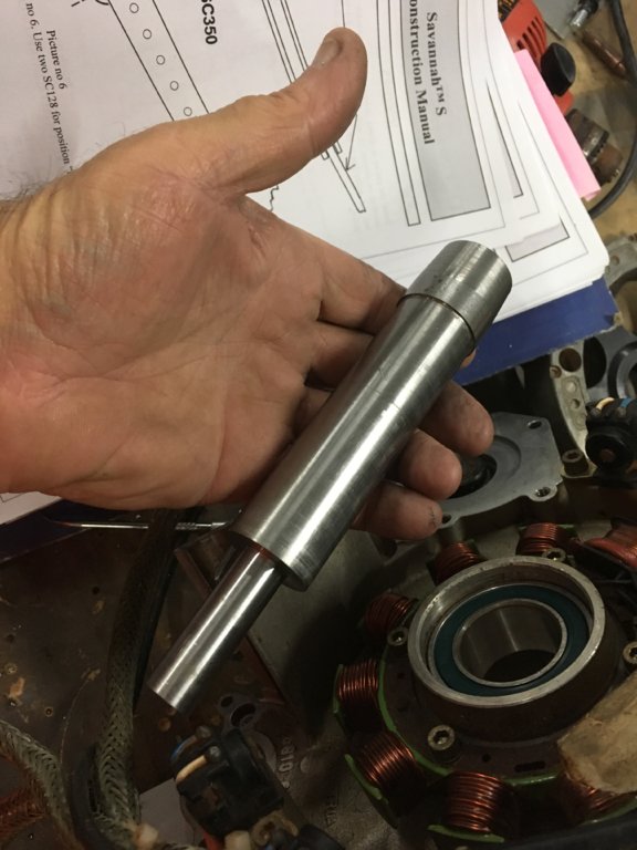

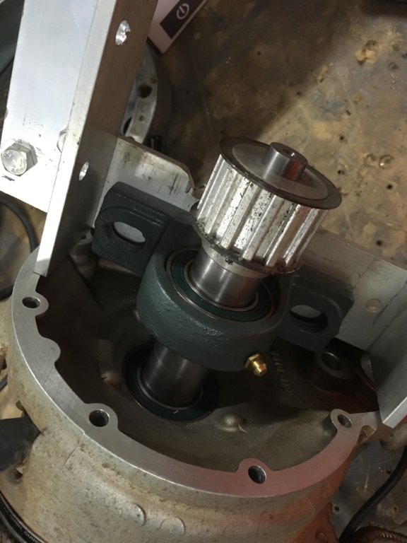

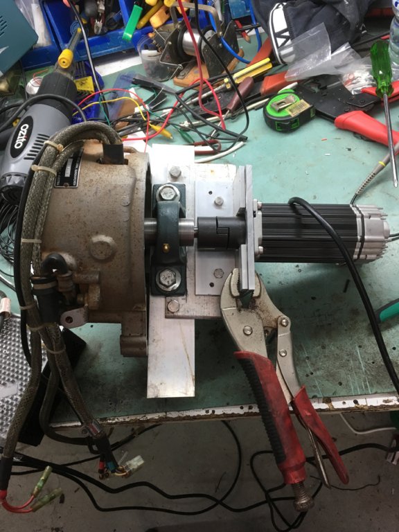

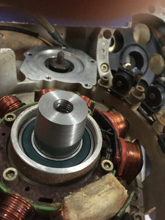

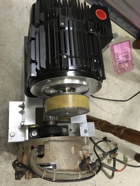

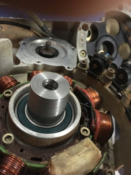

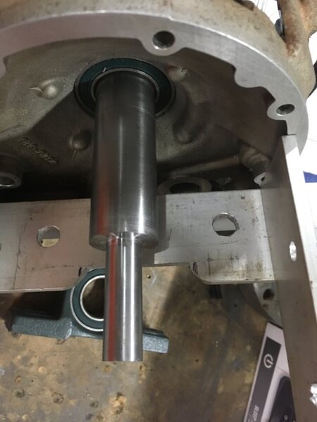

The new AC servo is 240v and 1.8hp but because the torque can be controlled over the whole rev range it is far more efficient and powerful. As a std motor with nothing connected it runs when hooked up to the generator it hardly runs but the unit has software and a program that once hooked up to the mechanics it takes about 15 mins and does a whole heap of tests and turns that tailor the torque curve. The motor takes 9 amps from the mains supply at full grunt. I originally bought a servo that I thought would do the job but it wasnt even close. The original test rig is a 1.3kw normal AC motor and I had to gear it with a Vbelt pulley the other way as it wouldnt run the generator so this is why it only can do 2000 rpm. The AC servo is geared up the motor does 2650 rpm but upped now by gearing to 5300 and it does it easily. The generator would drag I think around 3 to 5 hp from the engine easily. The reason the servo works so well is the ability to taylor the torque and of course the servo in real terms is far more powerful. Picture of the unit as it runs now but I have to put it on a stand and also bolt it down because at 5300 rpm the gyroscopic effect the unit wants to swing around in a circle on the floor. Also picture of the original servo that I thought would drive it direct and that was hopeless. That servo would do 6000 rpm directly but wouldnt hardly even turn the generator at all. I got a second Generator and got Cz to machine out the housing and put a high end sealed bearing into the generator housing as the original only has a brass bush. I turned up a new shaft and fitted the toothed belt pully and the second bearing to ensure smooth alignment and running due to the high speed of the shaft
