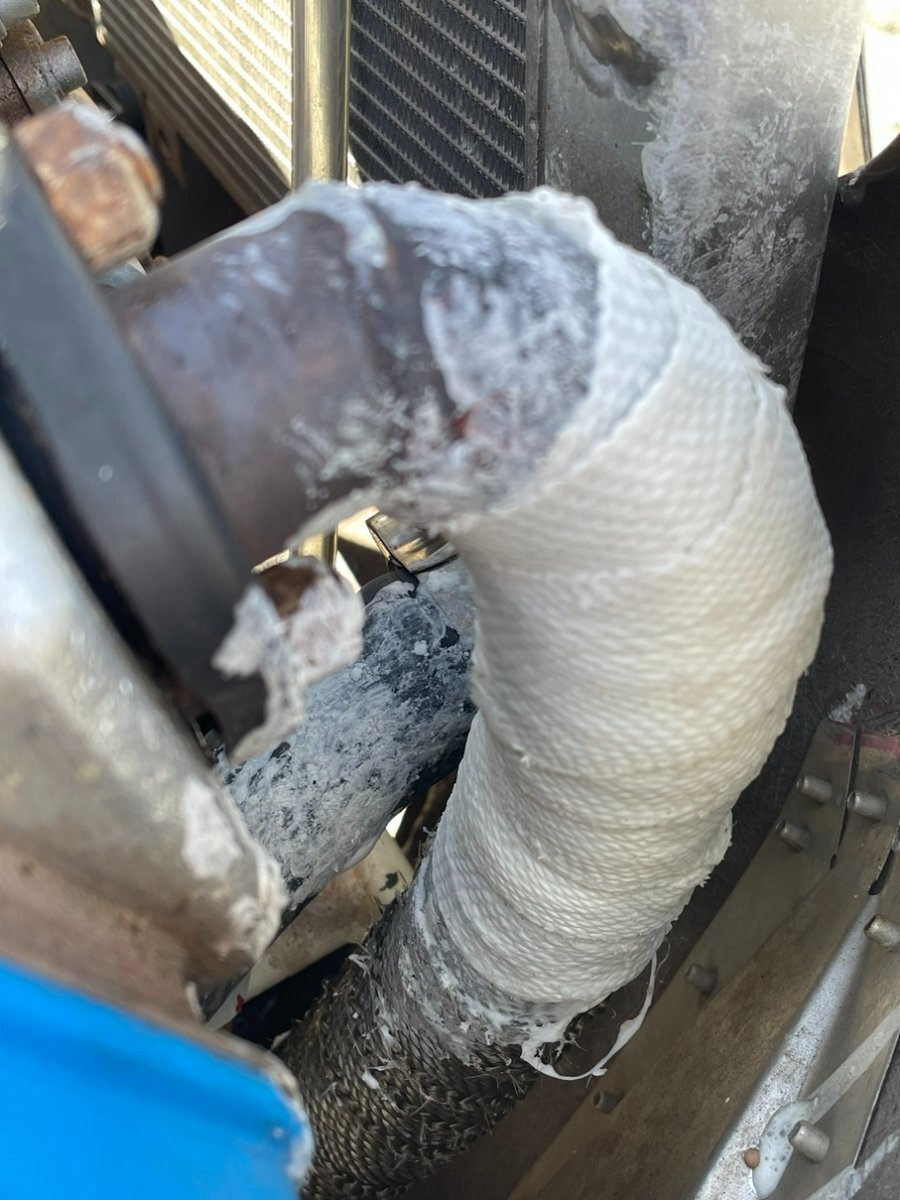

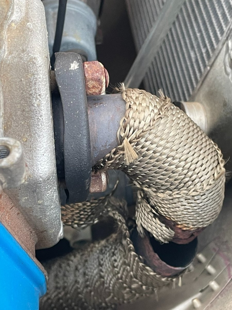

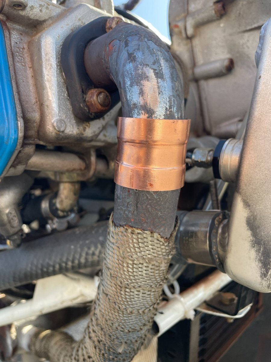

onetrack Posted 20 hours ago Posted 20 hours ago Moneybox, the problem with a simple rat trap vent is the potential to admit CO gases into the cabin. The exhaust system cuff or wrap is a far safer arrangement. 2

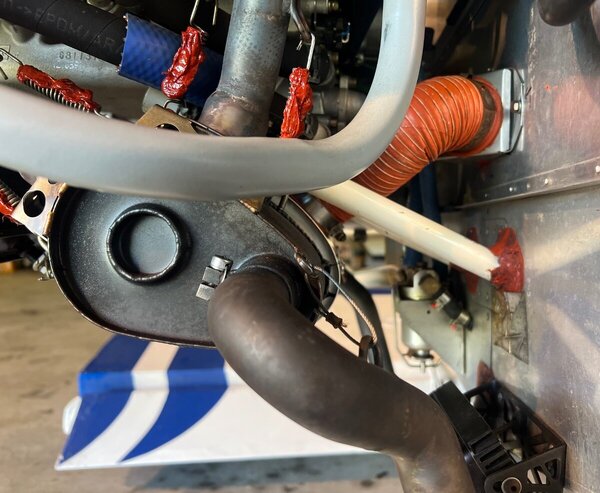

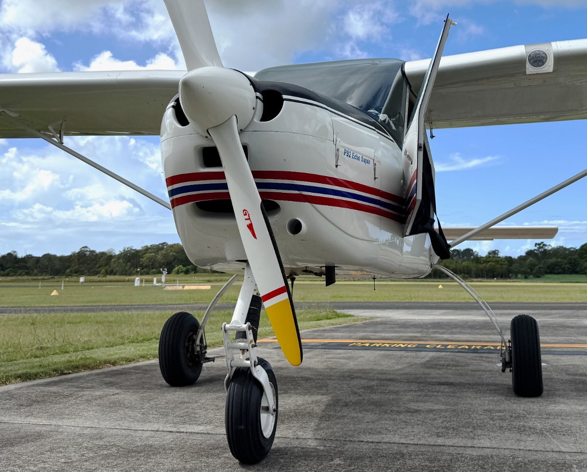

Blueadventures Posted 13 hours ago Posted 13 hours ago 7 hours ago, Moneybox said: If you have enough air temperature in the engine bay perhaps a simple Rattrap Vent would be a quick fix? I have fitted the factory and British approved system and through firewall valve setup. 1 2

BrendAn Posted 5 hours ago Posted 5 hours ago 1 hour ago, facthunter said: Anything like that is hardly Likely to be stink free, is it? Also on a cold day it would be lucky to be hot enough to do much. I wouldn't take the Carbon Monoxide risk. Nev same system as blues in the texan i trained in. worked great and there was no smell at all. 1

Blueadventures Posted 3 hours ago Posted 3 hours ago 15 minutes ago, facthunter said: The cabin generally runs at a Pressure Below ambient. The Oil tank has a breather. You haven't told me where that goes. It can even vent OIL in turbulence. You can't guarantee you have No exhaust Leaks. Nev Oil vents to fire wall bottom; away from engine bay. 1 1
