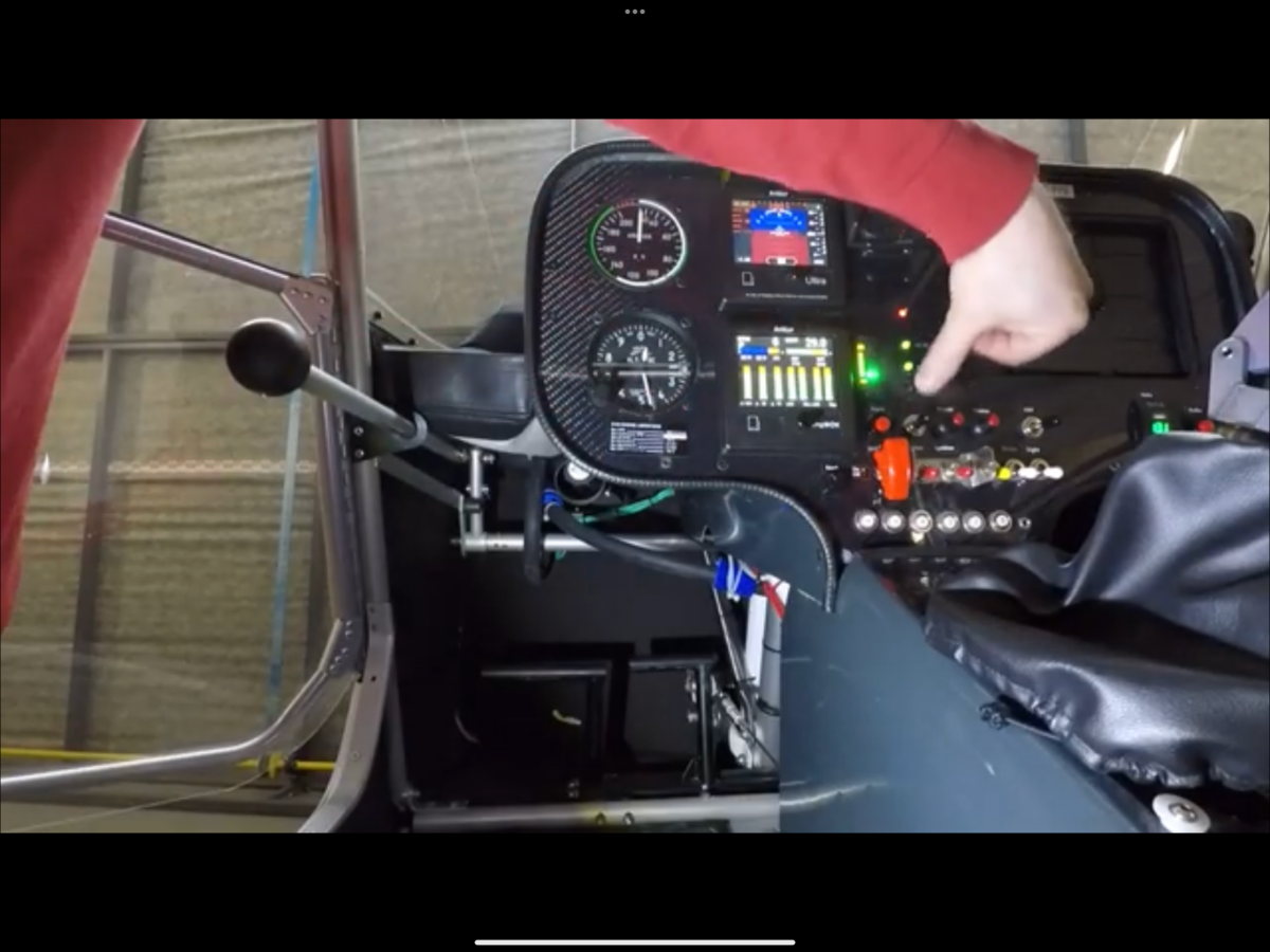

Mike Gearon Posted April 15, 2022 Posted April 15, 2022 That’s so detailed. He’s done an extraordinary job including the LED lights for flap indication on dash. radio up high has given him space on the dash for iPhone and iPad. Brilliant! I like the pilot and passenger heaters. Prob not needed in Australia if we aren’t flying winter in southern states. Just more water hoses and electrics to have potential problems. Iceland different story! I heard him mention thermostat. I have no idea if we have water or oil thermostats in 912. I just know they take ages to heat up and I do runups facing away from wind and opposite to what I’d do in air cooled engines. Learned to start the engine before doing anything else. Start then close door, seat belts and checks. Even then it’s just wait and wait for temp before takeoff.
Mike Gearon Posted April 16, 2022 Posted April 16, 2022 I’ve just noticed the other clever thing Harry from Iceland has done. The stock Skyranger throttle setup is in the way for entry/ egress. It’s easily bumped wide open by yourself or passengers and I’m probably not alone in finding it doesn’t hold TWO on it’s own. Harry has it solved. Throttle is retained at idle and isn’t in the way and can’t be bumped open. Throttle arm weight is downward and probably as such nicely balanced. Either that or he pegs it wide open. 😳 I’m pretty sure it’s idle. it’s probably the result of those 24 hour days and 24 hour nights and lots of thinking time. I’ve been to Iceland. Nice place to visit but….
Blueadventures Posted April 17, 2022 Posted April 17, 2022 3 hours ago, Mike Gearon said: I’ve just noticed the other clever thing Harry from Iceland has done. The stock Skyranger throttle setup is in the way for entry/ egress. It’s easily bumped wide open by yourself or passengers and I’m probably not alone in finding it doesn’t hold TWO on it’s own. Harry has it solved. Throttle is retained at idle and isn’t in the way and can’t be bumped open. Throttle arm weight is downward and probably as such nicely balanced. Either that or he pegs it wide open. 😳 I’m pretty sure it’s idle. it’s probably the result of those 24 hour days and 24 hour nights and lots of thinking time. I’ve been to Iceland. Nice place to visit but…. That's the push to full and pull to idle setup in the image. 1

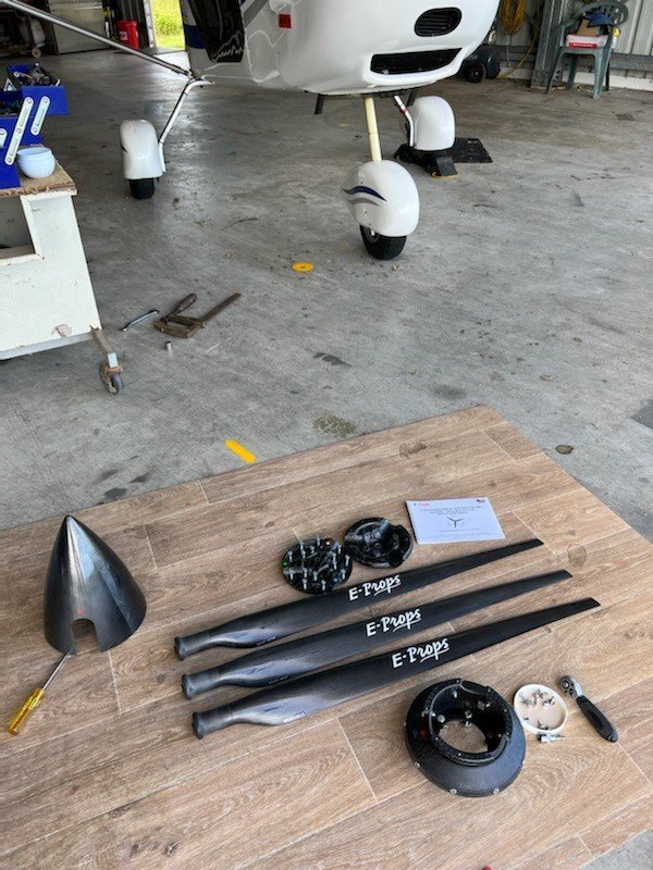

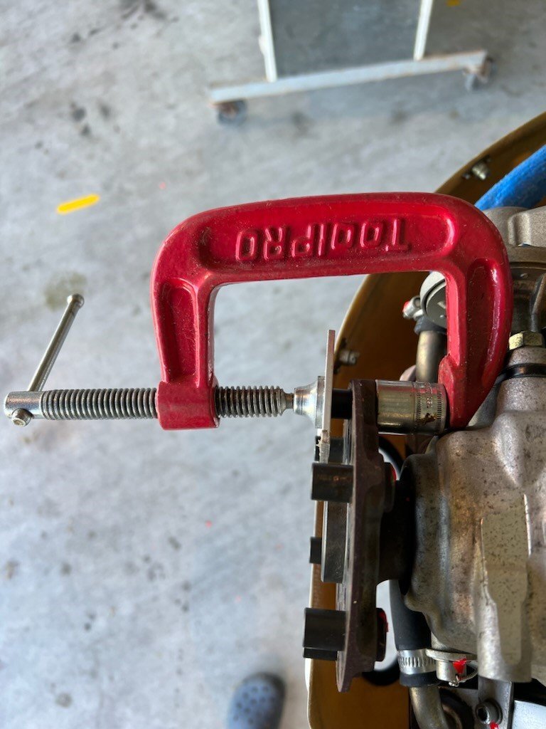

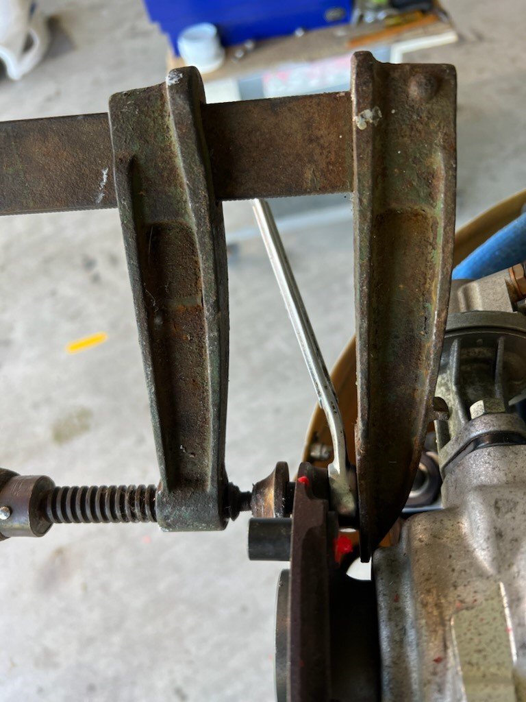

Blueadventures Posted April 18, 2022 Posted April 18, 2022 Fitted eprop onto the Nynja's Rotax 912 ULS ready to torque and fly tomorrow all going well, rain to stay away. Needed to extract the prop lugs and used a 'C' clamp first then a sash clamp was best. 1
Blueadventures Posted April 18, 2022 Posted April 18, 2022 Yes 175 and 20mm spacer is perfect, same clearance as the DUC had between backplate and cowl. 1
Blueadventures Posted April 18, 2022 Posted April 18, 2022 1 hour ago, Kyle Communications said: What is the size. 175? Hi Mark FYI Paul at Flylight just sent me this info from his testing on a Nynja;- "I have been testing one, we have put in for French approval for it and working towards U.K. approval - I will be interested in how you find it. It has a strong ‘constant speed effect’ - it’s a bit like an automatic gearbox - allowing high RPM at low speed in the climb without high cruise RPM. It achieves that at the expense of some blade efficiency at the lower speeds ( it’s a kind of aerodynamic slipping clutch thing) but the idea is that it allows the engine to release more power and give a net gain. A prop without this effect might be more climb efficient if set to fine pitch, but would then be revving too high for the cruise. The answer of course is an inflight variable pitch / constant speed prop, but they are very expensive, complex and normally heavy too. It’s a very smooth prop, which is nice, and doesn’t have any annoying harmonics ( unlike some others we have tried that claim similar effects), and is super light which means lower rotational intertia and a nice soft stop. But re do your weight and balance after changing - it might throw you out if the aft limit if a parachute is also fitted! I have mine (912ULS) set so it pulls around 5300 in the climb at 75mph. An interesting effect is that if you pull the nose up and slow down to 60mph the ‘clutch slips’ and it revs up to 5400 or more - but you can feel vibration then from the stalled blade flow. At 75 it’s super smooth. If I leave it at wide open throttle and put the nose down to level off, the RPM stays at 5300 all the way up to 115mph or so and only after that starts to rise hitting just under 5500 at 130mph. Cruise around 4000 RPM for 85 - 100mph at around 4400. Kievprop takes a lot of beating for a very economical good performing prop. ( and we really hope they can survive the war and continue) This slots in at a higher spend level but with some interesting features and enhancements that unlock some advantages." 1 1

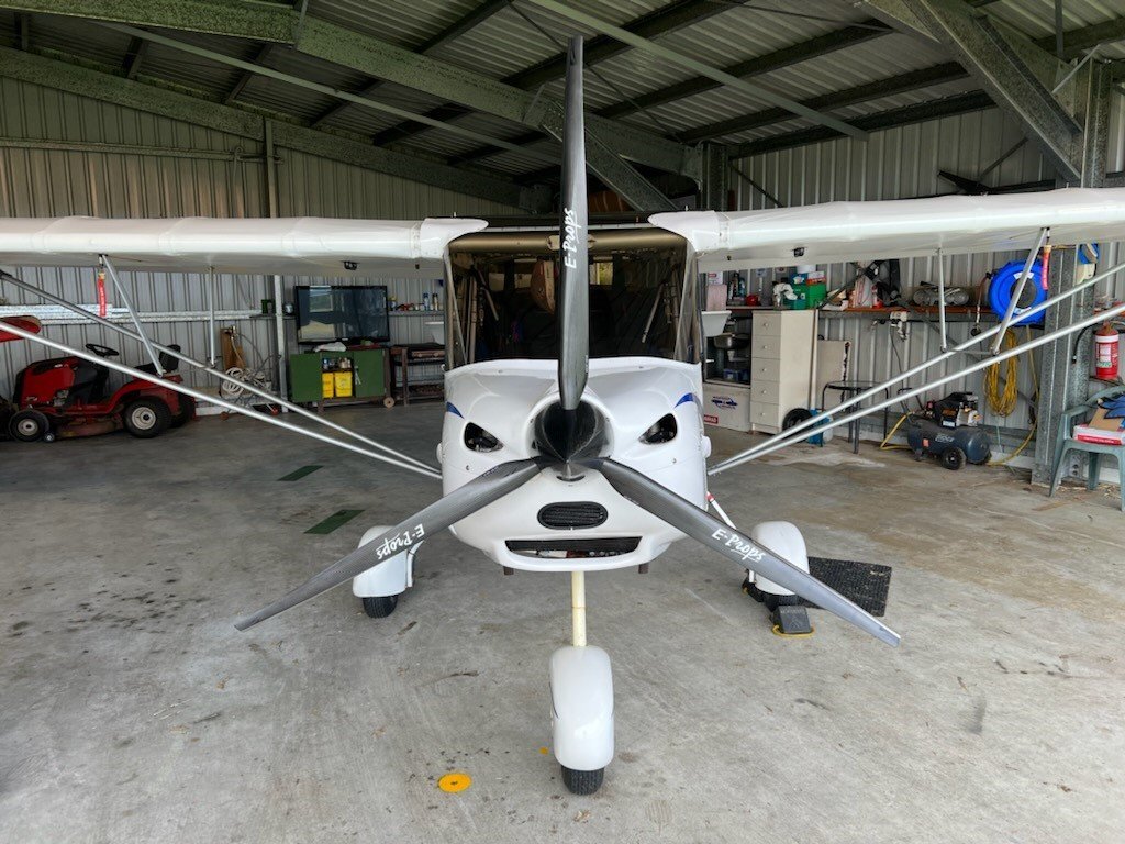

Blueadventures Posted April 20, 2022 Posted April 20, 2022 Did fit in an hour flight in the Nynja this morning. My findings were that I'm very happy with the E-Prop propeller. It was set with the three blades at 24.9, 25 and 25.1 degrees; being within the 0.3* I decided to leave as is and fly to evaluate. Ground static rpm was 5,400. First flight climb 1,400 f/m (better than DUC never much over 1,000 one up) Noticed had to put in right rudder (was perfect with DUC and the rudder input was more than acceptable) also during taxi to take off point noticed low rpm was a faster travel speed, also runway is bitumen sealed. 4,500 rpm 85 kts; 5,250 gave 108kts (quickest with DUC was 105 kts at 5,500 rpm). Landed and moved rudder bungee 6mm to port. Take off climb 5,250rpm and 1,250 ft/m OAT 24*C. Only slight need of right rudder (certainly acceptable) so will move rudder bungee another 2mm to port. Will before next flight re-pitch for 5,500rpm static. There is wild weather coming so will be a week or so before flight. 1 1 1

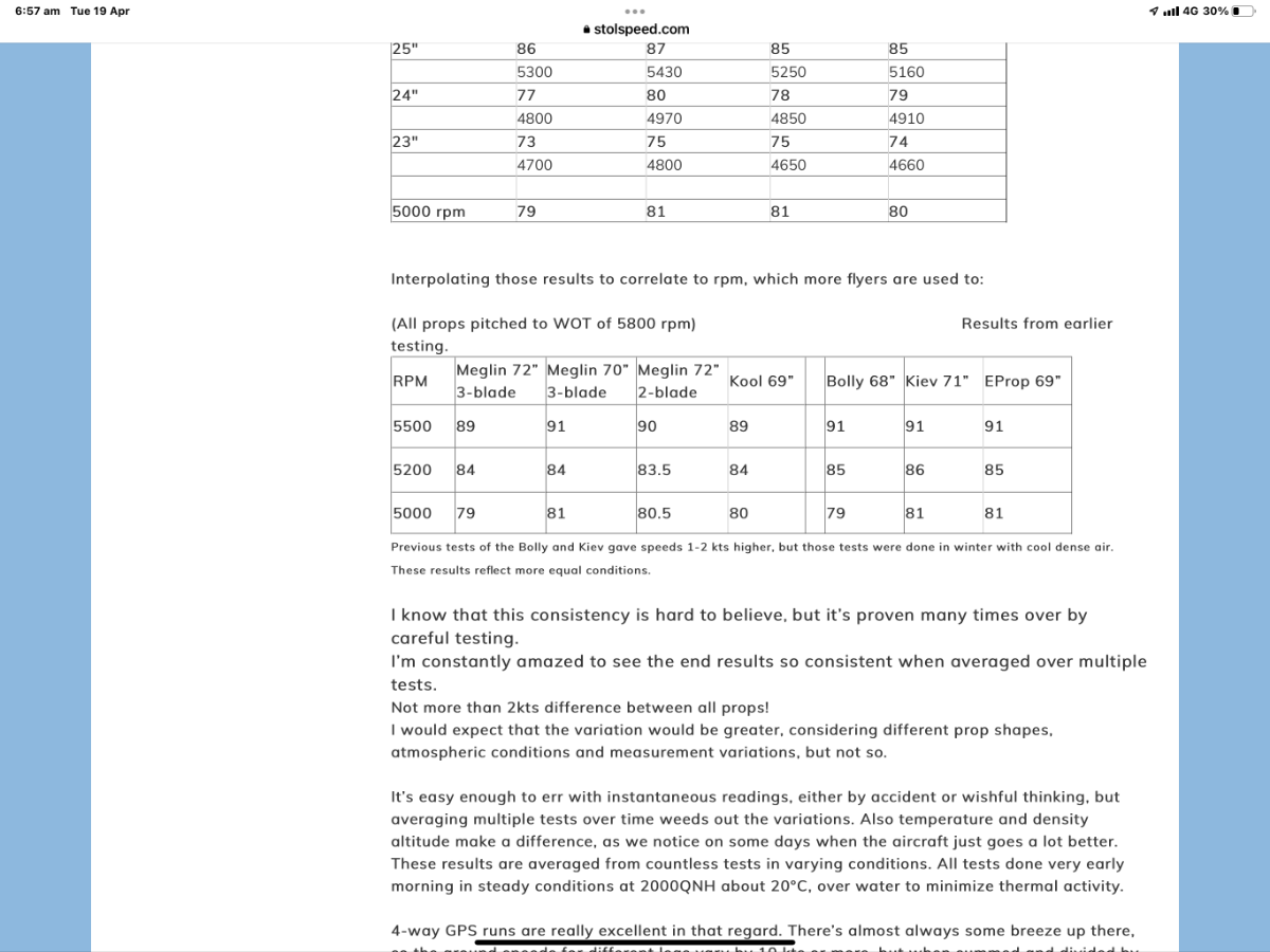

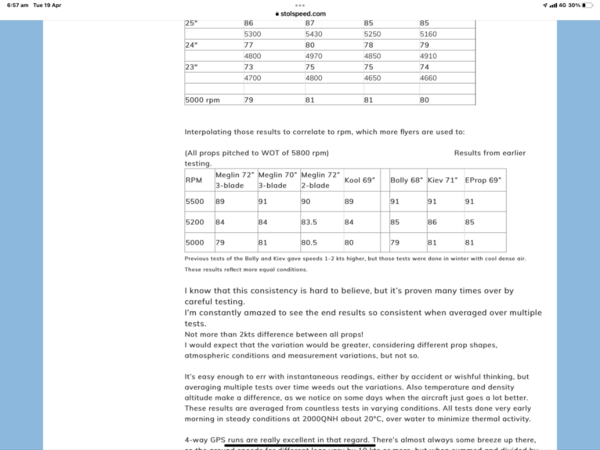

Mike Gearon Posted April 20, 2022 Posted April 20, 2022 I was concerned looking at that claim of 130mph/ 113kn and how that could be achieved. Reviewed the extensive tests JG has done. I’ll list them here. E prop at the time was very similar. They’ve obviously been developing since.
Kyle Communications Posted April 21, 2022 Posted April 21, 2022 No they have not been doing any development at all the design is the same. The prop JG tested I gave to him it was a 175cm prop but he did not test it how he should have...yes you can test the props all different ones to a type but that is not how these are to be used. JG is testing the prop wrong. His tests are based on how you test a constant speed prop not a ground adjustable fixed pitch. The Eprop has been designed to take advantage of the Rotax engine properties and is modern design with modern materials not something the Wright Brothers used. You set the prop up as per the manufacturers specs not what you think if you want max performance. The drone article posted by Blueadventures basically says it all 1
Blueadventures Posted April 21, 2022 Posted April 21, 2022 49 minutes ago, Kyle Communications said: No they have not been doing any development at all the design is the same. The prop JG tested I gave to him it was a 175cm prop but he did not test it how he should have...yes you can test the props all different ones to a type but that is not how these are to be used. JG is testing the prop wrong. His tests are based on how you test a constant speed prop not a ground adjustable fixed pitch. The Eprop has been designed to take advantage of the Rotax engine properties and is modern design with modern materials not something the Wright Brothers used. You set the prop up as per the manufacturers specs not what you think if you want max performance. The drone article posted by Blueadventures basically says it all Mark having done two flights yesterday, total 60 minutes I am rapt in the E-prop and its performance yesterday exceeded my expectations and that is at 5,250 rpm WOT S&L so when pitch altered to deliver 5,500 rpm I will be further impressed. Happy to have my information added to your testimonials for E-prop performance as a satisfied customer. Cheers. 1 1
Mike Gearon Posted April 21, 2022 Posted April 21, 2022 4 hours ago, Kyle Communications said: No they have not been doing any development at all the design is the same. The prop JG tested I gave to him it was a 175cm prop but he did not test it how he should have...yes you can test the props all different ones to a type but that is not how these are to be used. JG is testing the prop wrong. His tests are based on how you test a constant speed prop not a ground adjustable fixed pitch. The Eprop has been designed to take advantage of the Rotax engine properties and is modern design with modern materials not something the Wright Brothers used. You set the prop up as per the manufacturers specs not what you think if you want max performance. The drone article posted by Blueadventures basically says it all At the end of the day it’s climb out FPM and cruise TAS showing consistently better figures over the old prop. Sounds like this is what is going on.
