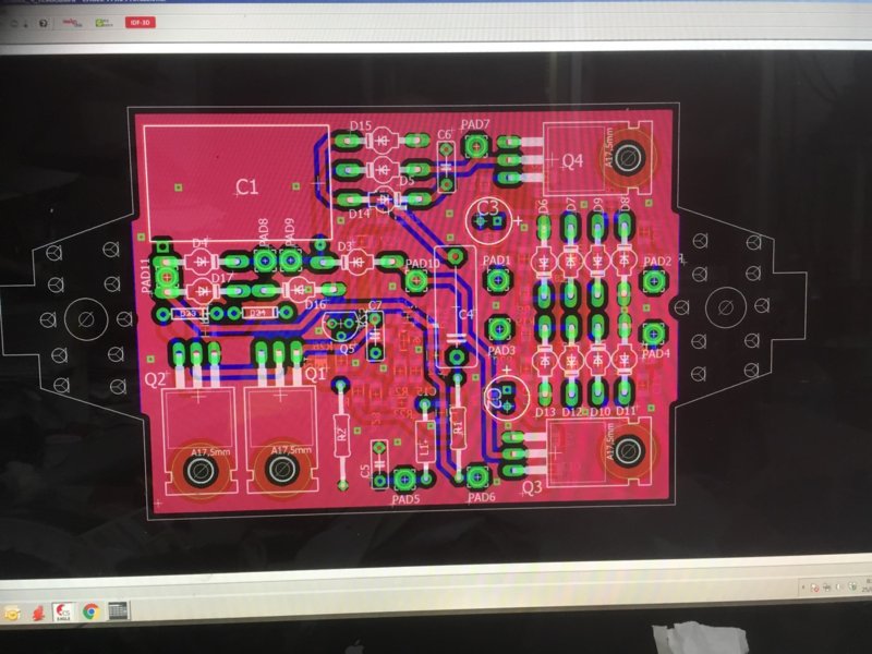

Kyle Communications Posted April 2, 2017 Author Posted April 2, 2017 Update on the Rotax ignition modules. Have a few out there now and all seem to be working very well. Been trying to get the production of them faster and easier as it just is taking way too much time. I have redone the layout of the pcb to make it easier to gets the boards machine assembled by one of our suppliers we use at work. I have asked them if they will do small production runs and they said no problems and my boss came up with a good idea about making a mold from silicone and potting them completely rather than 3D printing a box. I used my CNC machine to make the plug out of aluminium then we made the mold box and tried it out. It actually works very well. I did a test run for a couple using the epoxy we use at work which has a dielectric of 28,000 volts per mm and they came out great. Needs a bit of refining but its certainly doable. I would prefer to have a box made but to get a die made the cost is US$3000 so its out of the ball park. Although I had a call from a mate yesterday there is a guy who may make the die for me at no cost...well just so happens he flys as well and needs some modules so I am well prepared to grease the right palms with boards as required :) 5 1 2

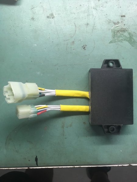

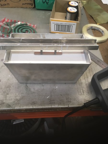

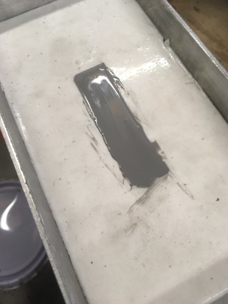

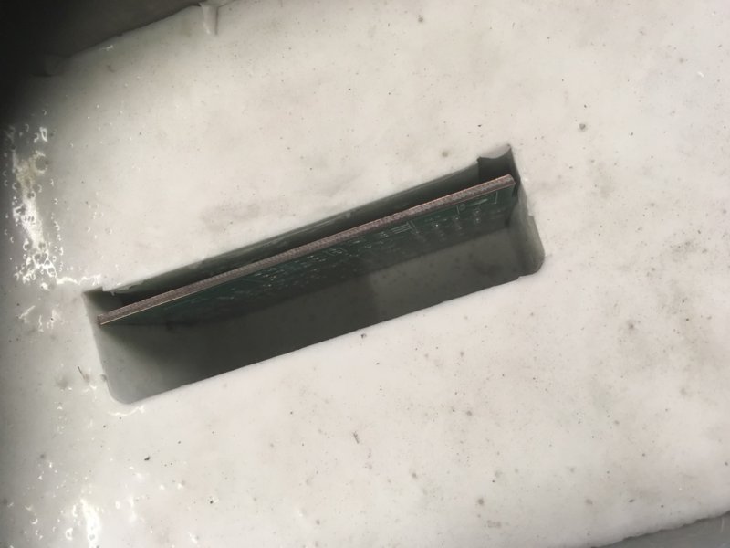

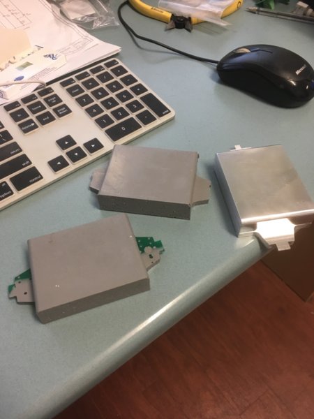

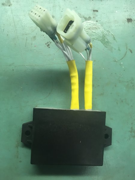

Kyle Communications Posted January 19, 2018 Author Posted January 19, 2018 Well an update on this forum where the ignition modules are. I have made about 50 modules and they are going really well. I have made quite a few changes since the first posts on this. I now have injection molded glass filled nylon boxes. I have settled on the wire sizes after some trial and error and testing. The epoxy I use to fill the boxes we use at work it is 28,000 volts per mm insulation and sets as solid as a rock to hold everything. Some modules out there now have around 80 to 100 hours of operation. The test box that I use is set for 5000 rpm but I want to be able to test the units that I make and also test original modules to see if they have any faults. I can really only check for go no go with the electronic test box version. I can not test from 0 rpm right up through the full range of RPM. Danny and I bought a broken 912ULS for parts and I have used the gearbox mainshaft from it for the Mabel rebuild. I had a brainwave so I have removed the alternator and housing from this engine it has all the original pickup coils and main coils so I am going to simulate a complete working firing system on a genuine Rotax test bed. I have been working on it this past week or two. Jimbo came over last weekend with the special puller so we could get the alternator off the crankshaft and once that was done then I made up a quick frame to mount the unit on. I got some pillowblock bearings with 30mm bearings and have made up a complete drive shaft that emulated the engine crankshaft. The alternator end has a bronze bush in it and a taper that holds the stator on. I turned the shaft up from a 40mm steel bar with the section on it for the taper and the bearing surface for the 32mm housing bush and tapped the 16mm hole in the end which is about 45mm deep...that was a slow exercise by hand. I mounted the pillowblocks and have lined it all up so it spins freely. Once the stator is fitted though its incredible how much harder it is to turn the shaft with the magnets in use. I reckon it drags about 5 to 10hp from the engine it so hard with the magnet pulses. I have used a pedastil drill motor and the pulley from the drill press to drive it all. Not sure if I will have enough torque to drive it though so I may need to use toothed timing belts and pulleys also maybe a larger motor. I will know hopefully when I get it fired up maybe this weekend. The motor does 1420rpm so I need a 4/1 reduction to get the shaft up to normal engine cruise speed. Hopefully it will work. Anyway some pics of the test bed so far...it may well change yet. It will have a digital tacho I will make which monitors the shaft speed also obviously a speed control also maybe some fixed speed positions as I will make a speed controller for the drive motor 2 2

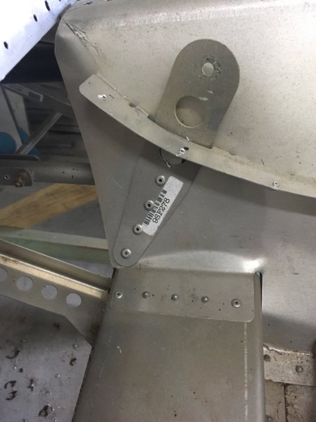

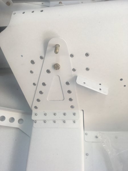

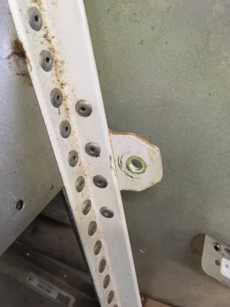

Kyle Communications Posted February 25, 2018 Author Posted February 25, 2018 It has come to my attention thanks to Reg Brost and Danny Leach that a lot of the earlier Savannah kits have some confusion over the seat belt mounts. Danny and I have been talking about it on our rebuilds for a month or so and when I was in NZ I saw IBob's build and noticed a different inner seat belt bracket. So a bit of research and advice from Reg I checked mine this morning and also another XL build at my airfield and both he and I and also Dannys VG and another that called in today for a chat at the hangar were done wrong. This will only apply probably for earlier versions of the manuals. The outer seat belt bracket on the side rail should have bolts at the top and bottom and 2 rivets in the middle. The manual shows the drawing correct BUT it shows the bracket with 4 rivets in it. Mabel and Danny's S rebuild only have 4 rivets and no bolts. Make sure the top and bottom attachment holes have bolts in them. The inner attachments the strap is supposed to be bolted THROUGH the pyramid tunnel side. Mine are not. Again the drawing in both manuals I have is correct but the picture is NOT Hopefully the pictures will tell the story You can see in this picture above the hole at the top...it should have a hole behind it into the tunnel side and the bolt for the attachment should be on the inside of the tunnel. This picture is of Mabel's one and my XL was also done like this...the manual does not make this clear at all. This is the outside one and the top and bottom rivets should actually be bolts NOT rivets Another thing is the seat belts them selves should be crossed over. Meaning that the pilots sealt belt at the tunnel side should be attached to the pax side and visa versa...this makes better sense as the pull direction will be far better when needed. I do not have mine crossed over but will change that as well This is the later style bracket from IBobs build...you can see it is attached to the UC channel and also bolted to the control tunnel...this is much stronger than our original designs...a much better idea 1
Marty_d Posted February 25, 2018 Posted February 25, 2018 The 701 seatbelt mounts have no bolts (I know because I riveted them not long ago!) I know it's a different aircraft, but so much is almost exactly the same. Maybe Savannah started off with only rivets and decided to add a bolt? One addition to the 701 original plan is to add a 0.040" plate behind the pyramid tunnel wall and rivet A5 through the seatbelt mount, wall and plate. This is because they found some mounts pulling off the tunnel wall in crashes.
