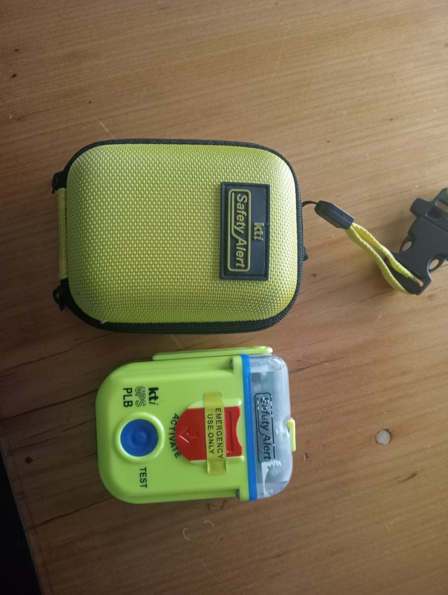

sfGnome Posted 16 hours ago Posted 16 hours ago I had a Kanad, which wouldn’t pass the GPS self test. I returned it for replacement under warranty, and the replacement wouldn’t pass the test either. Given that each test drains the non-replaceable batteries so it can only be done a few times in the device’s life, I couldn’t keep trying so eventually I gave up. Maybe I just had bad luck, but I’ll probably go with the GME next time (very soon). 1
