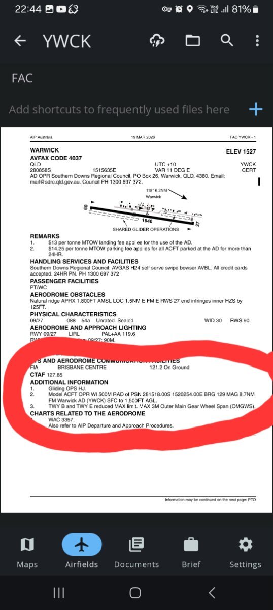

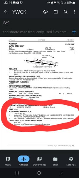

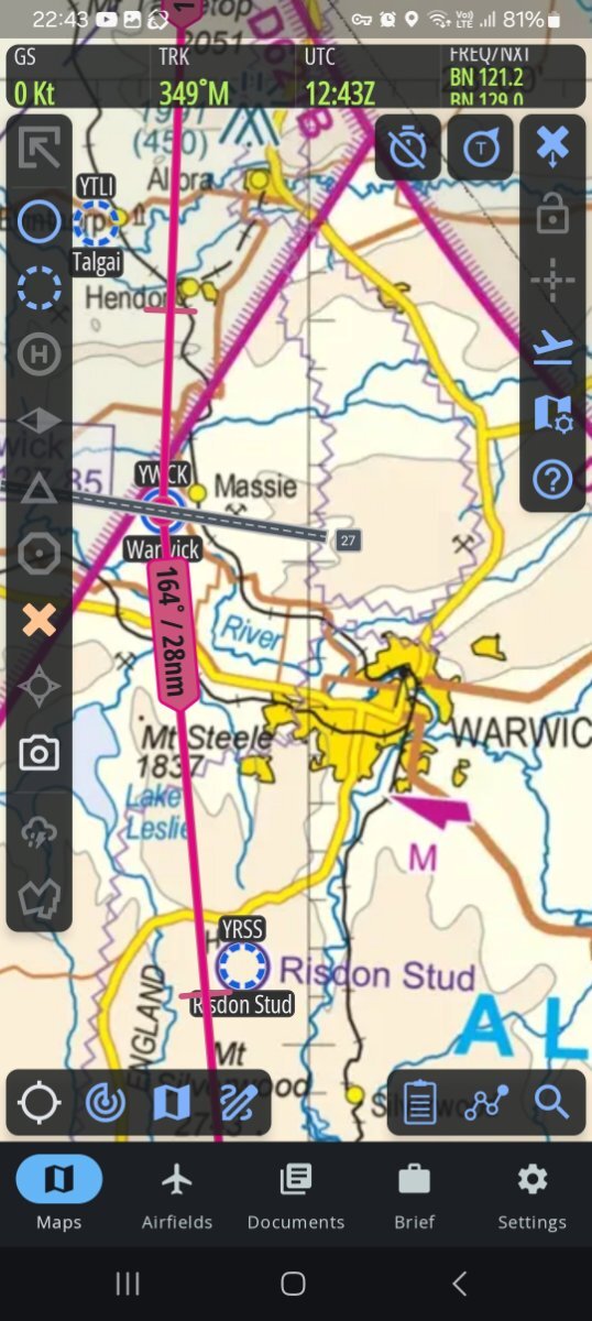

Warwick has one.
20260410_224524.thumb.jpg.9df69e2cf244397122eb9ac1cfd14e29.jpgScreenshot_20260410_224355_RWY.thumb.jpg.2f10535d6a3c025005acad90665256fb.jpg

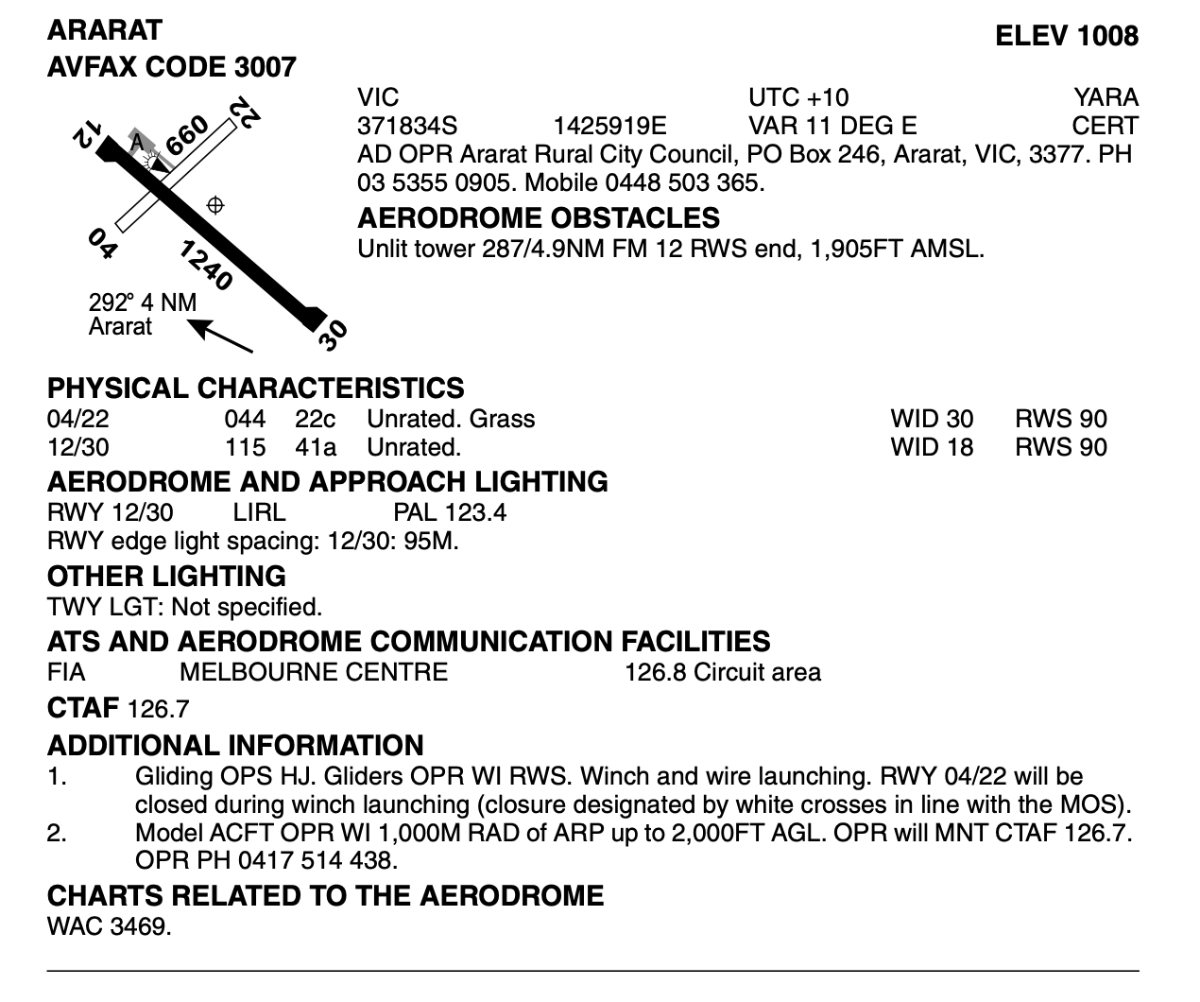

Ararat is one
