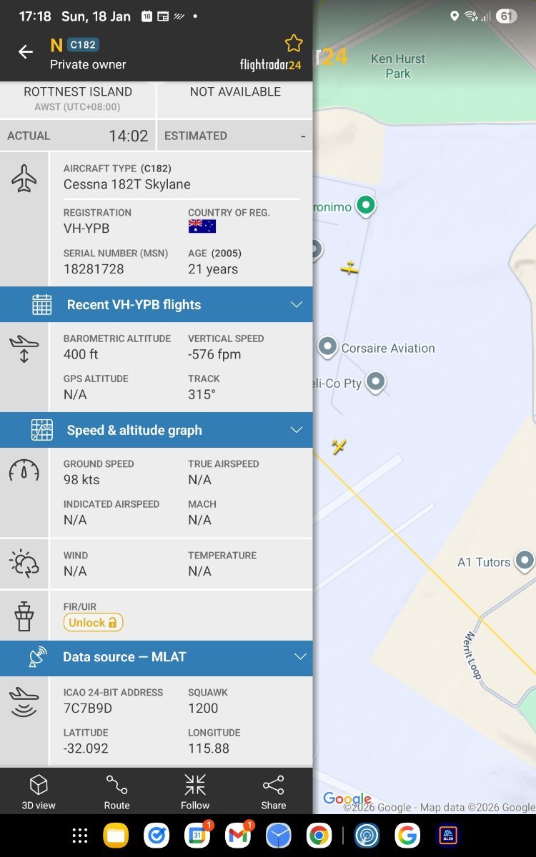

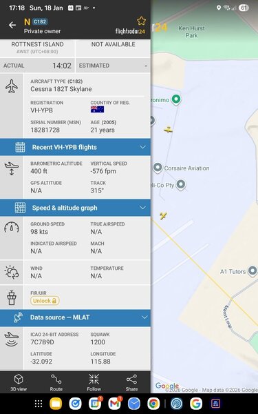

coljones Posted 18 hours ago Posted 18 hours ago An FR24 screenshot - a C182 detected at Jandakot detected using MLAT ie no ADSB Out. 3

Thruster88 Posted 18 hours ago Posted 18 hours ago 15 minutes ago, coljones said: An FR24 screenshot - a C182 detected at Jandakot detected using MLAT ie no ADSB Out. OK so that c182 would have to be mode S or better to be transmitting the data. Have never seen an aircraft with no data showing which would be the case with a mode C or A transponder. 1
