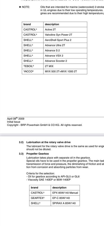

T510 Posted Saturday at 01:08 AM Posted Saturday at 01:08 AM https://legacy.rotaxowner.com/si_tb_info/serviceinfo/si-2st-008.pdf Suitable oils listed in the above document 1 1
jackc Posted Saturday at 01:20 AM Author Posted Saturday at 01:20 AM 9 minutes ago, T510 said: https://legacy.rotaxowner.com/si_tb_info/serviceinfo/si-2st-008.pdf Suitable oils listed in the above document Thanks, the Castrol Oils are easily available. i had picked this as a possible? https://autobarn.com.au/ab/Autobarn-Category/Shop-our-Full-Range-by-Brand-at-Autobarn/Penrite/Penrite-Hi-Per-2-Stroke-Semi-Synthetic-Engine-Oil-2-5L/p/OA00261 1
facthunter Posted Saturday at 05:47 AM Posted Saturday at 05:47 AM Oils in specific countries have varying formula's. Autobarn have a lot of brands but if you say it's for an aeroplane they might clam up. Note the date of the Rotax advice April 2009.. Some of those recommendations may have been superseded . You can call Penrite on the Phone. I've found them very helpful with Lube enquiries. They used to make a product called "Green Slime" But got sued. It required careful mixing. Aero engines operate different to most other applications. They don't get much of a rest. and they are full bore at the beginning. Your biggest worry is carbon build up in the ring grooves and the cold motor fuel washing the oil from the Internals as the fuel is not vapourised. Note also 100 L L is OK and with premix fuel remaining in the carbs will evaporate and leave neat oil which can cause lean running next time. Nev 2 1
