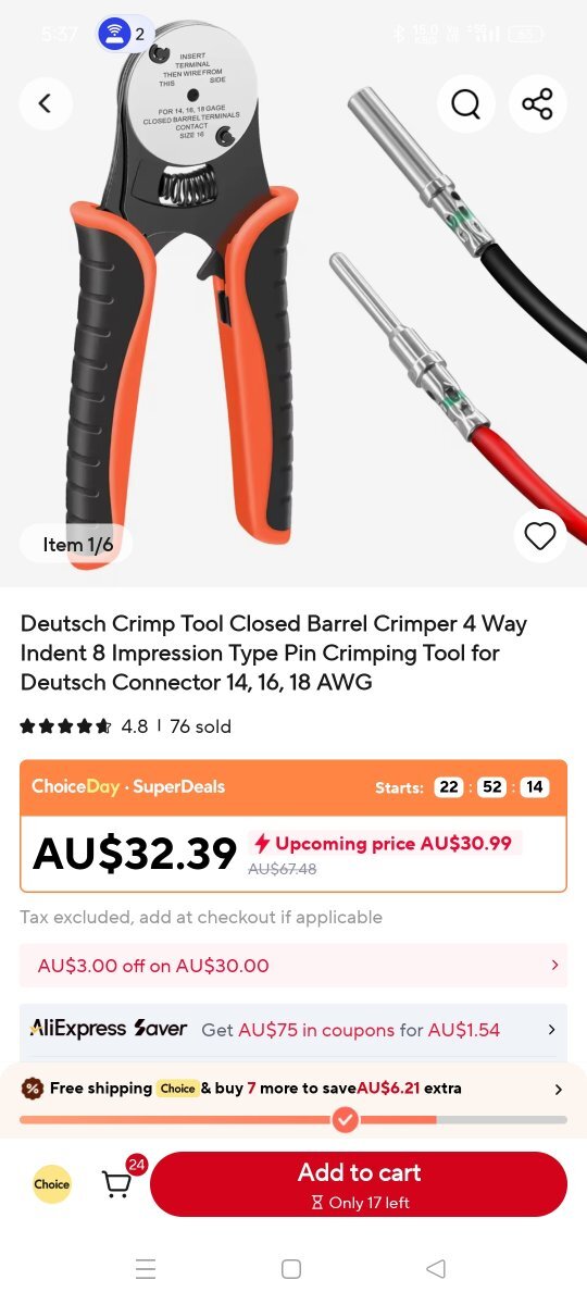

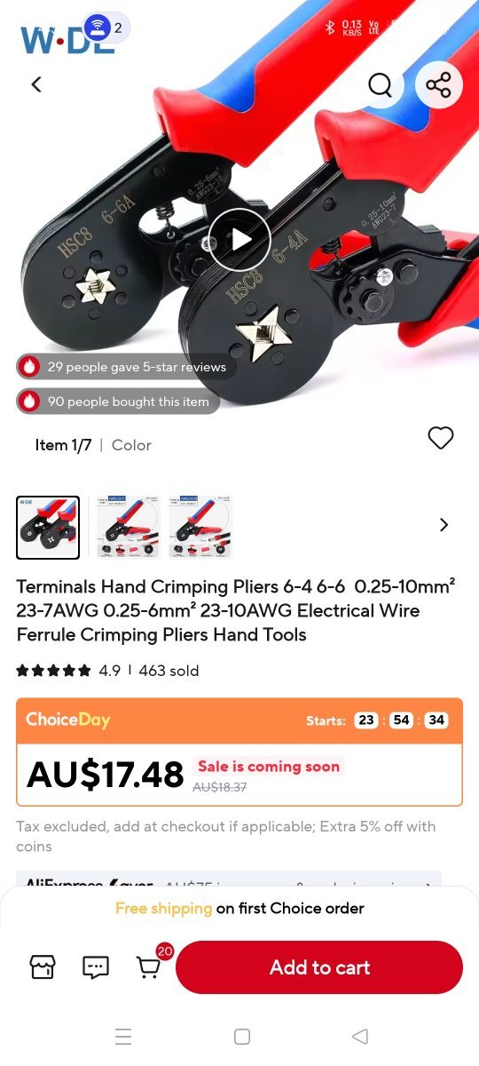

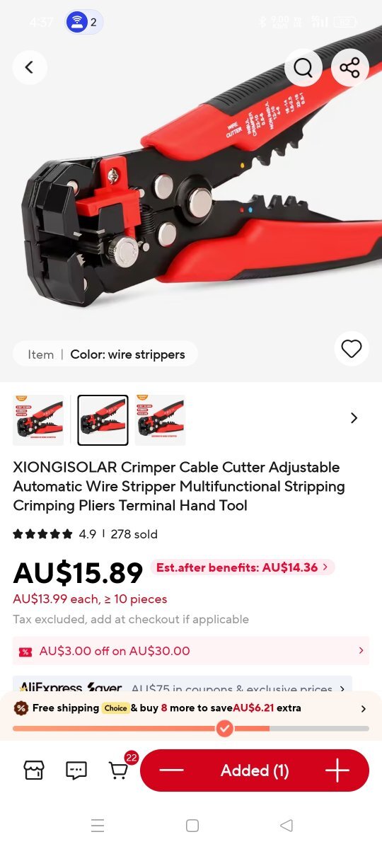

Will these work. One off use, one build only. I need the type for the Garmin pins and wire strippers.
I need to wire a complete plane.
Thoughts
Thanks Lyndon
Strippers look okay (not the crimping part)
Crimpers bit sus! - you will need to be sure that they will suit (crimp correctly) on your pins. Diameter & length of section to be crimped critical for reliable conductivity - don't scrimp on quality crimping.
Screenshot_2025-08-31-17-37-45-72_57e717c094f371a1dada6567a1123b99.thumb.jpg.170e6b59dbde60ca3d603ffe40e1deed.jpgYes, I know zero on these tools. From what I can see $270 is needed for a crimper, so I'm guessing it's too cheap

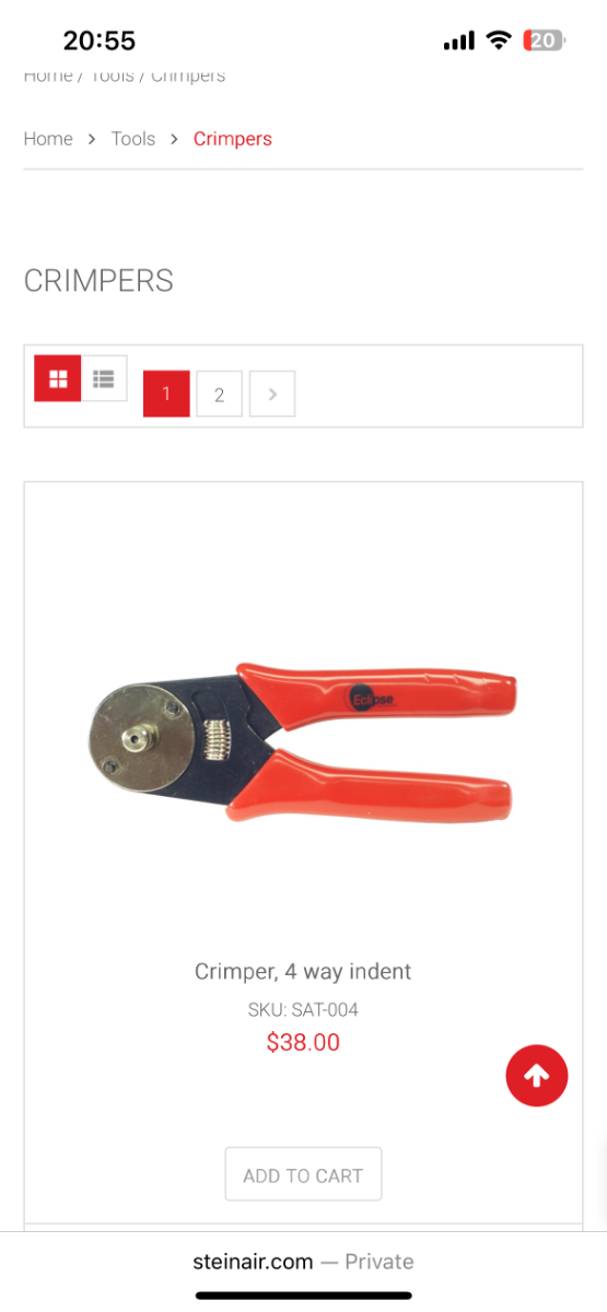

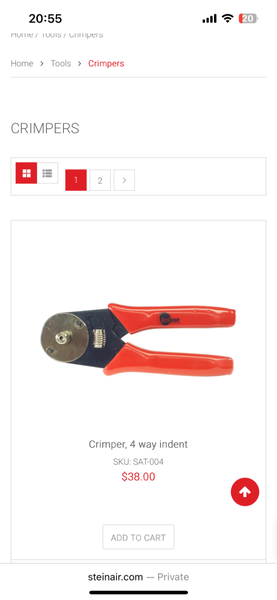

I bought one of these, two removal and insert tools and some extra spare male and female pins.  For my Trig radio and transponder hook up.  Stienair is the USA company good to deal with.

It only 4 way crimps the particular pins and sockets used by trig.  You would have to compare your connectors with this particular crimper.  The Stienair site will show the size it fits or Trig radio install manual lists the mil spec of the connectors.  If same as yours this would be the tool to get, otherwise you can buy new or used 'Dainels' brand tools however expensive.  (You can purchase used 'Daniels' crimpers and dyes that are still crimping to satisfactory specs)
Have a look at their webb site as they are an aviation supply shop.

I have the set at the bottom. Pretty poor quality. They work but not that well.
