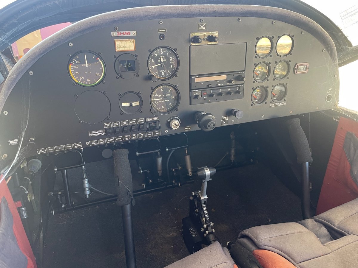

Moneybox Posted August 2, 2025 Posted August 2, 2025 4 hours ago, Love to fly said: Think the issue would be one person business and he has been in the states for Oshkosh. James Fisher did respond on Thursday with quite a long voice mail. He's able to supply a pretty good package including the iLevel AP for autopilot and ADSB-IN and then a Trig transponder for ADSB-OUT. I'm not too sure how they work the government rebate. It's available for both ADSB-IN and ADSB-OUT however I don't know if you can get both, if so then I need to purchase these items separately (two invoices). There's a $5000 limit but is that per invoice/ADSB? I just paid something over $800 for instrument calibration and that would have to be done again. I was counting on filling that spare 90mm hole in the dash however neither one of these comes with and attitude indicator and artificial horizon. I was mistaken in thinking the iLevel came with this. It's the Super ECO autopilot that will work with the iLevel but seems like a double up and another $4000 and not eligible for the rebate.
