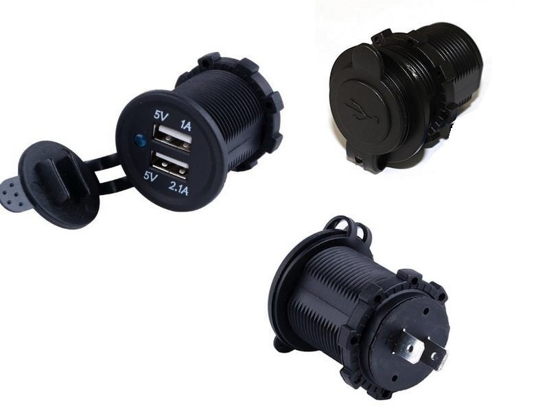

I have a couple of USB panel mount marine chargers. I've had no trouble with them and they seem to do the job. Bought on NZ TradeMe, look like this:
Can't remember exactly Skippy, but mine cost very little. They seem to be offered in various combinations, sometimes with other fittings, in little panels that I guess you bolt on your boat or whatever. I contacted the vendor and bought a panel  with 2 USB units, discarded their panel and fitted them to mine.
Full disclosure: I've never metered or scoped them to ensure they are behaving themselves.
One normally powers my Samsung tablet with Ozrunways, the other my uAvionix Ping for ADSB-In.
