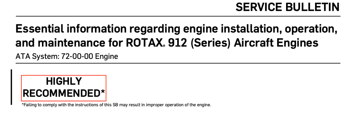

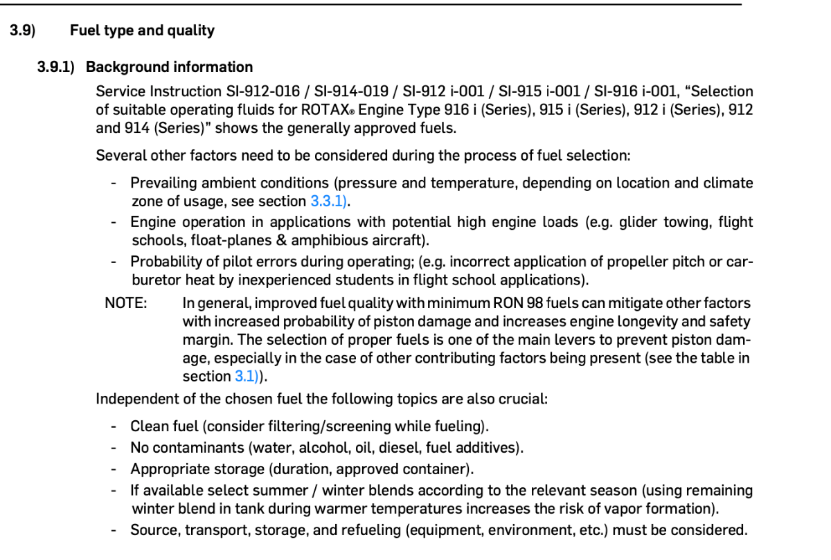

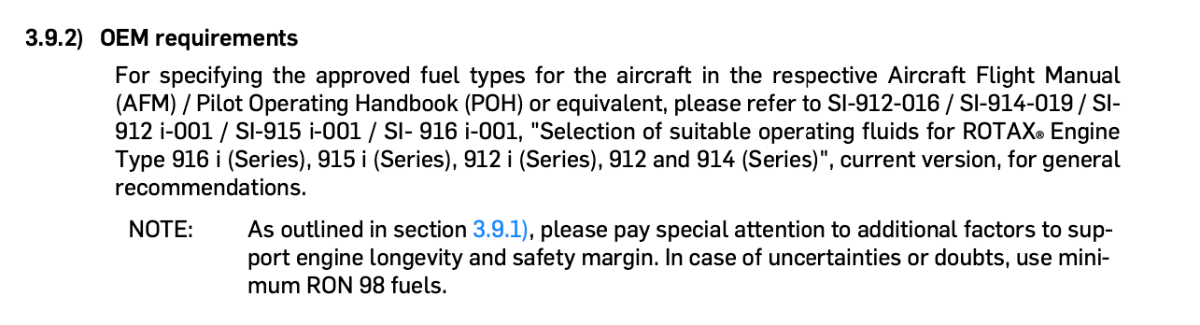

Kyle Communications Posted December 11, 2024 Posted December 11, 2024 The way I read the SB it pretty much says do it or if there is a issue we can say you didnt follow our recommendations. Now for Certified aircraft its a must otherwise Rotax can always give you the bird if you try to make a clain or ATSB said you didnt follow the "recommended" proceedures. We have 95 at our airfield but the club has decided to change our fuel to 98 based on this bulletin
skippydiesel Posted December 11, 2024 Author Posted December 11, 2024 (edited) I have always preferred to use 98 RON however this is so that I am sure that, in the event of fuel mixing/adulteration, I am using no less than 95 RON. 912 80 hp have a lower compression ratio compared with the 100 hp engine - the 80 should be far more "tolerant" of lower RON fuel than the 100 hp. Octane rating is about knock/pre ignition. How you load the engine has a significant part to play in knock generation - high load, greater chance of knock. Aircraft propeller pitch setting and angle /speed of climb are the principal (not only) contributors to knock. Rotax have recently changed their engine speed/MAP recommendations - Used to be that the engine should make no less than 5200 rpm STATIC @ WOT. This very safe simple easy to understand advice has been dropped in favour of https://aquila-aviation.de/wp-content/uploads/2021/06/SL_912_016R2_914_014R2_Rotax_Notes_engine_handling.pdf, a rpm/WOT chart/graph that the pilot/maintainer can select from. The chart shows diffrent results for 95 & 98 RON. The take home message is that 98 RON allows for a greater margin of operation/error than 95 however 95 is still okay to use, provided you operate the engine within the advised parameters. Edited December 12, 2024 by skippydiesel
