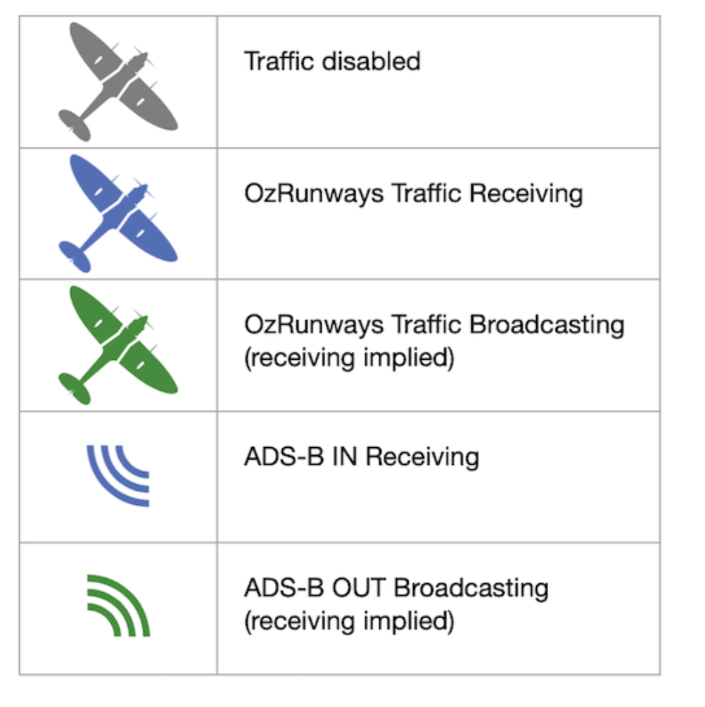

In any case, OzRwys does have an indicator on its main map page (upper right corner) confirming the traffic IN/OUT status
(both of its own [cell-tower based] system and any integrated ADSB device.)
So if you're not seeing the green radio-wave symbol (see pic) together with your ID 1234 and '1200') then you know your SE2 is not transmitting.

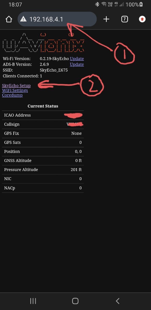

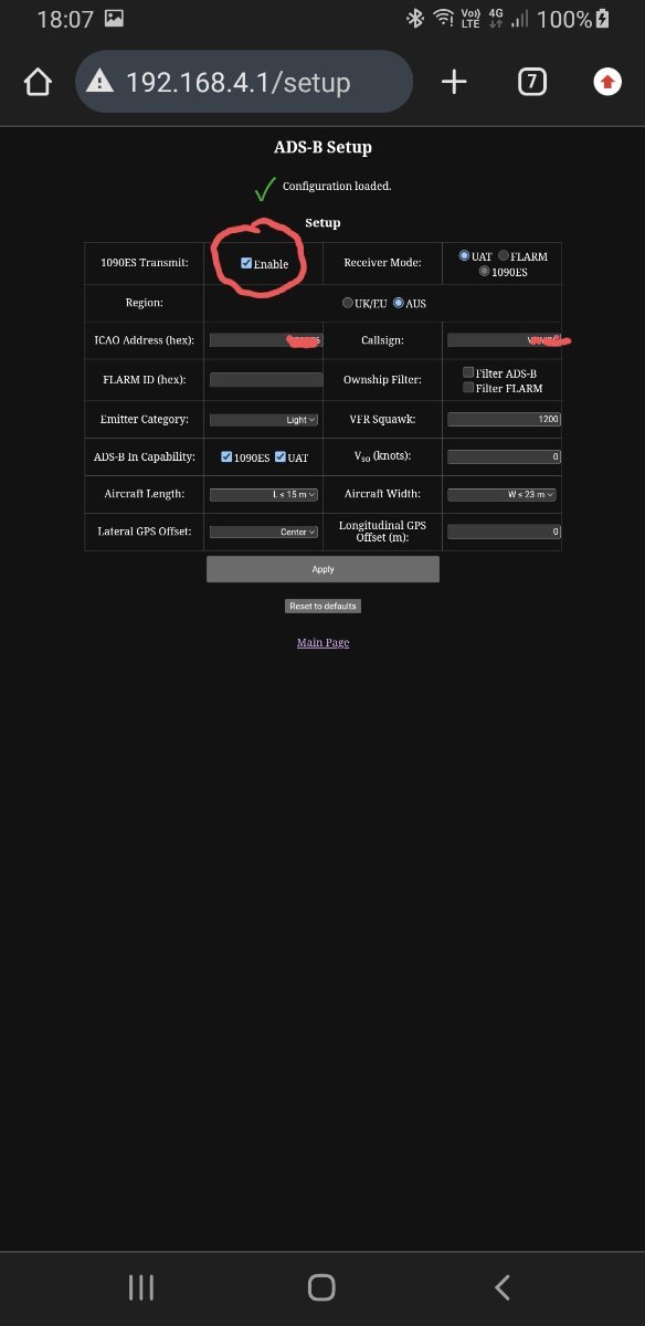

From your phone/tablet/ipad connect to Skyecho wifi.
Once connected, open browser and
1. type ip address 192.168.4.1 (this might be different).
2. Tap SkyEcho Setup
On Setup screen below, confirm 1090ES Transmit is ticked as Enabled. Also confirm other parameters including your rego and hex code.
If not, tick Enable, Apply, Main page, then Setup again to confirm the change is applied.
If ADS-B led is not blinking, then I suggest to contact uavionix support.
Let us know how you go.
