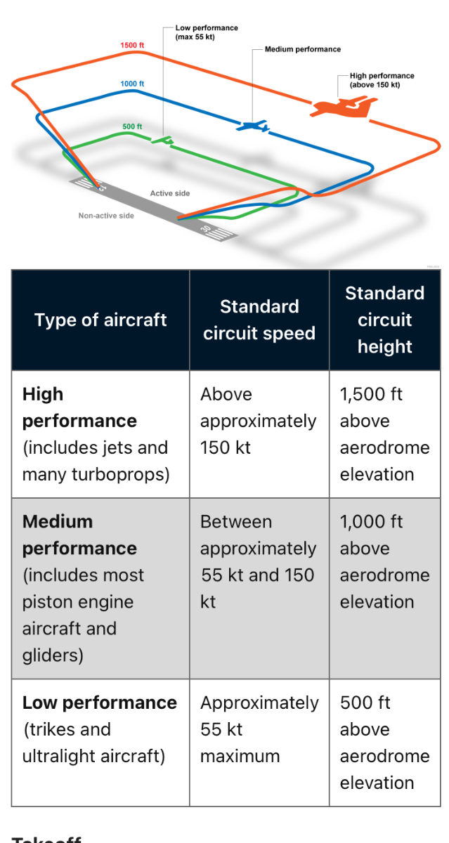

Circuit height varies with aircraft performance, could be 1500’, 1000’ or 500’ AFE.
Edited by Roundsounds
I am aware of the possibility of doing a 500 ft circuit, never have.
I have never encountered a 1500 ft circuit - probably only in a controlled airspace.
The reality is that 1000ft is , for all intents & purposes, the circuit altitude - faster aircraft don't fly higher they fly wider.
I have definitely encountered turboprop aircraft flying 1500' circuits. The occasional jet also visits, but I haven't been in the air at the time. I suspect they fly a straight in approach usually.
We have all 3 heights flown at our aerodrome, twins & turbos 1500, singles 1000 & gyros/trikes 500.
Faster heavier aircraft fly wider circuits but lighter aircraft flying the same or similar speeds can fly much tighter circuits. This is where good visual contact and clear concise radio calls are essential as the one flying a tighter circuit could end up in conflict with the one flying the wider circuit.
