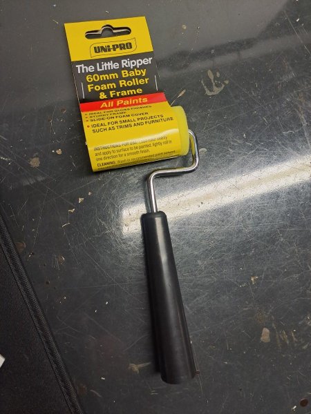

I must have missed the parts with the rollers. Do you just use normal paint rollers? That was my plan...
Nononono!
There is a narrow roller where you load the paint in the handle and it has a cap to prevent drying out.
Ping Mark here at Kyle Communications, he'll be able to tell you what they are called and where to get them.
Personal message is the little envelope on the left of the screen. Click that and write your msg.
Send it to Kyle Communications.
You really need something that rolls on a very narrow strip, or you'll end up with it over whole areas where it's not required, and your can of black stuff will go nowhere. Also that roller will take a whole load of wetting, using still more black stuff. And will dry out, requiring a new roller and yet more black stuff.
