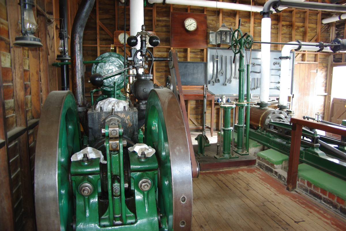

Ingersoll Rand made their reputation with the Class AA2 steam powered compressor, on the left. My friend Jim was the Australian manager many years ago and paid for this machine to be restored.

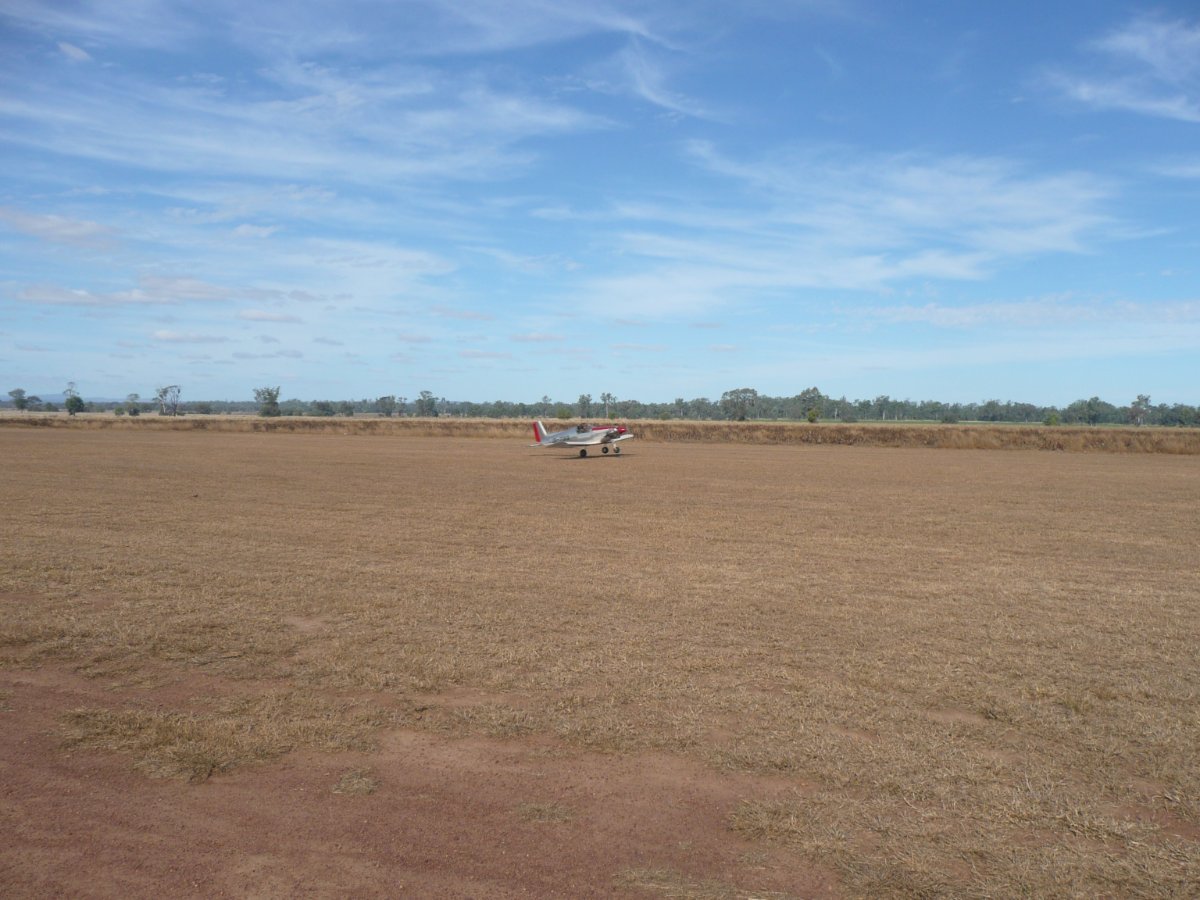

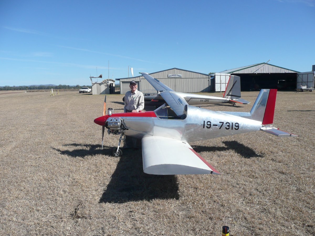

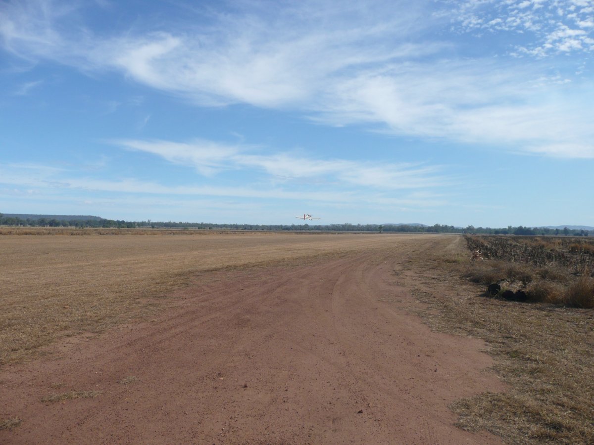

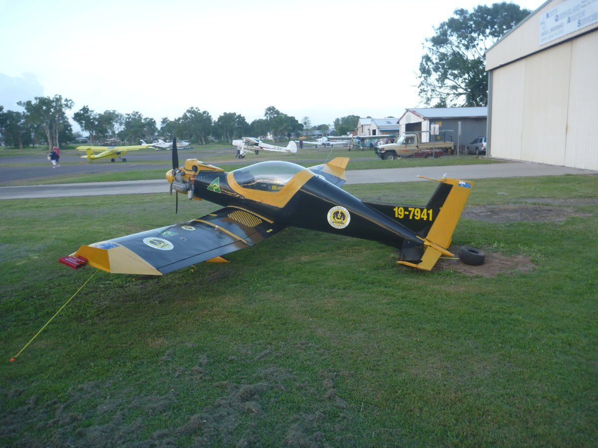

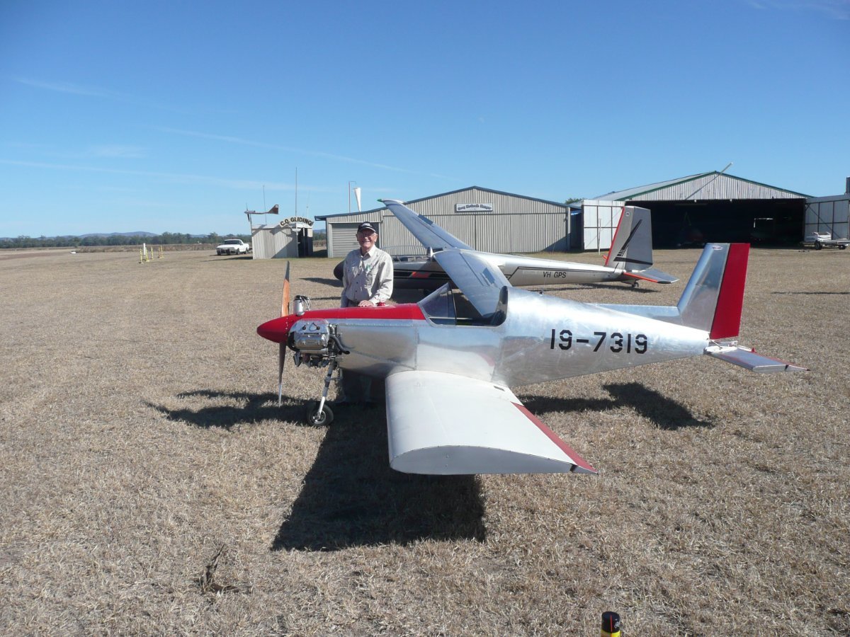

I came across these images tonight.  The alloy and red one is the Teenie Two Bob built and its first flight at McMaster Field west of Rockhampton (my glider back then is in the background); it was the second he built the first he made in Canada.  The other if its a Teenie was at Ingham, Qld.
RAA search shows Bob 19-7319 is still in current rego so must be flying somewhere.
