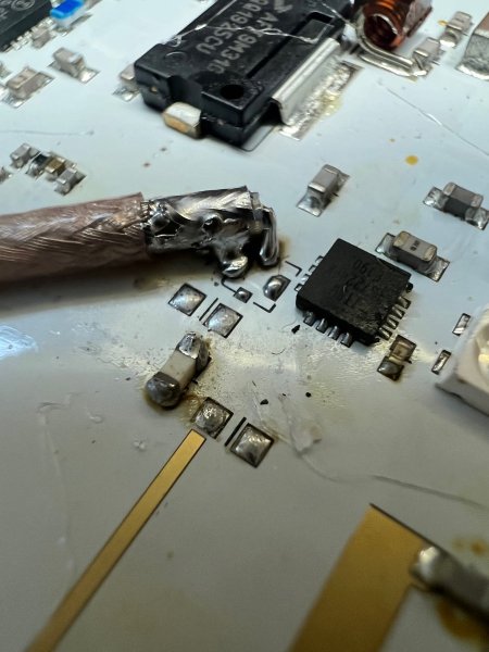

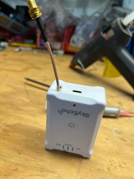

Best option is a UHF grade solder joint for the ADSB RF. But that isnt anywhere near as critical as the GPS
BUT that doesnt fix the GPS ! GPS really needs external antenna OR needs to be mounted where it has a good view of the sky. (front of instrument panel under windshield etc)
