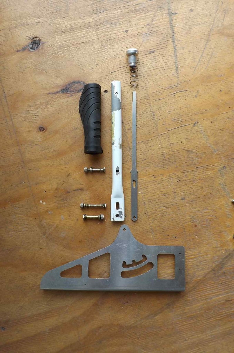

IBob Posted May 30 Posted May 30 Hi Mark, I'm pretty sure that ICP made a similar adjustment to the stick pivot point. I think the problem emerged with the adjustable seats, not only can we sit further forward, but we are now sitting higher. My kit was dated Dec 2014. Here is a pic of my ICP handle, and beside it the ICP bracket that came with my kit. And the full flap position appears to have their stick vertical. 3
