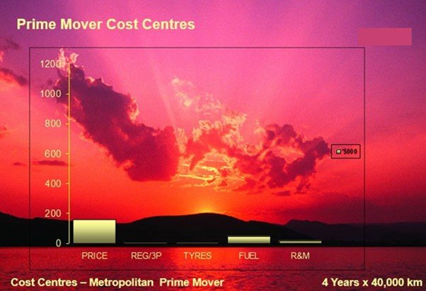

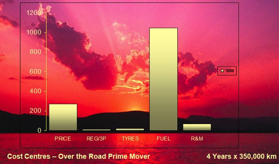

turboplanner Posted November 15, 2022 Posted November 15, 2022 2 hours ago, turboplanner said: The graphic I did there was total cost of life. For batteries some items come out, fuel comes out, engine maintenance comes out, air cleaners, exhaust come out. Etc then the electric items go in. A new schedule goes in etc and the bars change. So both ICE and EV are costed separately based on the way they operate and perform. This is the same vehicle as the earlier graphic, but here around the city the Annual distance is much lower and a lot of the time the truck is operating under 80 km/hr, so there's no exponential power demand to push the wind out of the way. Comparing this to an electric equivalent, the missing airpower demand will leave a lot more charge in the batteries, but the battery pack changeover cost will add a lot to operating costs because there's very little fuel cost to offset it.
