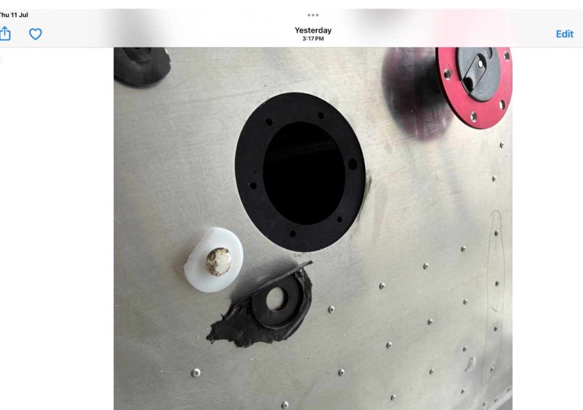

Kyle Communications Posted July 10, 2024 Posted July 10, 2024 Just machine up a plug from alu and machine in a Oring in the front flat surface ND A ORING IN THE REAR THREADED NUT WITH WASHER FACE FOR THE INSIDE. THEN IT WONT LEAK WHEN FITTED AND NO NEED TO PROSEAL. MAKE SURE BOTH ORINGS ARE VITON AND FITTED CORRECTLY INTO THIER SLOTS..opps not retyping sorry about the caps

Mike Gearon Posted July 11, 2024 Author Posted July 11, 2024 1 hour ago, Kyle Communications said: Just machine up a plug from alu and machine in a Oring in the front flat surface ND A ORING IN THE REAR THREADED NUT WITH WASHER FACE FOR THE INSIDE. THEN IT WONT LEAK WHEN FITTED AND NO NEED TO PROSEAL. MAKE SURE BOTH ORINGS ARE VITON AND FITTED CORRECTLY INTO THIER SLOTS..opps not retyping sorry about the caps Aluminum a good idea! There are also threaded fitting blanks available with a thin face. The problem is any thickness on leading edge side pushes the tank back away from the fuel tank holes I’d drilled. Especially combination of the blank face and the Viton washer. I could remove a little material from the leading edge extrusion. It’s near root and I just don’t feel good about weakening a spot.

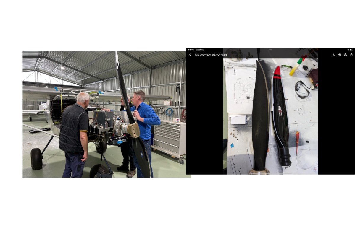

Mike Gearon Posted August 21, 2024 Author Posted August 21, 2024 Update. Aircraft 1 See pic. We had the UL agent out with a really switched on guy. Jason. Jason really knows his way around electrical. Nic and Jason have a similar background in electronics. Between Nic and Jason they managed to solve a few glitches. Well worth the visit. The UL520t is running. Sounds fantastic. We have the Titan Whirlwind prop on for now and have limited running to some 15 minutes. Can’t run it much more until we can get it up to operating speed. The old dilemma of wanting to do ground testing and needing it in the air WOT to prevent glazing. Might tie the bastard down and run WOT once cowling is done or we run some temporary top on the engine to get air to the rear cylinders that will run hot without air directed downward is my thinking. Prop has been a huge drama. We had a prop from Sensenich that looked tiny in comparison to the Whirlwind. We’d ordered and received this a year ago. See pic and you’ll understand why we’ve been reluctant to put the Sensenich on. I talked with Don from Sensenich just this morning and had a great download on props. Turns out big isn’t better. Big props for STOL and smaller props for cruise. Also, the pitch distribution along the blade plays an important part. We decided to return the prop to Sensenich and have on order a Sensenich carbon forged 3 blade 79.5” that’s suitable for Lycoming 360 up to 220hp 2800rpm. That’s our sweet spot with the 220hp turbo normalised max 2700rpm and we suspect the 220hp is above actual available hp when you crunch the numbers on engine size. So, in 3 weeks time we should have a great prop and time to get the cowling sorted. 3

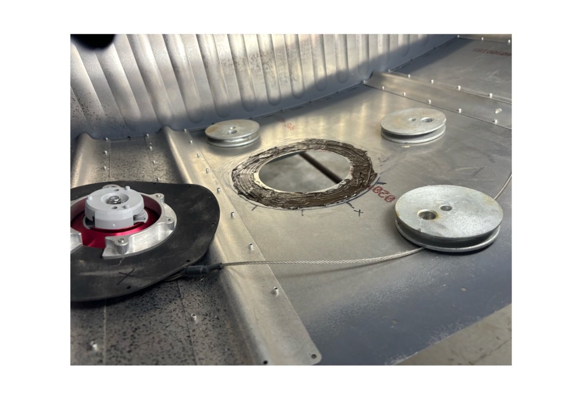

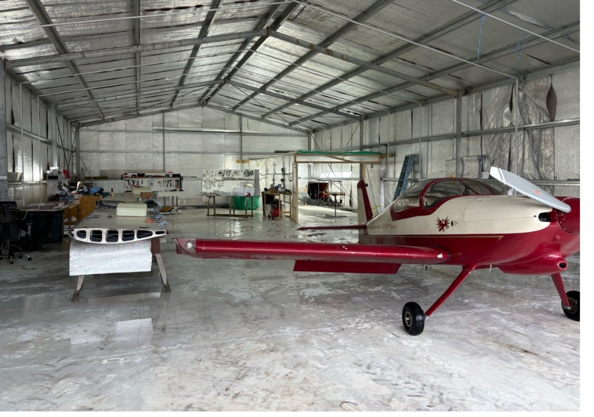

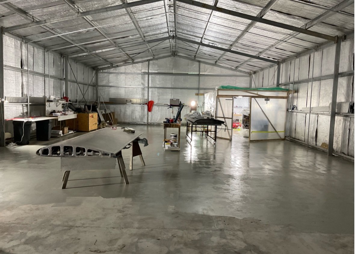

Mike Gearon Posted August 21, 2024 Author Posted August 21, 2024 (edited) Aircraft 2. i have replacement fuel tanks. Started work on these sort of…… Last year the aircraft was moving forward fast. This year I’m yet to commit to the build again. Every week so far it’s the week where I get the fuel tanks finished, tested and installed then paint the fuselage that’s sitting in a rotisserie, paint the wings and other parts. Get the wheels on then the wings and get really enthusiastic. I’ll put pictures up when that happens. At the moment huge effort has gone into wind turbines. Pic here in China last week visiting a supplier. I’ll have the generator shipping to my Taiwan factory where patent applied items are being fabricated. It’ll then come to French island for testing before early production runs. Not time consuming now but patents and CAD work have been huge time consumers. At least the wind turbine has aerofoils. It’s sort of aircraft related The VAWT (Vertical Axis Wind Turbine) pictured is interesting. It’s 3kw but the reality is it’s half the efficiency of HAWT’s. (Horizontal axis…. ) The VAWT are IMO beautiful and they are low maintenance so some will be built. The company is named… WWW.IN2WIND.COM I liked WINDY but on advice from trademark attorney there are too many conflicts so it’s IN2WIND. I was third largest supplier of rowing machines in the world with a company started when I was 42. We will see if at 66 there’s the energy to make it happen again. Maybe and I don’t have a divorce or need to put children through private school education so no pressure or self induced pressure I guess. Maybe if I don’t blog about it would be less pressure? Also AEROBATICS. This has dominated my time with ground and air the last month. I think it can be done quite quickly or thoroughly. I’m doing the David Pilkington course out of Moorabbin. OZAEROS. It’s thorough! Ground completed today and total 8- 10 ground hours. Probably took longer because I ask lots of questions. Next flight is recovery from unusual attitudes. Being upside down and chosing the correct course of action to recover is bloody difficult. Lots of chair flying going to be happening. Hammerheads are my favorite thing. Loops not so much. Stomach doesn’t enjoy them. At least I’ll be able to do a few barrel rolls and wing overs in the S21. Not quite sure exactly how aerobatic it is. The Decathalon is +6g and -5g. The S21 is plus 6g and -2g. I’ll find out more before attempting maneuveres that rip the wings off in negative g’s. The David Pilkington course heavily emphasizes the POH and AFM of your aircraft as opposed to the Decathalon setting the rules. Wife home from Nebraska next week with Rans parts and RV parts in her suitcase so I’m looking forward to her return. Edited August 21, 2024 by Mike Gearon I’d written David Pinkerton. If he ever reads this he won’t be annoyed now. Pilkington! 4 1
RFguy Posted August 21, 2024 Posted August 21, 2024 (edited) Hi Mike, nice writeup. Carbon forged ? what is carbon forged ? Be careful of ground running. You need more than air directed down at the fins, you need air forced through them. Given ANY opportunity to go around the fins, air will. (WHich is why Jabiru head cooling is so bollocks) . Needs full baffles. be sure to have CHT probes hooked up before running... and keep ur eyes on them ! Edited August 21, 2024 by RFguy 1
Mike Gearon Posted August 21, 2024 Author Posted August 21, 2024 11 hours ago, RFguy said: Hi Mike, nice writeup. Carbon forged ? what is carbon forged ? Be careful of ground running. You need more than air directed down at the fins, you need air forced through them. Given ANY opportunity to go around the fins, air will. (WHich is why Jabiru head cooling is so bollocks) . Needs full baffles. be sure to have CHT probes hooked up before running... and keep ur eyes on them ! Yeah, carbon forged sounds interesting! It was a spell correct from fibre that I missed. Temps. Yes, limited ground running was shut down as the rear cylinders heated up. CHT on all cylinders. I think we may cobble together something to direct the air downward or be more patient and wait on finishing up the engine cowls.
facthunter Posted August 22, 2024 Posted August 22, 2024 Some of the cowls have actual seals which must fit perfectly to work properly . A few minutes is all i'd run one uncowled and at high power NO.. . Nev 1
