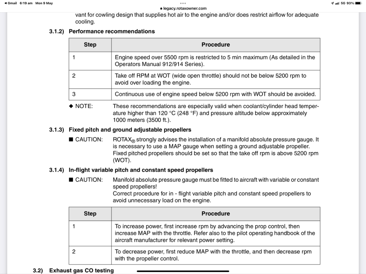

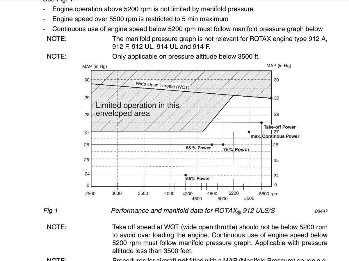

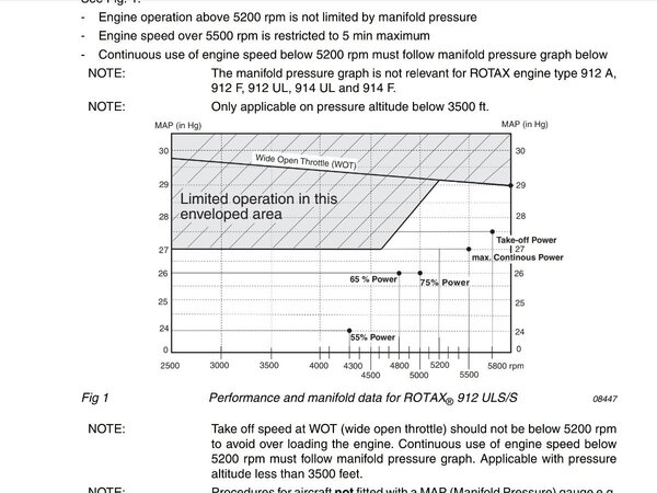

Rotax bulletin.
https://legacy.rotaxowner.com/si_tb_info/serviceletter/sl-912-016.pdf
Rotax bulletin 3.1.2 No WOT continuous below 5200 RPM and that’s what your ear/ feel is telling you when it labours down at 5000rpm WOT
I was trying some 5000 RPM low MAP with consideration to fuel economy yesterday. Had my own personal runway rain cloud for landing so didn’t get a lot of time to play around. Pics yesterday below. Flying to commute so have to cop cross winds and rain within reason.
Seems to be fairly dramatic drop in fuel consumption. 130kn 5400 rpm 27 map is some 22lph. Dropping map back to 20 and 110kn around 12 lph… I’ll test this more. Seems too big a drop in lph. 390nm trip and get there in 3 hours/ 66l or 390nm trip in approx 3 1/2 hours for 36l and save some 60-70 dollars or stretch a trip to avoid a refuel and get there at the same time with less dollars spent. Maybe…
This provides a reason to run 5000RPM range lower MAP. However, is it easier on the engine based on Rotax 2000 hour tests? Don’t know.

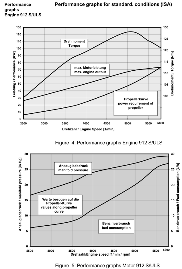

I am surprised of the comment that '5400 burns more fuel (implying less efficiency) , because the fuel usage per kW is still fairly linear in that region.
Edited by RFguy
That’s good info. I guess it’s also a matter of experimenting with settings. I know when I chase my buddy who can run 140-145kn cruise (Blackshape retractable csu 912). and I’m maxed at 130-135kn 5400rpm (virus 912 csu) I’m using a load of fuel. Say 23-24 lph. I don’t want to slow him down too much so cop it.
Mike, There is a slight increase in the slope  in fuel consumption in that region  , and a slight reduction in the slope of the engine output.
two possibilities that come to mind :
1) If at WOT , or close, maybe that is the rich jet coming on ?
2) higher gas velocities are leading to higher fluid (the mixture) flow losses beyond the maximum torque point.
I think the best place to CRUISE the rotax is where the engine output curve slope reduces just slightly, at the point of maximum torque- about 5100-5150 RPM.
