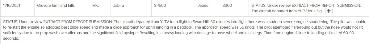

SGM Posted October 29, 2021 Posted October 29, 2021 (edited) Could it be this? Edited October 29, 2021 by SGM typo 1
440032 Posted October 29, 2021 Posted October 29, 2021 Don't you hate it when you can't raise the nose because of inadequate ailerons? 6
Mriya Posted October 29, 2021 Author Posted October 29, 2021 That's the one. Knew someone would have the answer.
facthunter Posted October 29, 2021 Posted October 29, 2021 (edited) I noticed the extent of the upslope after examining the picture in detail. He?(she) would need about 15 extra knots to flare onto that as best guess.. deadstick, if the attempt was upslope. No one ever gets a chance to practice one of these, unless you fly in New Guinea and you need full power to continue up the hill.. Nev Edited October 29, 2021 by facthunter 1 1

pmccarthy Posted October 30, 2021 Posted October 30, 2021 On 30/10/2021 at 9:11 AM, APenNameAndThatA said: I'm a rude as the next person, but mocking someone because they crash landed on an upslope is next level. Airstrips are on flat ground. The forced landing wasn't on flat ground. Stop being an ()edited). Their airplane is wrecked. You have no way of knowing that the pilot does not read these forums, or won't in the future. I think the laugh was on the reporter who said ailerons instead of elevators. 2 3
turboplanner Posted October 30, 2021 Posted October 30, 2021 2 minutes ago, pmccarthy said: I think the laugh was on the reporter who said ailerons instead of elevators. It looks more formal than a local news item; looks more like a formal accident/incident report to me.
Thruster88 Posted October 30, 2021 Posted October 30, 2021 It was written by the pilot or someone at RAAus head office, either way not a good look.
APenNameAndThatA Posted October 30, 2021 Posted October 30, 2021 (edited) 10 hours ago, pmccarthy said: I think the laugh was on the reporter who said ailerons instead of elevators. OOPS. Apollogies to 440032. Looks like I really am rude as the next person. Thank you for pointing that out. Too late to delete or edit my post. Edited October 30, 2021 by APenNameAndThatA 1
kgwilson Posted October 30, 2021 Posted October 30, 2021 You can land a hang glider in a "fly on the wall" full flare on a pretty steep upslope but not a conventional aircraft unless you have had lots of training and experience as AG pilots in NZ have on steep hill country strips. The report description was not expressed well but the message was there. The pilot would have had to approach at 70 knots or more & flare hard to follow the rising ground as the speed bled off & even then if the ground was ribbed and rough as may have been the case the result may have been similar anyway. In this case the pilot did as good a job as anyone without experience would have. Not only that he/she walked away. That is a definition of a good landing. It would have been a great landing if the aircraft could have been used again. 2 1
facthunter Posted October 31, 2021 Posted October 31, 2021 A significant upslope will produce a short landing roll or cancel out your faster approach speed rapidly after touchdown. The faster speed is needed for the abrupt flare to work. IF you stall into rising ground you are worse off. Under the circumstances THAT outcome was a good one.. It's impossible to train for this but it would be a good idea to run all the problems and issues such landings pose as part of training syllabus's.. An upslope may be your only option. You can train for downhill situations and in many of them you can't land as the plane will just continue gliding in ground effect. Nev 2
