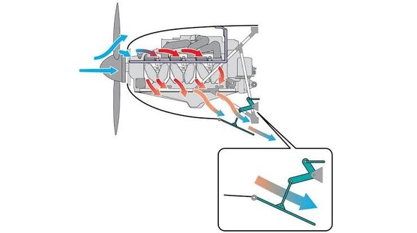

Thruster88 Posted August 15, 2021 Posted August 15, 2021 (edited) Cowl flap like most six cylinder aircraft. https://www.aopa.org/news-and-media/all-news/2017/november/flight-training-magazine/how-it-works-cowl-flaps Edited August 15, 2021 by Thruster88 1
RFguy Posted August 15, 2021 Author Posted August 15, 2021 (edited) not much improvement for this setup Stuart, the Jabiru head shapes, fin design, has too many spurious paths and the air wont go down the fins because the high pressure drops through the fins mean the air will get out any other way it can- the Jabiru heads, unlike the Lycoming heads, have lots of fins on top ! they really needed to have bigger gaps between the pots and have wide finning on the sides of the cylinders, like the lyco, and then there would be the only-path choice for the esacping airflow....... so without judious applications of extra seals, baffles, blanking plates you name it, it just isnt sufficient because the system really relies on forcing air through the top fins . the side fins, one ONE side of the head are the only heat removal path. ... and there are HUGE gaps for air to go around the high pressure drop path. which is why Jabiru plenums have those deflectors on the top, the airflow is deflected into the middle of the top of the head fin section.... The heads are built to be economical - economical materials and method of manufacture. ...That's how they can afford to make a nice engine for that money. - which is fine, as long as people remember, they dont have the capability to handle the temperatures that a Lycoming can deal with all day. IE 180C all day in the Lyco is no big deal compared to 180C (on top = 195+ underneath ) in the jabs where you get head recession, valve seat trouble, cooked valves- the lyco doesnt have any of those issues as much because the build is quite robust at those temps for extended periods. Edited August 15, 2021 by RFguy 1
