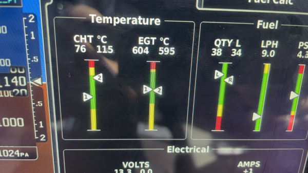

BirdDog Posted May 16, 2021 Posted May 16, 2021 Hi all, I have a Rotax 912ULS with just over 400 hours on it and I noticed something today that I have not noticed before. (this was on the ground at around 2300 RPM, after just landing from an hour of flying) The right side CHT would creep up to just below the Yellow Zone (see attached pic) about 117 degrees C. It would sit there for a 20 seconds, and then it would drop back to down to be equal with the other one. The EGT are all stable etc, so has me beat. Thoughts?
skippydiesel Posted May 16, 2021 Posted May 16, 2021 Faulty sensor??? Faulty wiring/connector??? We all tend to treat our various engine condition read outs as accurate - at best the automotive type sensors & gauges (if steam) are indicators ie not precise. Faults at both the sensor end and head (gauge) end, are very common. 1

pluessy Posted May 17, 2021 Posted May 17, 2021 My Tecnam has a very small overflow bottle (200ml) and I get a 10-15mm level difference between summer and winter (engine at ambient, temp around 20deg different). Very important to know your cold (ambient) level. Older 912s don't have the "window" so if in doubt, you need to remove the radiator cap to ensure the coolant level is at the neck. The fluctuating gauge reading could indicate an air lock/bubble, faulty wiring or sensors usually result in fast movements of the gauge. Being an EMS, that will depend on the dampening factors. 1
