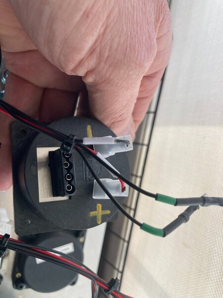

1)  The first pic is the backside of the airbox and outside air temp guage.  Can someone tell me to which points the two signal wires attach?

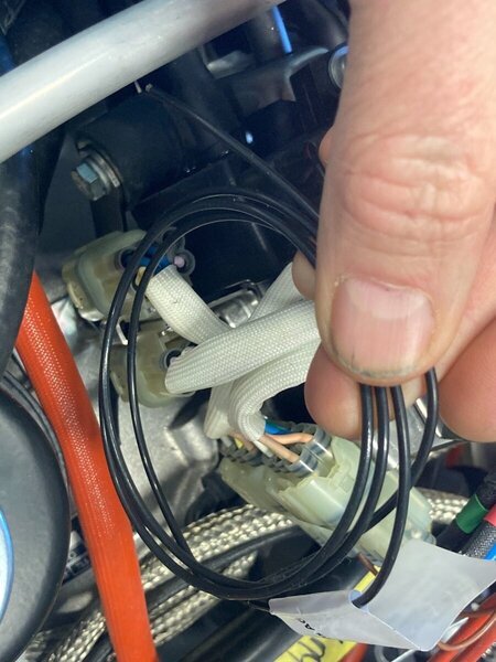

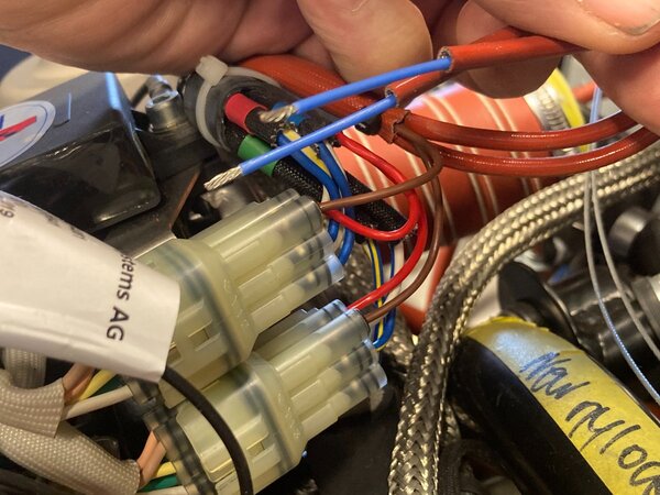

2&3)  The second pic is the wiring near the ECU.  I think I have the brown wires correct?  and, where do the two blue wire go?
4)  There is a black wire coiled up near the ECU.  Where does it go?

1. Airbox/air temp gauge. Each sensor has 2 wires. Attach the pair for one sensor in the LH pair of sockets, the other sensor in the RH pair of sockets. Your gauge has a switch on the front, to switch beteen sensors, right? So you then need to power up the gauge with 12v, warm one of the sensors and figure out which way the switch is so that you can mark it. I have mine so when the switch is left, it is airbox, when it is right it is outside air. This makes sense to me as my outside air sensor is tucked up in the RH wing root/windscreen join.
2,3 and 4. Those two blue wires come from the starter solenoid. Originally, they would have been plugged into the the two ignition modules to provide soft start (timed ignition retard).
BUT Rotax now supply the engine with an 'Easy start unlock cable', which is your coiled black cable there.
All you need to do is connect either of those blue cables to the black cable, and that's it, you will have soft start. (I connected both blue cables to the black, just to tidy things up.)
Here is the applicable service instruction: https://teveso.cz/content/m_dokumentace/SI-912-028_Advanced_Start_System_for_ROTAX_Engine_Type_912_Series.pdf
See item 3.1.1 "The single wire of this harness (see fig. 1) must be connected to the momentary 12V start power signal at the starter solenoid........"

1. The airbox/air temp sensors are just resistors that vary in value depending on temperature. So there is no right or wrong polarity for them.
What I have noticed with my airbox temp probe is that it is quite slow to respond when I turn on carb (air) heat. Provided the exhaust is hot, the carb (air) heat will be almost immediate, but the airbox and the sensor take a while to heat up, giving the impression that the carb (air) heat is slow acting.

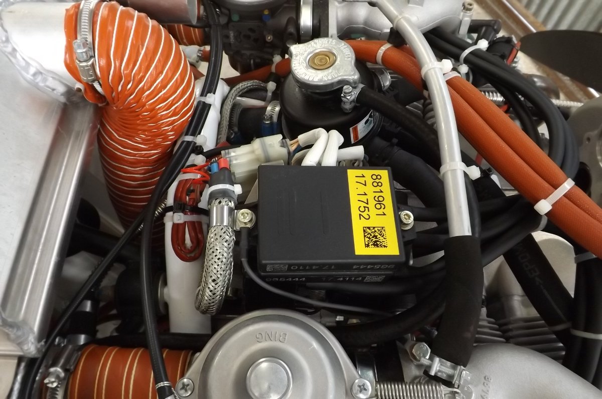

2, 3 &4. Attached is pic of my ignition wiring. The 2 blue wires attached to the engine black wire are the ones you can see cable tied to the white upper engine mount tube.

Many thermistors have slow response times, lag times between 15 seconds and a few minutes. A semiconductor junction is faster than a resistor and I'd be surprised if the sensors are in fact 'straight resistors'. The smaller the mass of the sensor the faster the response (all other stuff being equal). Lot's of info on google...
Hi Jabiru7252. Yes, that was poorly worded: I was mainly trying to convey the idea that polarity is not an issue.
And I would be confident the lag time in the carb (air) heat sensor is due to the thermal mass of the sensor: it is potted into a small bolt, which is then screwed into an aluminium socket in the airbox. The rise in air temperature is not great, it will necessarily take time to raise the temperature of all this.

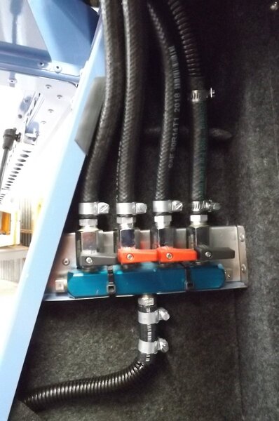

Thanks guys!  Kyle Communications, what size cables are you using in your Sav?  Also, I'm getting to where I'm going to plumb the fuel header tanks, and I like your 4 valve setup.  Was that a 1/4" npt block you used?  With 1/4" stubby ball valves?  I looked through the other posts and couldn't seem to find the size.  The Sav kit does a great job of switching between metric and sae (kind of like our John Deere farm equipment!
Hi again Bodie. I copied Mark's 4 valve setup, which works very well for me. The block we use in NZ, and in Australia where Mark is, is a 14"BSP air manifold, with ball valves. You will have some local equivalent.
If I were building again, I would also run the return line to that manifold (rather than to the RH inner tank). It's no biggy, but it would be one less penetration/fitting in that tank. And it would remove the possibility of fuel loss if flying with that tank topped right off: as it is, if I see very high level on that tank in the sight glass, I switch to that tank for 10mins or so and burn some off.

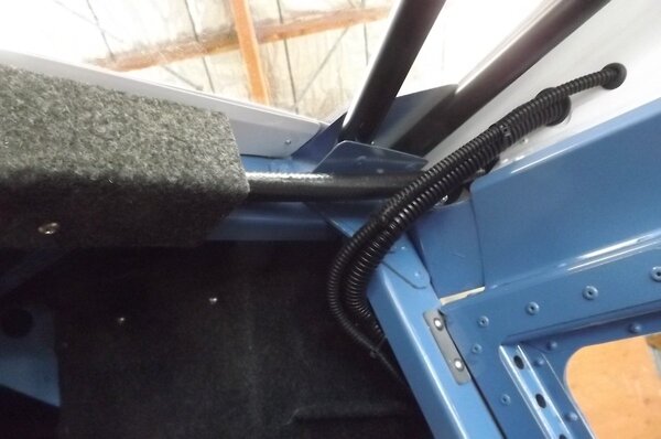

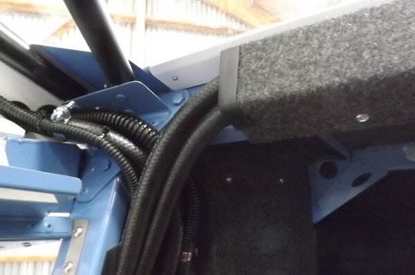

To run the LH fuel lines across to the valve block on the R of the fuselage, I made a tray that screws on in front of the cabin frame member. Some builders run the lines under and to the rear of that frame member, but this puts an undulation in the lines where air may sit, resulting in differential fuel flow. Where at all possible, avoid undulations in the upper fuel lines, and run them steadily downwards.
For those LH fuel lines, you can fit solid pipe (with hose at the last part down to the block). In my case, since I do not have solid pipe there, I recently laced those lines to a piece of light aluminium angle across the width of the tray. This has removed all undulations and the fuel tanks are now self-levelling on the ground, and feed more evenly in the air.
PS I believe ICP may now have amended the manual in recent kits, specifying how the 4 tank option should be plumbed. Builders of those kits may have to follow the amended manual for their build to be compliant.
Attached is a pic showing the tray carrying those LH lines.
Later on after fitting that fuel manifold I got a right angled barb fitting and put it into the right side end of that block and fitted another tap to it and bought my fuel return to it. That way I could turn the fuel return on and off and because it went to the fuel block it did not fill up one tank it just went as usuable fuel

IBob,  I'm a bit confused here being on the other side of the world and the other side of the equator.  Did you mean 1/4"BSP?  Which I would guess would equate to 1/4" NPT...  I like the looks of that setup and will do the same.  I have 4 tanks and only plan on using the two inboard.  I bought stainless steel tubing and ran that through the wing to the cabin.  Except for the short hose connecting the tank hose barb to the tubing, I have no rubber hose running through the wing ribs .  I figured it would be easy to replace a short than the whole piece.
Bodie, sorry, yes 1/4"BSP. Over here the manifold blocks are sold at auto paint shops etc, as they are principally used for compressed air lines.
I only occasionally use the outboard tanks here in NZ. But it's handy to be able to go there and back on some flights without having to source mogas.
Your solid tubing in the wing sounds good. Just be aware that the tanks may swell and shift a bit in use, so your coupling to the tank needs to be able to accommodate that: it sounds as if yours will.
