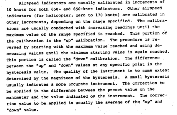

old man emu Posted February 9, 2021 Posted February 9, 2021 Never try to remember something that you can look up in print. In this case the "in print" are those simple strips of tape.  Isn't is amazing that airspeed indicators are marked with the white, green and yellow ranges out of the box, but no one ever says to "calibrate" them for your aircraft.  White Arc - Flap operating range Green Arc - Normal operating speed in smooth and turbulent air Yellow Arc - Operations in smooth are only.  Vso - Stall speed or minimum flight speed in landing configuration Vs1 - Stall speed or minimum steady flight speed for which the aircraft is still controllable in a specific configuration VRef - Landing reference speed or threshold crossing speed - The speed to be "over the numbers" Vx - Speed that will allow for best angle of climb - Obstacle clearance speed Vy - Speed that will allow for the best rate of climb  NOTE: On the illustrated ASI, there is a moveable scale to allow for IAS to be converted to TAS. Remember that the Lift formula is expressed in terms of TAS, so if you have one of these ASIs that has a moveable scale, the markings for V speeds should be on that scale. 1
kgwilson Posted February 9, 2021 Posted February 9, 2021 How can you calibrate something that is printed on the dial along with the numbers which are also immovable.

old man emu Posted February 9, 2021 Posted February 9, 2021 5 hours ago, kgwilson said: How can you calibrate something that is printed on the dial along with the numbers which are also immovable. Probably a bad use of the word "calibrate". What I meant was that if you mark those "V" speeds on your altimeter, you calibrate it. You mark it so that you have boundaries that the indicator needle must be within, or not exceed depending on the required speed. What you are after is something that you can glance at and know without having to think that the needle is pointing where you want it.  When you start your engine, don't you quickly look at the dial to see that the needle is "In the Green", so you can carry on. It might only be during flight that you actually monitor the position of the needle to assure yourself that the oil pressure is not falling (leakage, or pump failure) or rising (blockage).  5 hours ago, aro said: The important V speeds Vs0, Vs1, VFE are IAS not TAS ARO, I specifically wrote TAS because the Lift equation uses TAS, not IAS. Also I was referring to the illustrated ASI, which is probably more flash than the type you would use in an under 600 kg plane. It probably doesn't mean a hill of beans anyway, as very few pilots want to fly on the edge of the envelope. We all add a fudge factor.
