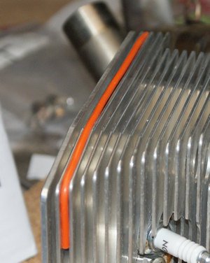

spacesailor Posted January 29, 2021 Posted January 29, 2021 I believe that the gasket at the end of the fins is to stop Air escaping, ! It will force that entrapped air to follow that bead of silicone, around the edge to wherever it,s needed to to go, just as the same thing an aluminium cowling ( shroud ) does.. spacesailor
RFguy Posted January 29, 2021 Author Posted January 29, 2021 yeah that's right spacesailor. there are sections where I want to insert and remove easily, hence the bead. and also on the side between cylinders, there isnt room for an all encompassing shround. well there might be with 2 thou SS shim.
Blueadventures Posted January 29, 2021 Posted January 29, 2021 On 27/01/2021 at 9:21 AM, RFguy said: I have a quetsion about the use of circular or rectangular cross section gasket bead. I want to push some silicone etc gasket bead in the fins on the top couple of mm of the fins (so not to obstruct the available fin area more than necessary). (why- because there is little.no clearance for flat sheet on the outside of the fins in the region- so a pushed in bead an option if I cannot fit 2 thou SS sheet Is a circular bead goes to have better retention than a rectangular cross section cord ? it would be secured with a little suitable adhesive here and there. suggestions. comments ? - intended use (orange bead below) and the small gap I have to work with (that reduces when it gets hot !) -glen Looks to me you will get no gain with the bead. The first and second bend will reduce the flow of air getting through the first change of direction and the second will likely result in stopping or almost stopped the flow. Just my thoughts on it.
RFguy Posted January 29, 2021 Author Posted January 29, 2021 yeah. I'm actually not too worried about getting around the corner clean - the pressure drop will take care of getting it out. should only be one change of air direction. The flow in though will be interesting- needs a inlet transformer. https://jabcamit.groups.io/g/main/message/13778 needs some refinement. concept is air must flow past the hot bits.
kgwilson Posted January 29, 2021 Posted January 29, 2021 IMO anything that blocks the airflow will have a detrimental effect. The area directly behind the blocked area will not get any heat exchange quickly enough and the fins will be hotter. It is like this in an air conditioned room where an alcove remains warmer than the rest of the room due to air not circulating there and relying solely on thermal conductivity of air which is terrible. Look at what happens when water is flowing and there is a blocked area. The water going past creates eddies & then the water in the blocked area just goes round and round. The pressure drop won't make any appreciable difference. Sucking as much air past all of the heat sinks as possible will always work best 1
RFguy Posted January 29, 2021 Author Posted January 29, 2021 which is what the technique does, but forces 100% of the fins to be active, rather than abotu 30% the air can only get out the bottom.

RFguy Posted January 30, 2021 Author Posted January 30, 2021 you need to hold the air in all the fins. that's right- it will not let the air out. precisely!... until it exits underneath. You might as well saw the fins off otherwise. Because the fins represent a narrow long duct, If the air has ANY CHANCE to go around the fins, it will.... The default setup is probably less than 25% fin utilization. Maybe less.
