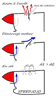

Garfly Posted June 15, 2022 Posted June 15, 2022 (edited) 2 hours ago, Bosi72 said: Maybe installing a large top cowling door would be a simple solution? Then open it every time after landing. From memory to check oil on Foxbat I had to remove whole top cover, then finicky process to put it back Installing a door would help with oil checks, and also cool engine bay much faster. Installing a couple of temperature sensors would help too. Only suggesting ideas. The French flyer Frédéric Peuzin who writes a blog and has a YouTube channel about his Jodel (SpeedJOJO) adventures, came up with an automatic tilting door for the top of his cowl: He describes it here: https://speedjojo-blogspot-com.translate.goog/search?updated-max=2019-02-01T18:21:00%2B01:00&max-results=2&start=27&by-date=false&_x_tr_sl=fr&_x_tr_tl=en&_x_tr_hl=en&_x_tr_sch=http And it can be seen in action here: Edited June 15, 2022 by Garfly 2 1

IBob Posted June 16, 2022 Posted June 16, 2022 1 hour ago, Garfly said: The French flyer Frédéric Peuzin who writes a blog and has a YouTube channel about his Jodel (SpeedJOJO) adventures, came up with an automatic tilting door for the top of his cowl: He describes it here: https://speedjojo-blogspot-com.translate.goog/search?updated-max=2019-02-01T18:21:00%2B01:00&max-results=2&start=27&by-date=false&_x_tr_sl=fr&_x_tr_tl=en&_x_tr_hl=en&_x_tr_sch=http And it can be seen in action here: Garfly, that's a really nice innovation! Also sort of mesmerising footage: they're certainly flying through the hills, not over them! I know another user here who always pops his oil filler hatch after landing. In his case he is concerned about the possible effects of heat on the ignition modules (as the earlier ones had a history of failing over time). 1 1 1
Garfly Posted June 16, 2022 Posted June 16, 2022 1 hour ago, IBob said: Garfly, that's a really nice innovation! Also sort of mesmerising footage: they're certainly flying through the hills, not over them! Yes, he loves his mountain strips in the SW of France. You can clearly see his little trap-door operating in this one posted just a few months back: Then there's this classic from a few years back at La Salette (posted here before). The Skyranger is owned by Fred's uncle. All three generations of his family are totally into flying. It's his son doing the amazing drone cinematography for this one. 3 1
