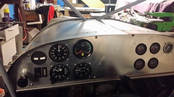

skippydiesel Posted May 27, 2020 Posted May 27, 2020 My panel is already the right shape. Just needs holes :) Well there you go - you still want/need to make nice round air spaces in an aluminium sheet. Spend the dough and use the services of a laser/water jet service provider or go the econo way with hole saws (messy) or circle cutters (fiddly & slow) OR invest in the poor mans laser (scroll saw). Oh! and by the way my panel above is aluminium, with aircraft grade 1.5 (I think) plywood glued on for a "sporty ambience" - all holes , except mounting points (drilled) cut with scroll saw. . 1

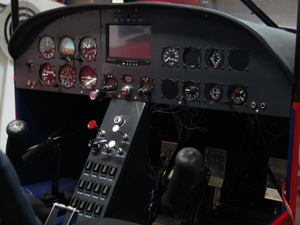

kgwilson Posted May 27, 2020 Posted May 27, 2020 A basic hole saw is all you need. Use one a bit smaller that the hole you want and then hone the hole with a half round file untill the instrument will almost fit. Then sand it with good quality emery till it is perfect. Takes a while but the result will be very professional. The cutouts for the ALt & VSI adjusters can be done by hand drilling initially & the same half round file emery treatment. Here's mine ready. Not aluminium but the process is no different. 4 1

skippydiesel Posted May 27, 2020 Posted May 27, 2020 Forgive me Kgwilson - very nice and neat to be sure BUT that does not look like an aluminium panel ?? The type of material to be cut has a big impact on the selection of cutting tools/technique.
kgwilson Posted May 28, 2020 Posted May 28, 2020 No it's not aluminium as I said in the post. It's fibreglass so was quicker to sand and finish. As I said the process is the same for aluminium as I had to cut holes in the aircraft skin for the fuel caps and also in the colorbond steel firewall for cables, fuel pipes, wires etc and the process for all 3 materials was the same, just don't use a blunt hole cutter and don't force the hole cutter. It will cut a neat hole if held steady and you allow the saw to do the work.
skippydiesel Posted May 28, 2020 Posted May 28, 2020 Again I beg forgiveness for disagreeing - cutting aluminium , especially thin sheet (aircraft grade), is not like cutting compost, which in my opinion responds/feels like similar to wood. I am not saying a hole cutter/saw can not be used but in my experience it has more risk of unforeseen damage (the more so the thinner the sheet) and the result tends to be messier (needs more cleaning up). I would only a hole saw, in this context, where little alternative existed.
kgwilson Posted May 28, 2020 Posted May 28, 2020 Your choice but it worked for me on .020 thou 6061 T6 sheet. I've never tried to cut compost 1 1
