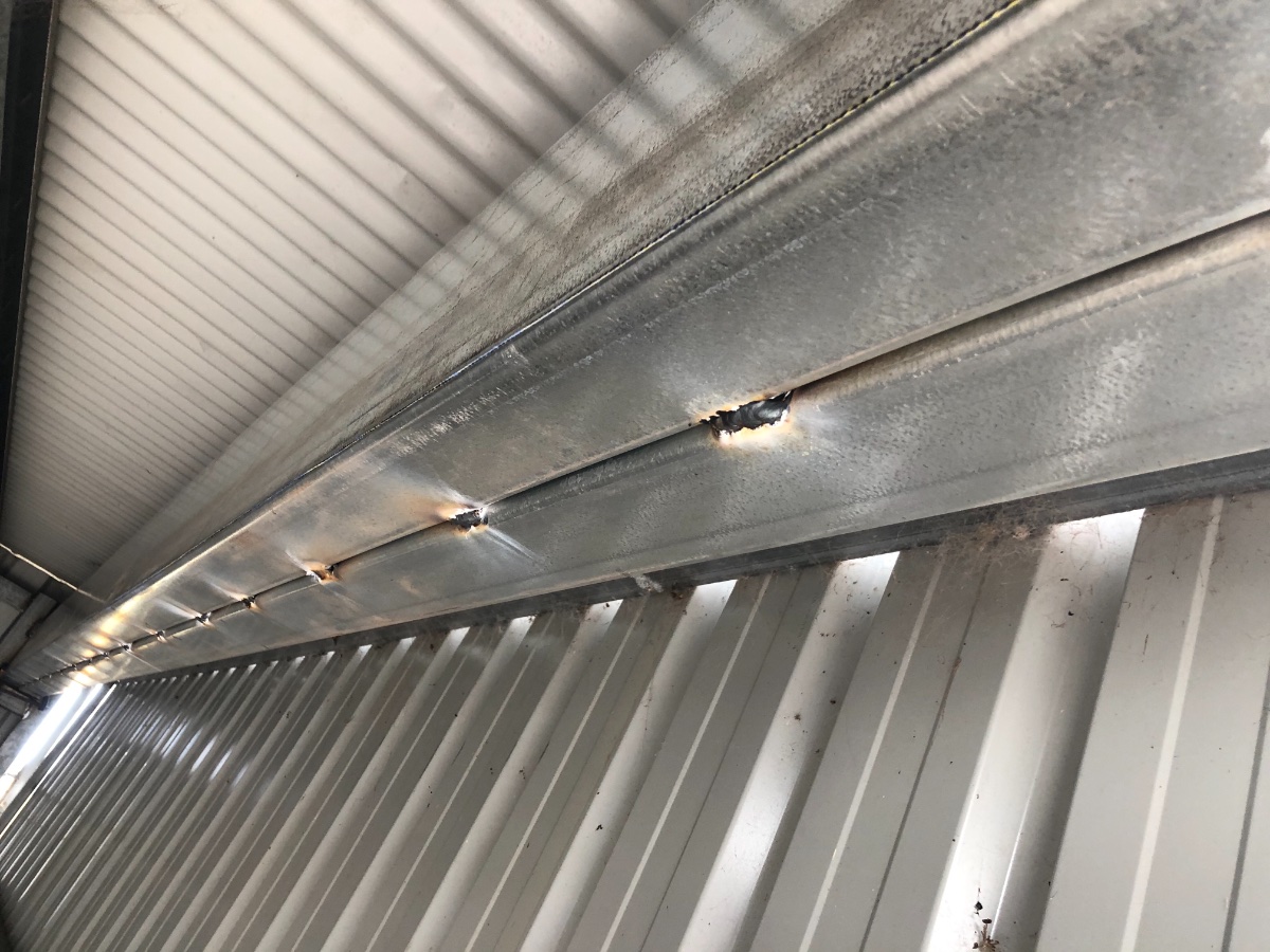

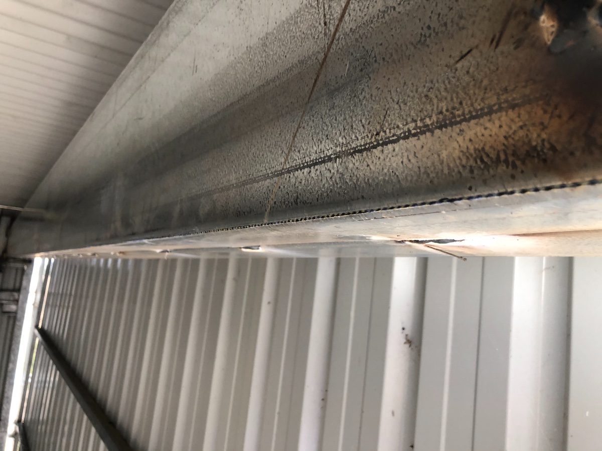

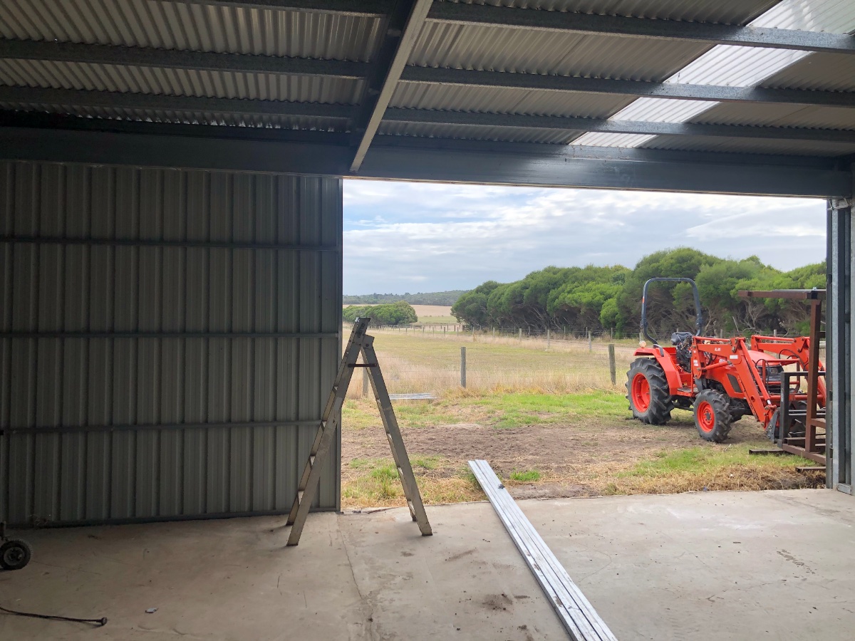

Mike Gearon Posted March 7, 2021 Posted March 7, 2021 Beams... I chose 250x 2.5mm C purlins instead of a big expensive H beam mainly because I could hand load these on barge to island. Knew they would sag at least a bit. Some 25mm with door weight as fact. Tom the French island barge driver is a former professional welder. He suggested I Jack the center and stitch weld every 300mm underneath and it would work like a tray truck tray with upward tension. Damned if it didn’t end up millimeter perfect. Pic 2 is string line edge. 4 1 2

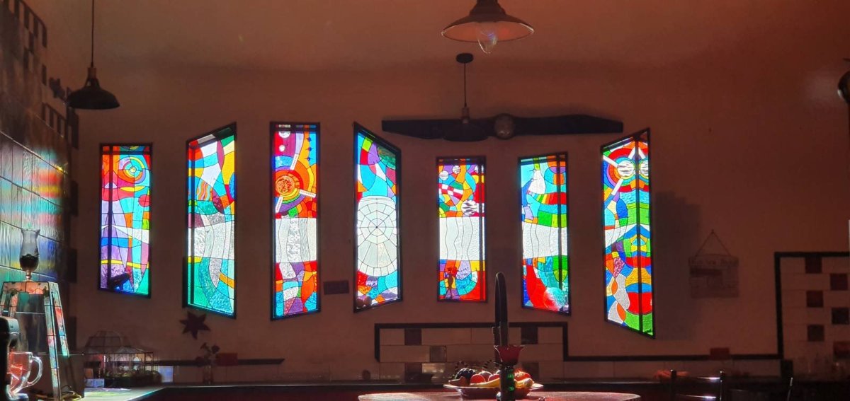

dlegg Posted March 13, 2021 Posted March 13, 2021 I have converted a hangar to live in, this is our kitchen window, B17 bomber coming in created in stained glass/leadlight over 7 panels. Captures the afternoon sun. 8 3

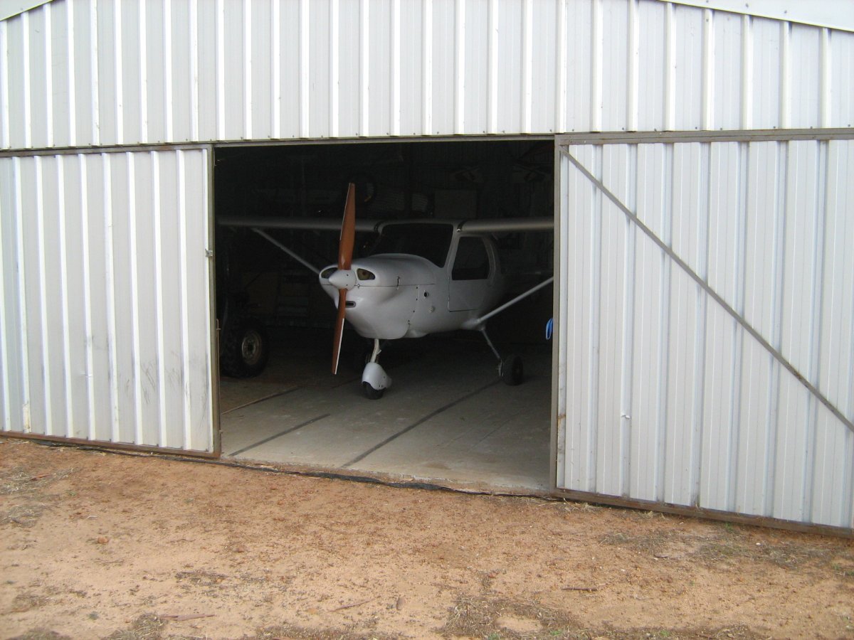

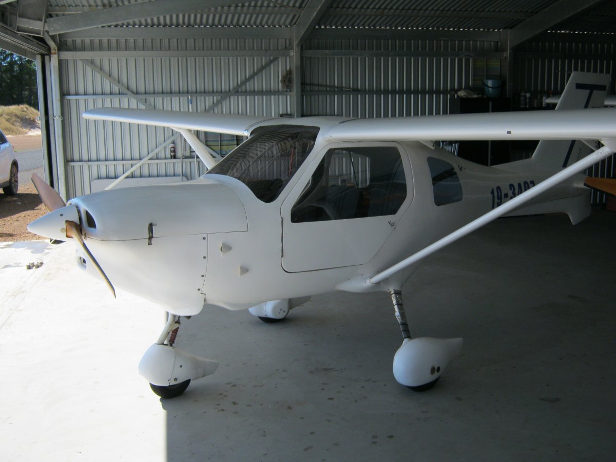

Bruce Tuncks Posted March 31, 2022 Posted March 31, 2022 Well, having moved, my hangar at Gawler was sold and a new one at Edenhope built. The new hangar only had to be 10m wide to accommodate the Lancair, but the shed guys said we could have a 12m wide one cheaper! On account of being a standard size. Bugger I can no longer claim that everybody has a bigger one than me. The pic is NOT the edenhope airfield one but one I built at the farm. It was 9m wide and 7.5m deep so it really was smaller than the Gawler one. Nowadays that hangar is so full of tools and bikes and buggies that there is no room for a Jabiru anyway. 5 1

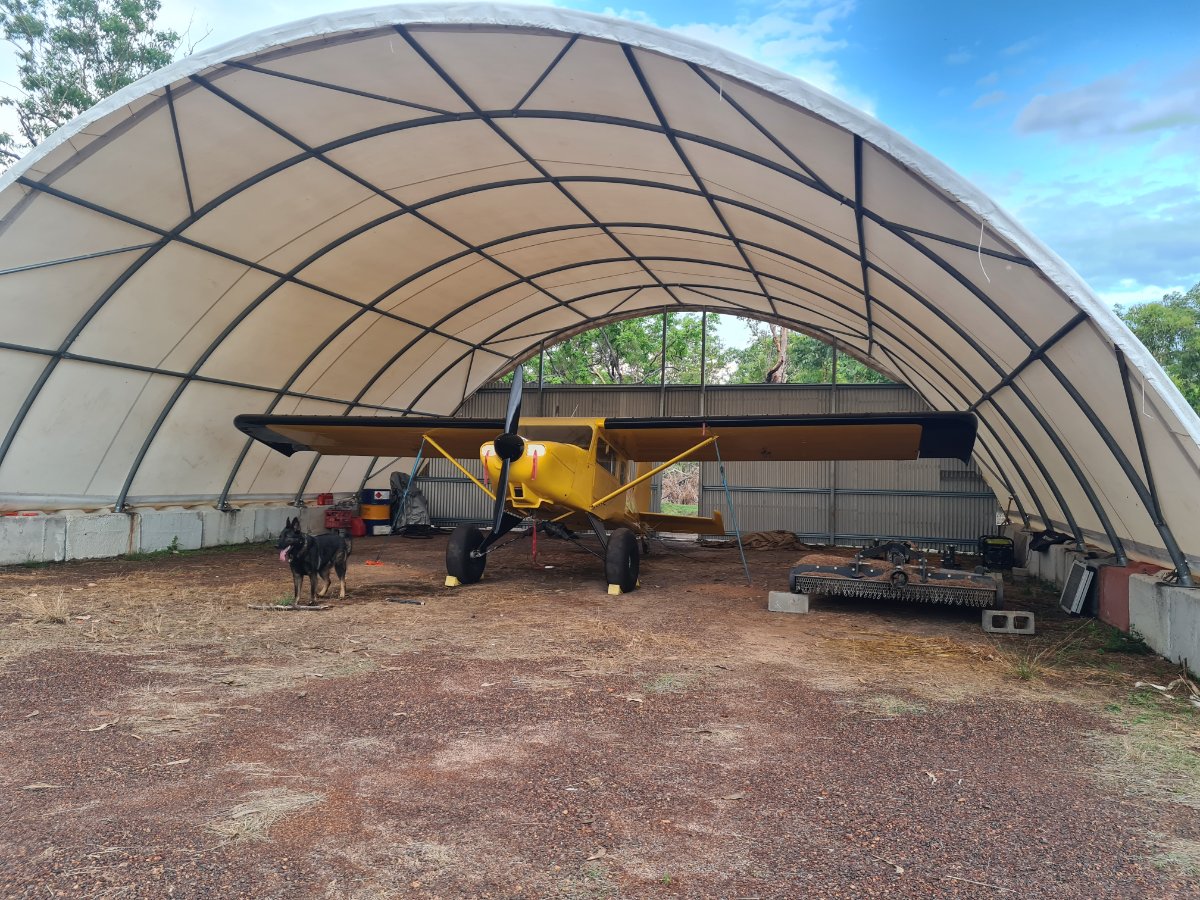

NT5224 Posted October 9, 2022 Posted October 9, 2022 (edited) Ok been a while since I updated this. After months of delay and other chores prioritised, I have thrown up a back wall to my hangar. This keeps the morning sun off, and driving rain out in the monsoon. Used some steel members I had lying around the place and sheeting collected from the Darwin Tip shop. So far, everything you see has been built for about $8000. The Boy (our German Shepherd) loves the hangar and serves as airstrip Guardian and wildlife chaser. Alan Edited October 9, 2022 by NT5224 8
onetrack Posted October 10, 2022 Posted October 10, 2022 (edited) I bet he's proud of having the biggest kennel in the region! Those Dome Shelters are quite popular amongst the mining people, but there are big variations in the build quality of the frame, and the durability of the covering material, depending on who the supplier is. A lot are built to a price, not for durability. There are some highly durable covering materials out there, and it pays to check out the units that have been erected for a while to see how the fabric is travelling as regards destruction by strong sunlight. Edited October 10, 2022 by onetrack 2

rgmwa Posted October 10, 2022 Posted October 10, 2022 Make sure it's designed to have one end blanked off if you fully sheet the end. If the airflow is blocked a strong gust of wind in a storm could easily lift it. 1 2

NT5224 Posted October 10, 2022 Posted October 10, 2022 (edited) 9 hours ago, onetrack said: I bet he's proud of having the biggest kennel in the region! Those Dome Shelters are quite popular amongst the mining people, but there are big variations in the build quality of the frame, and the durability of the covering material, depending on who the supplier is. A lot are built to a price, not for durability. There are some highly durable covering materials out there, and it pays to check out the units that have been erected for a while to see how the fabric is travelling as regards destruction by strong sunlight. Yes that is a solid point onetrack. Our shelter was definitely at the cheap end of the scale and our expectations about its durability are realistic. However a replacement cover is only $2000 and just takes a day to throw over and tension. We couldn't have thrown up a steel shelter of comparable size for less than $20,000. So we get five cover replacements for the price.... That will keep my aircraft sheltered longer than I am likely to be flying... Another factor is that we erect all our infrastructure ourselves because of the cost of bringing in trades. These arched tension structures are really easy to build to get a 12m span and can be thrown up by just two people and a dog. Alan Edited October 10, 2022 by NT5224 3
NT5224 Posted October 10, 2022 Posted October 10, 2022 (edited) 8 hours ago, rgmwa said: Make sure it's designed to have one end blanked off if you fully sheet the end. If the airflow is blocked a strong gust of wind in a storm could easily lift it. That’s a good point which is why I’m not fully closing the back wall and leaving the door open. Just some hessian material for shade which comes down in winds. Alan Edited October 10, 2022 by NT5224 1
