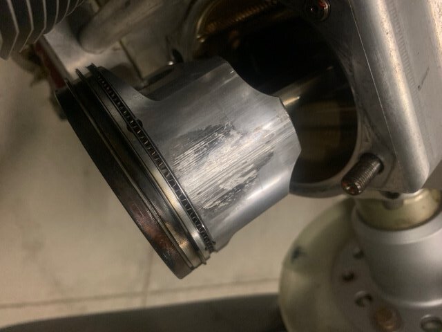

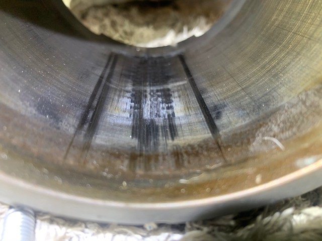

Photos I was sent last year. Gen 4 pistons in a Gen 3 engine after approx  3 hours running. Engine now has non-Jab forged pistons with no issues.
OUCH
Yeah they have a Gen3 retrofit specific  solid skirt piston now.  195+gst each.
Produced since December 2020 .
Insufficient clearance by the look of it. Some forged pistons need extra clearance just because of the alloy used.
 Nikasil  bores don't wear much. The hone pattern on the cyls shown doesn't look the best. Jabiru get a good finish but the hone pattern could be a bit coarser to hold more oil. Honing steel is not easy. Nev
