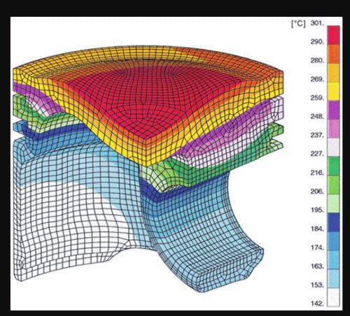

RFguy Posted April 12, 2021 Posted April 12, 2021 (edited) The piston temperature is a complex beast : (wet jacket cylinder bores) https://x-engineer.org/automotive-engineering/internal-combustion-engines/ice-components-systems/internal-combustion-engine-piston/ Edited April 12, 2021 by RFguy 1
