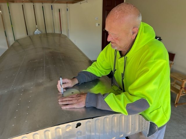

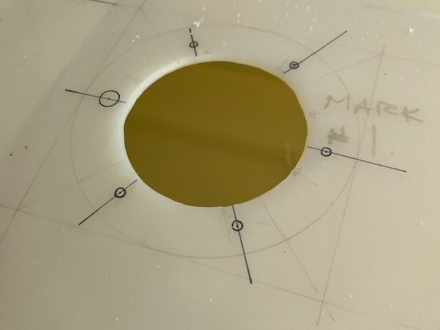

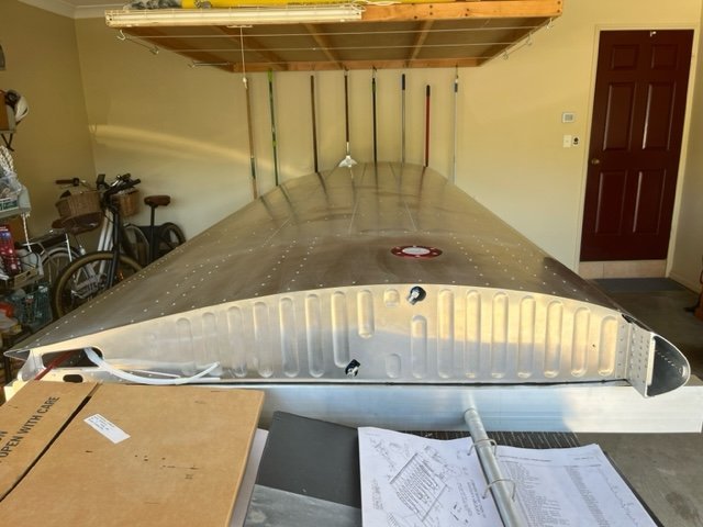

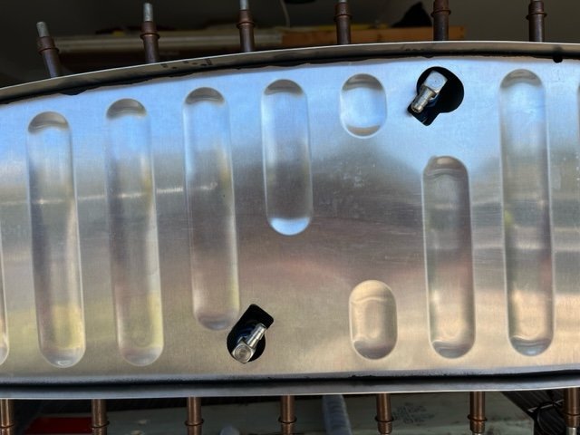

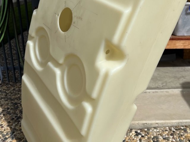

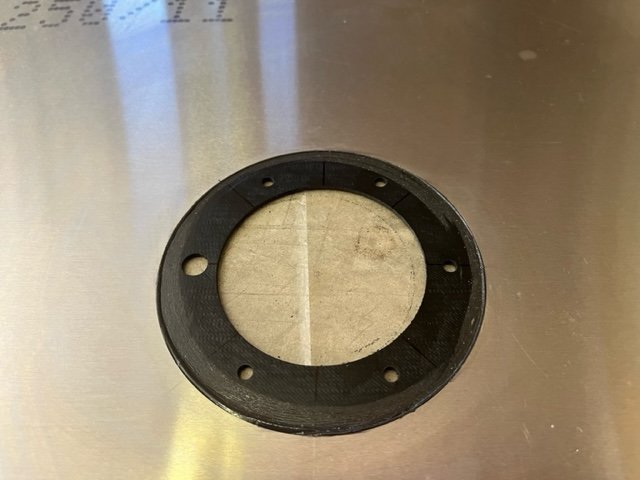

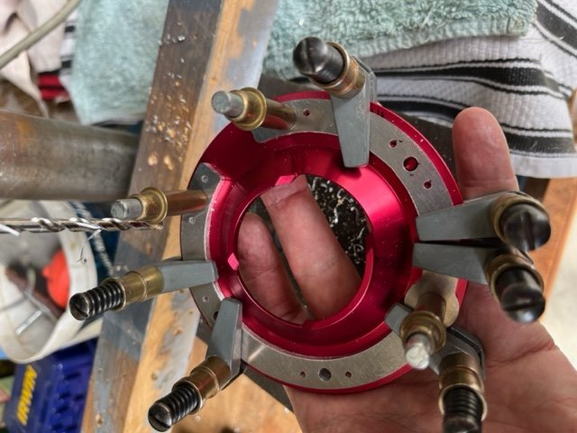

08/08/23
Fabricated fuel cap retainer ring. Marked and cut openings in fuel tank. Vacuumed and flushed fuel tank, checked for leaks under low head. Installed fuel sight gauge and tank flange fittings to tanks.
5.1h
image0-13.thumb.jpeg.9b6106235f93aebd1811d43ea1ac612c.jpegimage2-13.thumb.jpeg.36aa198f92e8dd0fd90fe83522b432c9.jpegimage4-3.thumb.jpeg.87232b9689db7034a8db34e5da5bcc0f.jpegimage1-15.thumb.jpeg.48c2672b552897ad884dbf04664e3fe0.jpegimage3-9.thumb.jpeg.b145d261a5ec3da96d46cb9019d12446.jpegimage5-2.thumb.jpeg.82f1d371d120d6c41a7aa6ff60682f71.jpeg

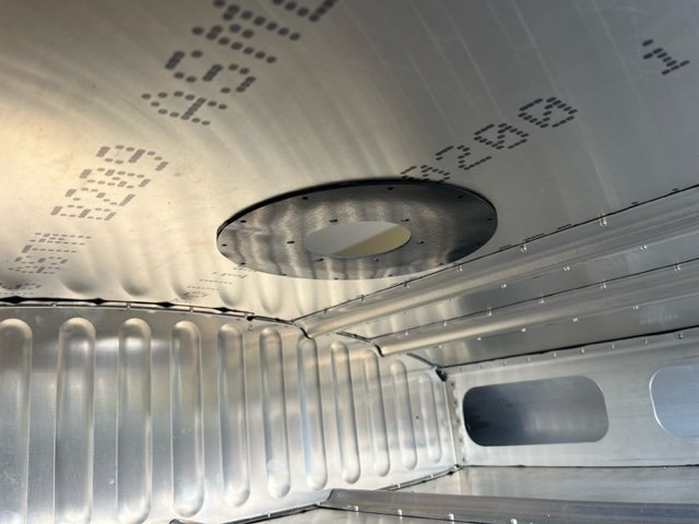

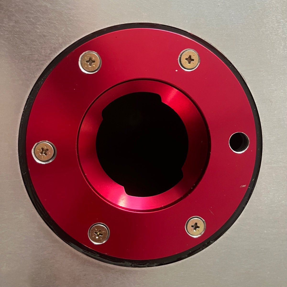

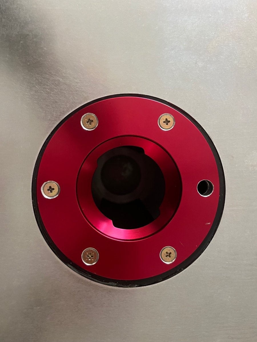

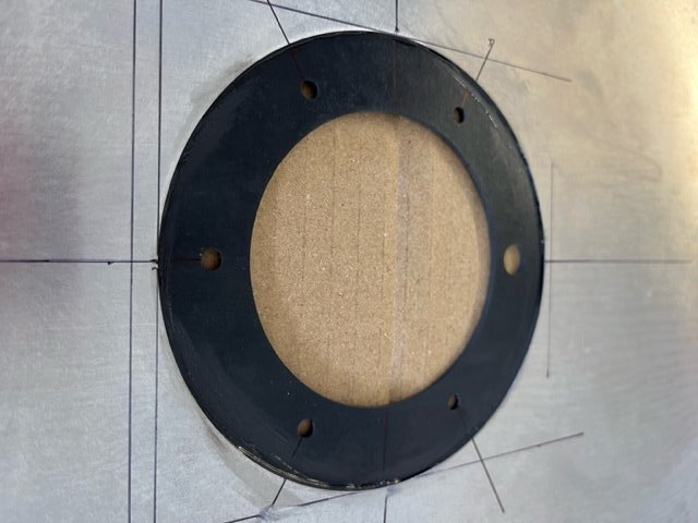

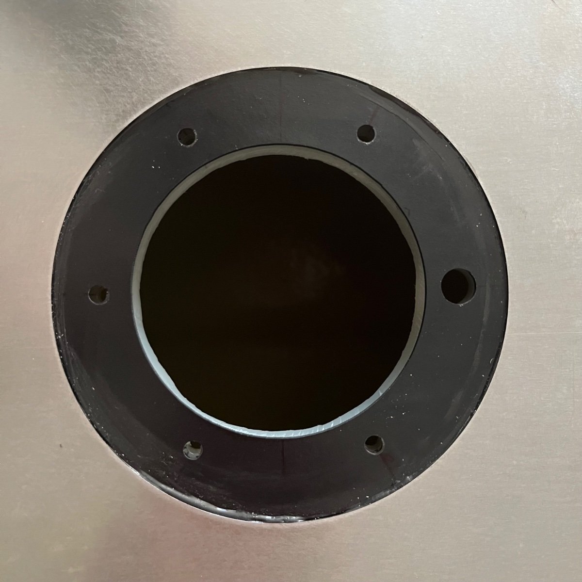

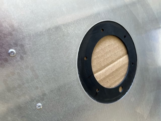

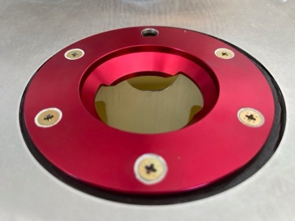

I have a question…. Did the Viton seal location end up being exactly concentric to the upper skin cut out?
I’ll jump in to answer, as a multiple RANS 141 wing builder, on Mark’s behalf.
The wing surface geometry dictates that it won’t be perfectly concentric once the tank stand is installed….This is because the forward edge of the tank stand is around 10mm higher than the aft edge.
This aspect, combined with the camber (curve) of the upper wing surface (as compared to the flat surface of the filler flange) means that once everything is tightened up, there is a minor amount of stretching of the scupper seal.
Reference to the pics below….Lower edge of photos are forward.
Scupper is concentric prior to installation of tank stand (and filler flange)
Scupper is marginally eccentric due to stretching induced by tank stand.IMG_8809.thumb.jpeg.334b88f2807814ff58bee2aef179aba1.jpeg
The eccentricity is very minor and will only be observed by the crew of low flying airliners.

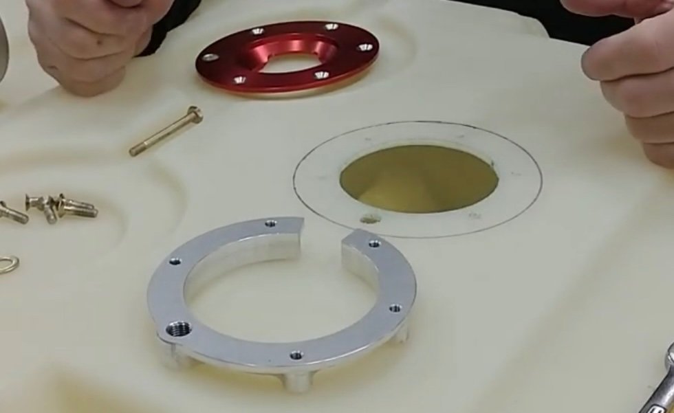

Okay. The reason I’m asking is….
Those fuel tanks have been problematic from the start. Sizes change for whatever reason related to the mould/ material etc.  Rans have had ongoing struggles with the tanks and mods such as the filler insert and the improved fuel cap assembly.
Tanks were also moving rearward which prompted the new rear stop kit.
I suggested at one stage I might make a Viton seal after seeing what a mess YouTube builders were demonstrating as they struggled with the Proseal. Nice to see the Viton seal provided.
The other consideration is that those tanks were moving rearward and obviously breaking the Proseal loose. The tank currently sits in place with the new rear plate stopping the main problem rear movement and can be used to provide a concentric position fore/ aft. When you look at the lateral arbitrary movement it seems it can be concentric without concern given the 1 or 2mm variation I see in your pics.
So, with consideration to the tank being held in place by a rear support and the the glued Viton seal it worries me that the tank can move forward and laterally a small amount fixed solely by the seal. This then begs the question of why the upper skin isn’t redone with the fuel cap ring 6 holes and smaller inner opening. Then it’d just have a Viton seal at upper and lower surfaces.

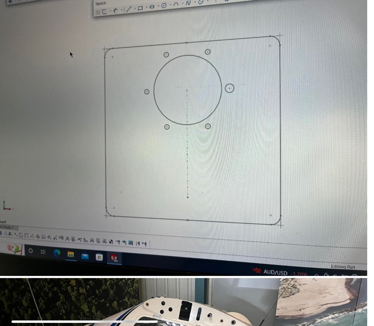

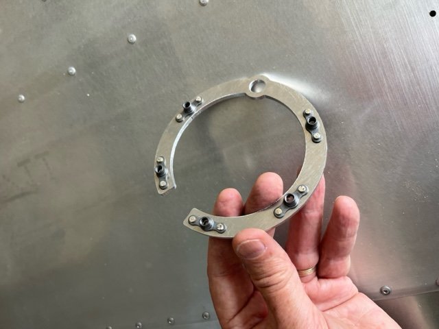

As such I’ve had laser cut aluminium sheet (pic here) to bond beneath the wing skin then proseal the Viton seal underneath. Provides a heap more sealing and security/ fixing of the tank.  Another Viton seal on upper surface and done.
I meant to discuss this with Randy at Osh Kosh and forgot. Might pay a visit before returning to Oz in a few weeks. This is one of my first projects on return so timely to discuss.

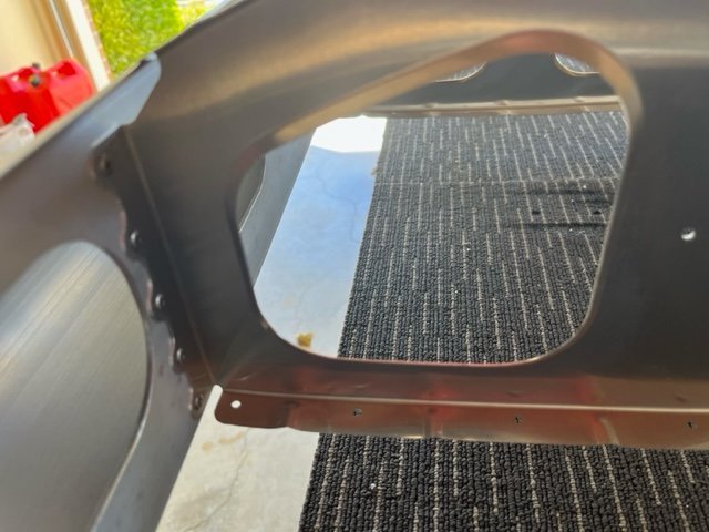

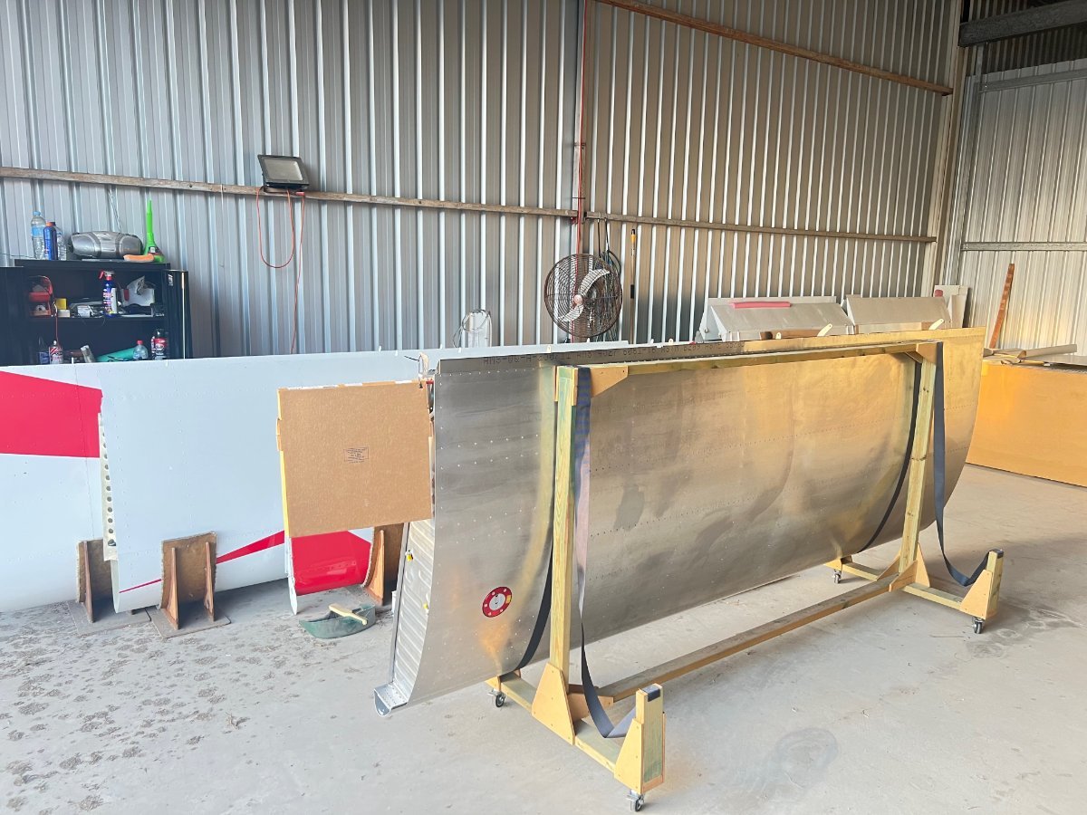

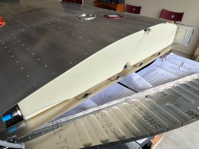

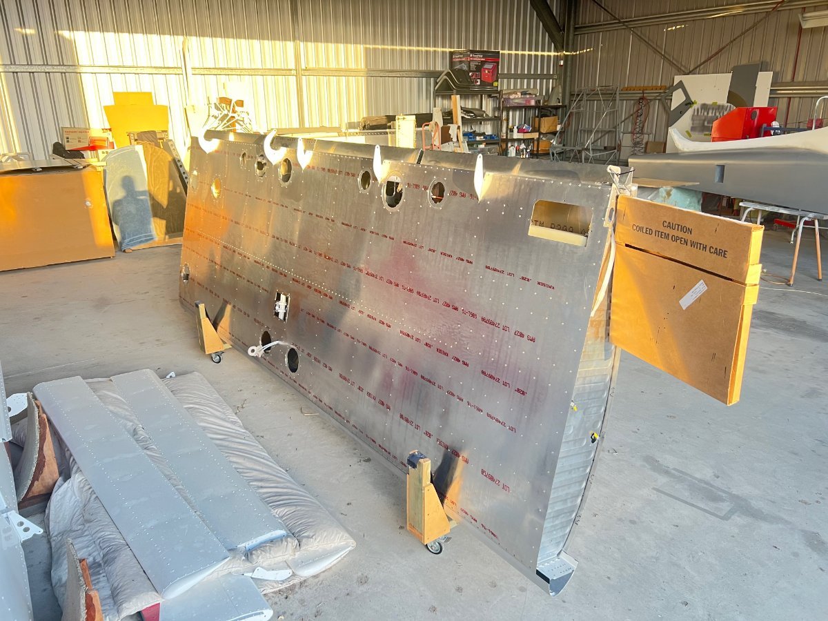

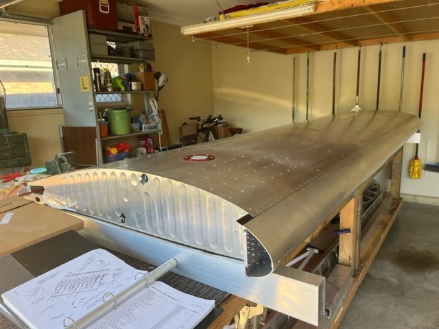

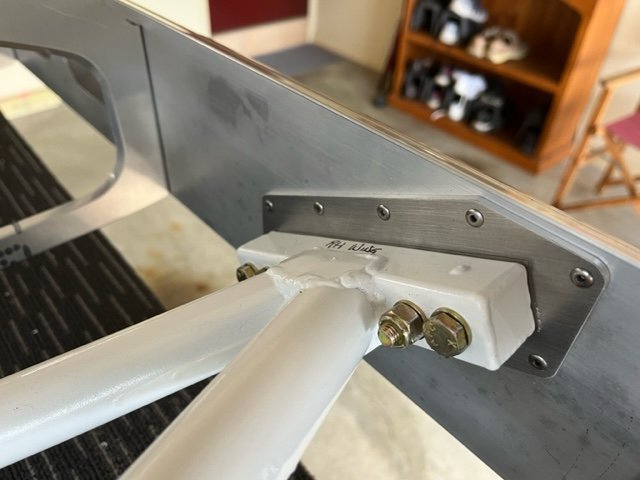

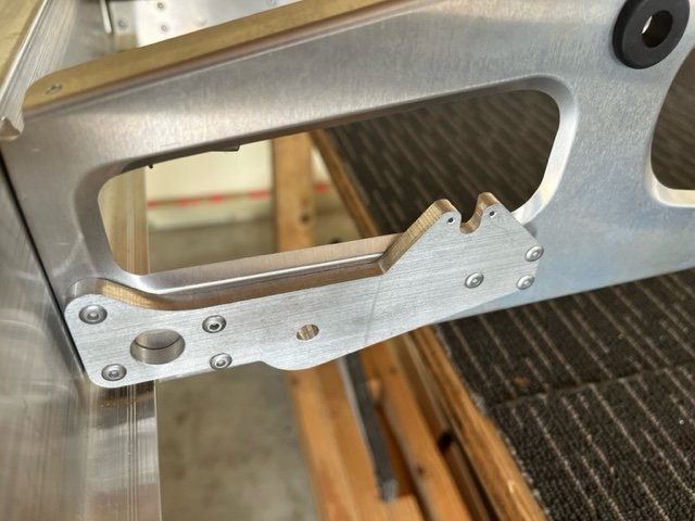

09/08/23
Installed fuel tank stand and filler flange. Installed fuel tank retention brackets. Modified sight tube fitting penetrations and installed LH wing root rib. LH wing fabrication complete.
5.2h
image0-14.thumb.jpeg.2e8e8923d655e4aa9d39cb9b72e42267.jpegimage1-16.thumb.jpeg.1cd6bc677a0a1821fe6122eba2076cbd.jpegimage2-14.thumb.jpeg.f0cdaaff6ff9b36062639b9e9ed076e4.jpegimage3-10.thumb.jpeg.a1d6b4c9c1c6e7ea5c77901b649bd07c.jpegimage4-4.thumb.jpeg.d5c09af132d3f4e70f0d6e6e36195a25.jpeg
  • Winner 2

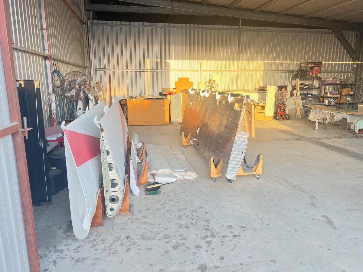

Now that wheeled wing dolly is a good looking beast.  I'm copying that.
Rodger made it up when he did his wings had it stored here for about a year. So I got the hand me down 🙂 ...I also got Gregs 2 benches he made for assembling his S-21.... bargain bonaza . makes life much easier

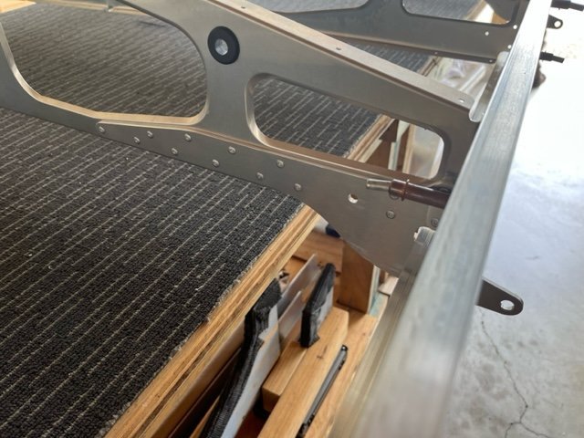

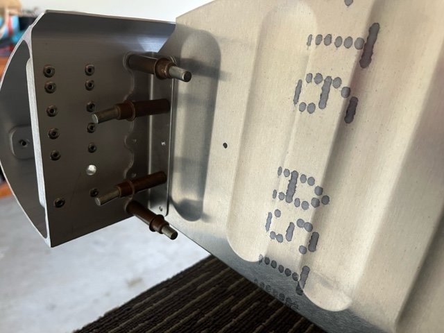

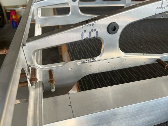

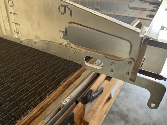

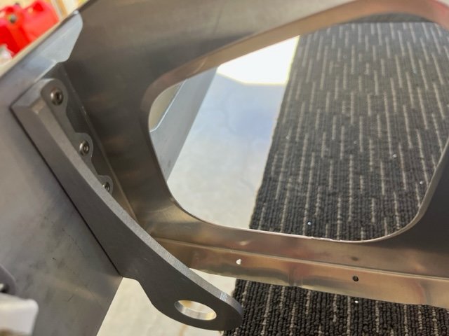

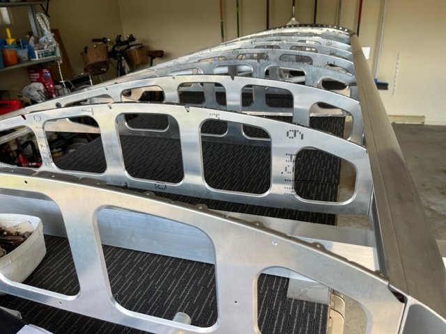

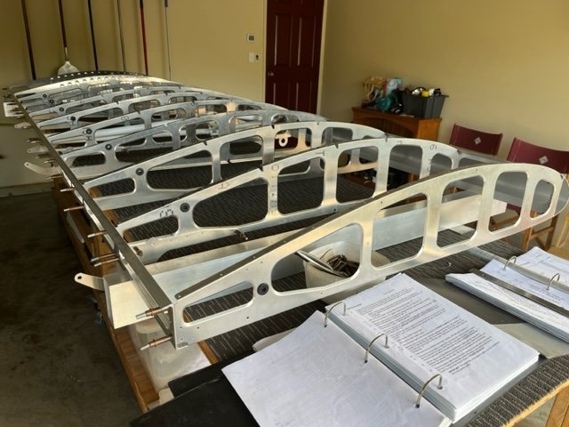

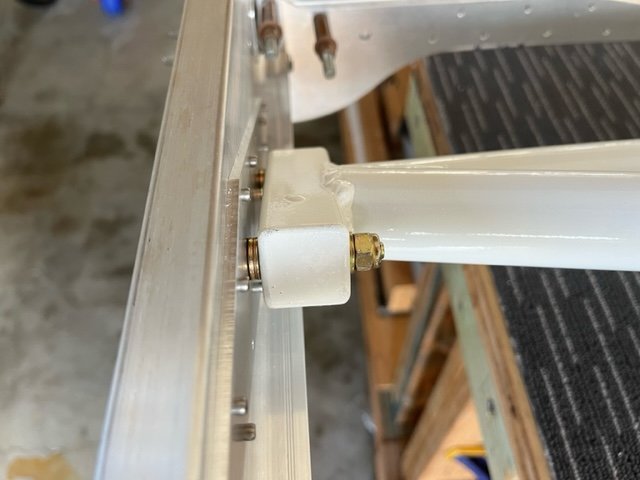

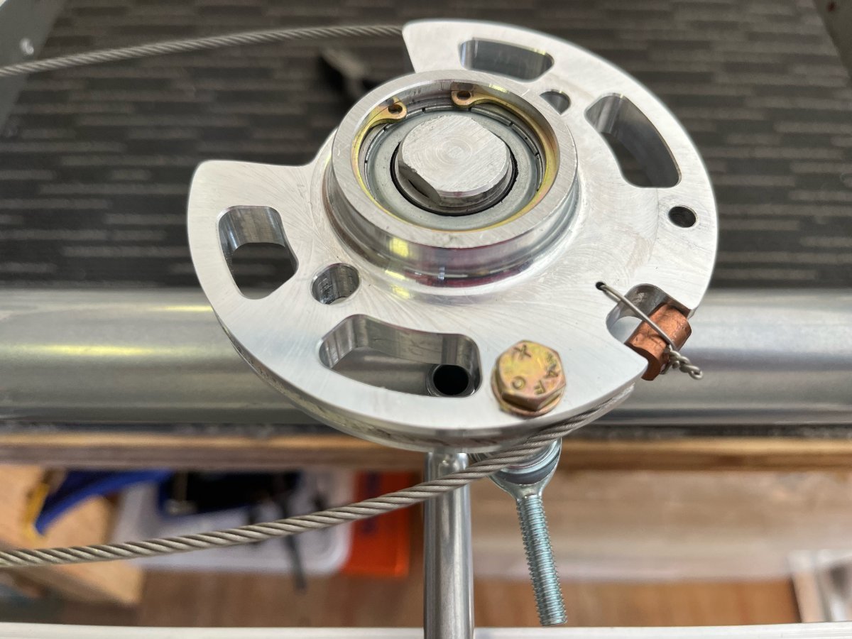

15/08/23

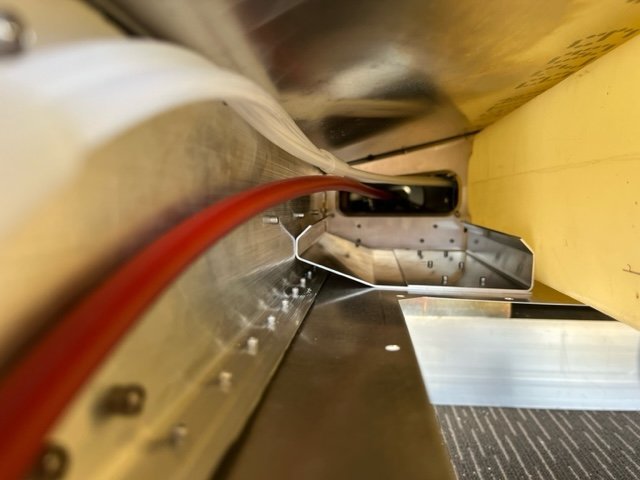

Bolted wing truss to RH main spar. Clecoed ribs to main and rear spars. Levelled wing supports. Shimmed and bolted rear spar to wing truss. Clecoed aileron and flap hinge arms, wing tie-down angle, flap bellcrank mount, aileron bellcrank outer rib support and rib aft attach angles in position.
4.7h
image0.thumb.jpeg.66b34baa933372703f68e58b6d1d5a53.jpegimage6.thumb.jpeg.8d3703773621d65a0aae232dff8e0057.jpegimage3.thumb.jpeg.7ef894a421e2273d78797d4733882701.jpegimage4.thumb.jpeg.2467cd080d527e2625a0cad7a0413f2e.jpegimage5.thumb.jpeg.2c875f5b19b3d5ea0bb407d343d8a482.jpegimage1.thumb.jpeg.cba17cf5d8d7a6d73dff5768cab92635.jpegimage7.thumb.jpeg.31092957dc331d65d52963682022f19f.jpeg

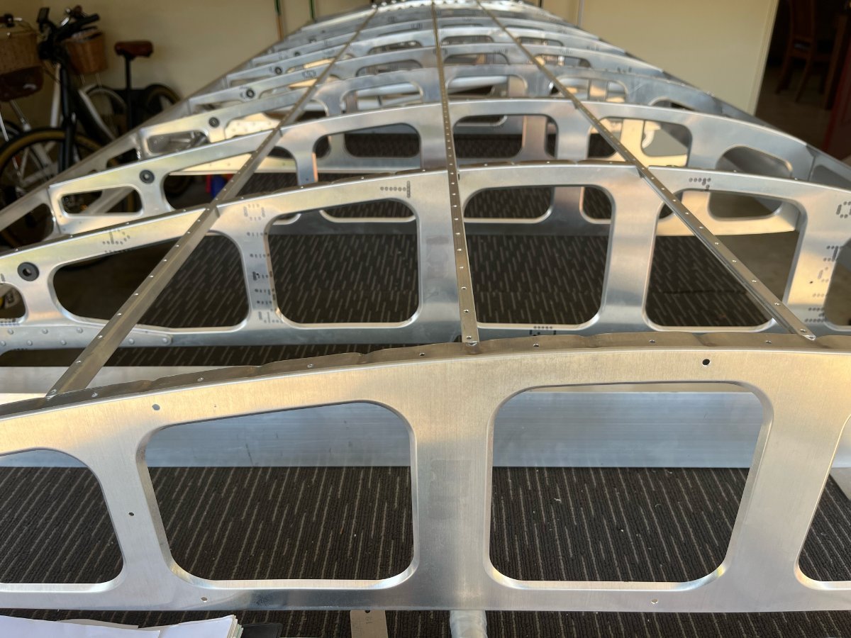

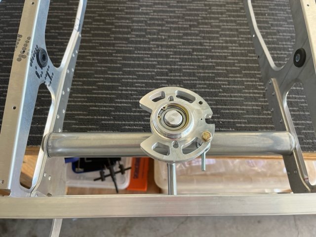

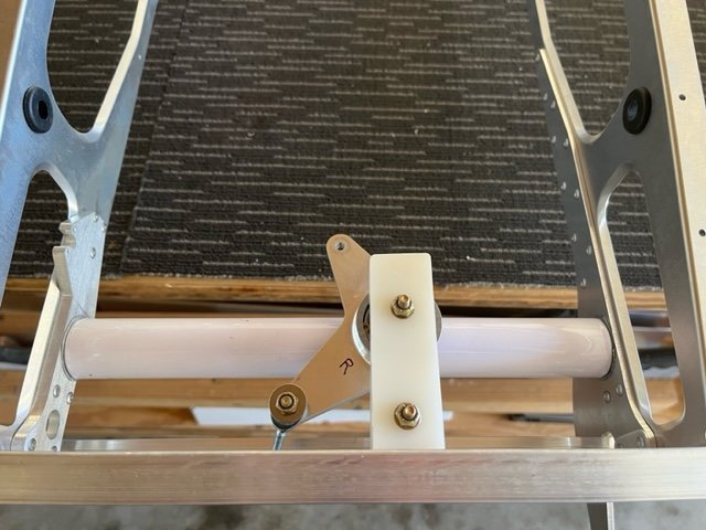

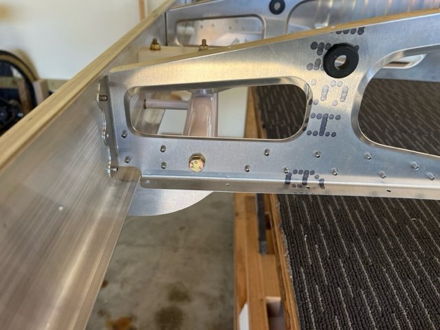

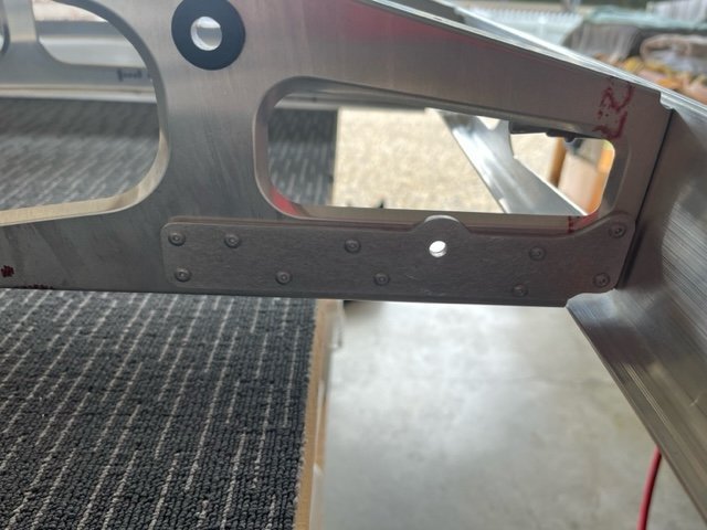

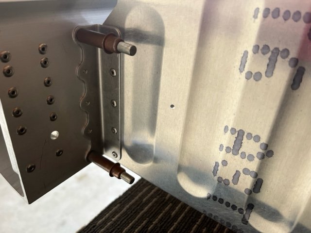

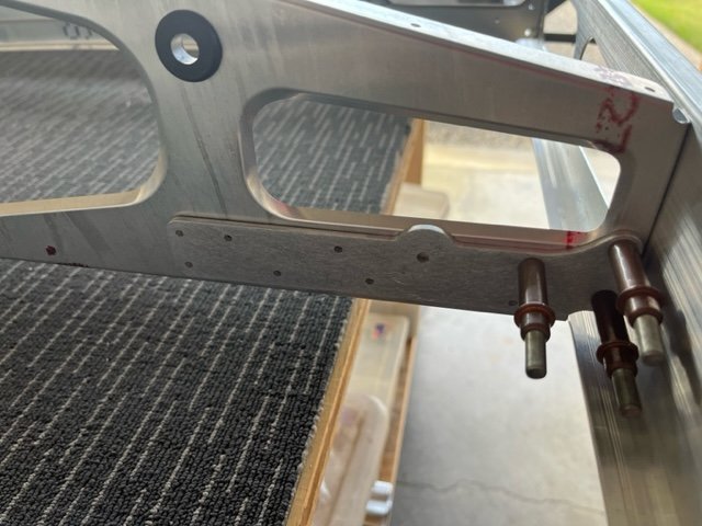

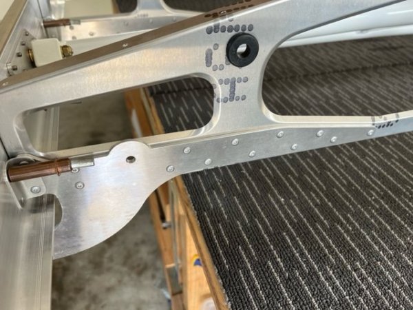

16/08/23
Match drilled, deburred and riveted aileron and flap hinge arms, ribs aft attach angles, aileron and flap bellcrank attach mounts and root rib forward attach angle to ribs of RH wing.
2.1h
image0-1.thumb.jpeg.91a5d6b9c139e09c29975bddd3514079.jpegimage1-1.thumb.jpeg.3e1a524612690dc072891967a976a7bf.jpegimage2-1.thumb.jpeg.ed09bd6aa3466398fc80c728275e2287.jpegimage3-1.thumb.jpeg.790877e378a087794d89d574031fcbdc.jpegimage4-1.thumb.jpeg.c5ec3acf27b15f9381482517ad1d32a6.jpegimage5-1.thumb.jpeg.e9f576b07128565533de26de33aa7c4b.jpeg

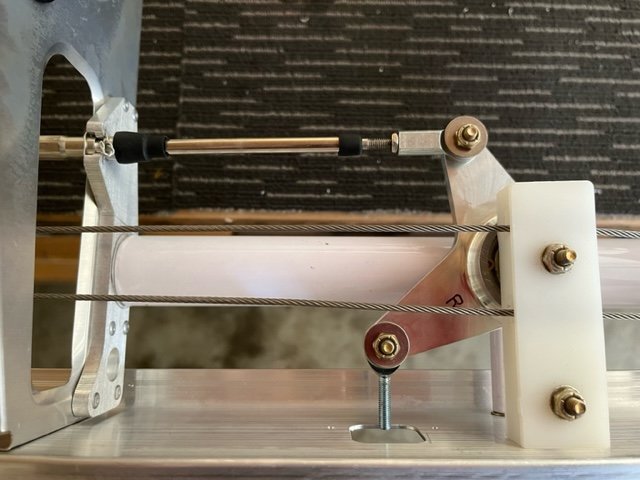

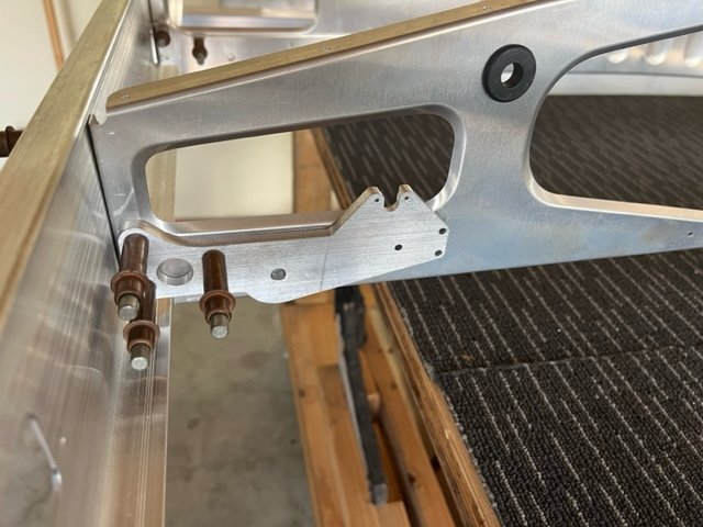

19/08/23
Riveted ribs 2 to 11 to front and rear spars of RH wing. Riveted tie down angle to front spar. Bolted aileron and flap bellcranks to their mounts and rear spar. Attached rod ends to aileron and flap bellcranks.
1.6h

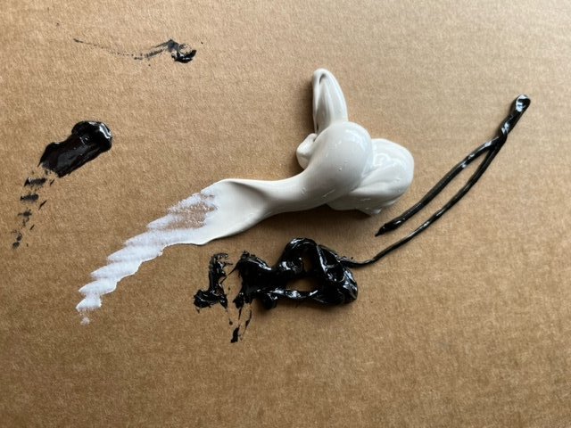

27/08/23
Trimmed and deburred stringers to RH upper wing skin. Installed aileron control and Teleflex flap cables to RH wing. Proseal bonded fuel tank scupper seal to upper RH wing skin.
2.8h
