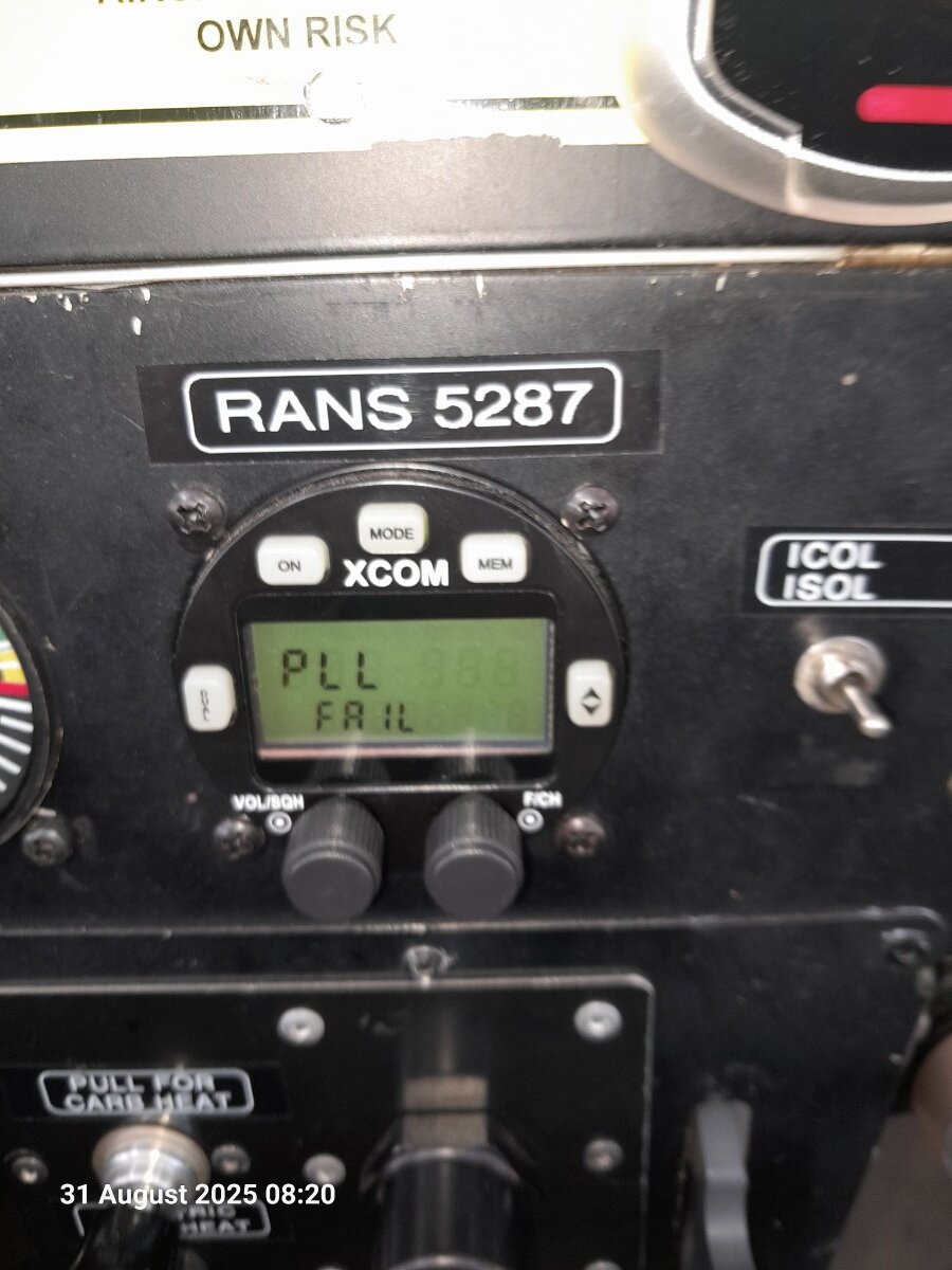

Kiwi Posted August 31, 2025 Posted August 31, 2025 (edited) On 16/06/2022 at 2:01 PM, Kyle Communications said: Xcom can still be fixed..some parts are not available but most are Hi Mark, I have a intermittent fault code "PLL FAIL" on my Xcom, sometimes won't transmit but will receive, and sometimes won't transmit or receive. Checked the radio back in the hangar and it was working fine again. Any idea on what the fault code means? Thanks, Kiwi. Edited August 31, 2025 by Kiwi

Kiwi Posted August 31, 2025 Posted August 31, 2025 Thank you both for the reply. I wasn't sure if Ken was still repairing the Xcom. Kiwi 1
Kyle Communications Posted September 1, 2025 Posted September 1, 2025 Yes Ken is still servicing the radios and also has most parts but some are not available anymore. a PLL fault is a hardware issue not a software one. I think the original PLL chip is not available now but Ken has a updated mod for it Mark 3 1
