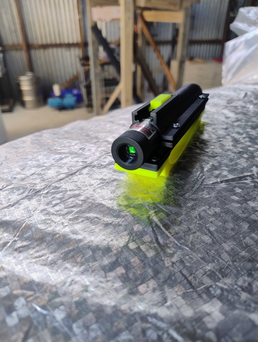

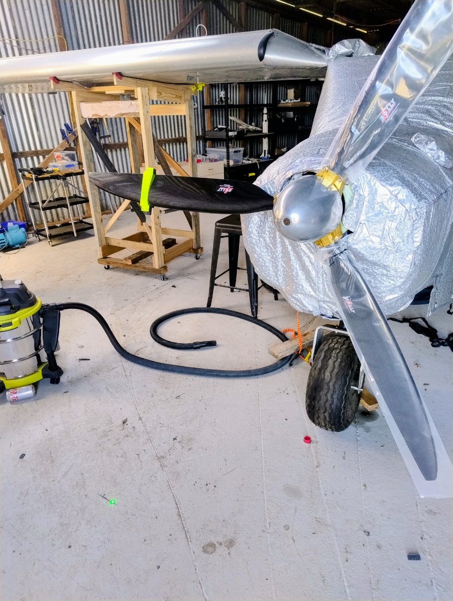

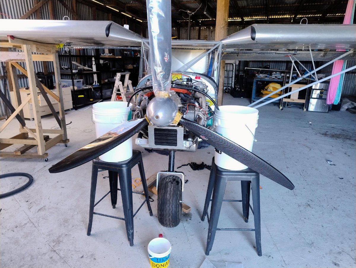

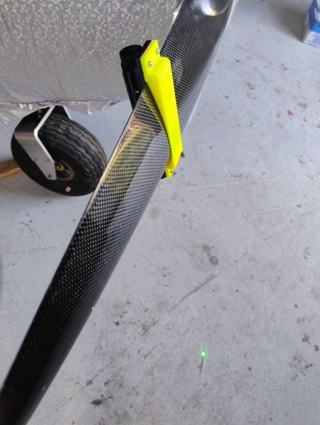

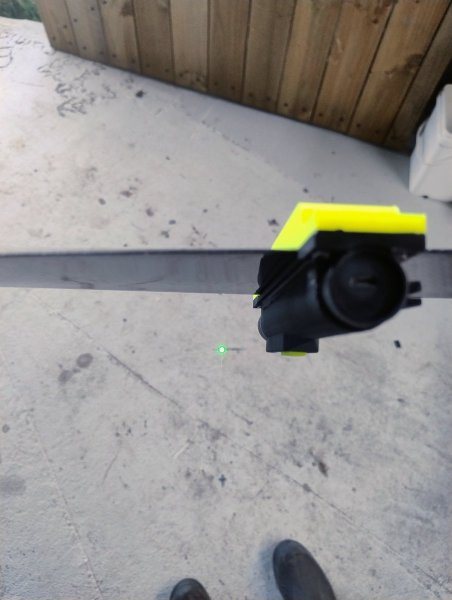

Marty_d Posted January 10, 2025 Author Posted January 10, 2025 Prop pitch done! (First attempt anyway!) I made a tool to hold a laser pointer which I bought on Ebay for $17. I think it might be slightly illegal as the damn thing is very powerful - you can clearly see the beam in low light conditions and even in broad daylight you can see the spot on a tree that's 100m or more away. Anyway, I was interested in @IBob's method of attaching a piece of wood and aluminium to the prop, but being someone who likes to over-complicate things I 3D printed a holder for the pointer based on measurements of the prop blade at 300mm from the tip (600 from the centre). It slips on and stops at the same spot on each blade, and features a sliding switch which holds down the spring loaded button. If anyone has a Bolly 3 bladed prop of the same model and wants to print their own, I'm quite happy to email you the STL file. I ensured the prop is as vertical as possible, found the height where the blade is parallel to the ground and leveled the flat back of the blade vertically. From this point I turned on the laser and made a cross on the floor where it hit. Then used a calculator to get the adjacent length of the right angle triangle where I knew the vertical length and a 19 degree angle. Marked a line at that point forward of the mark on the floor. (Just to check, I calculated for 18.9 degrees and 19.1 degrees. Each 1/10th of a degree is around 2.2mm.) After that it was just a matter of swiveling the blade until the laser line exactly hit the front line, and repeat for the other 2 blades. I nipped up the bolts just enough to hold the blades from turning - less than 8nm. When I recheck with the spinner thingy off completely I'll tighten up the bolts to the recommended torque settings in the recommended order. 3 2
IBob Posted January 10, 2025 Posted January 10, 2025 (edited) Marty......much tidier than the thing I cobbled up! Apart from very accurate measurements from floor to blade (I use a stick with a clamp on it, bring the each blade down onto the clamp) and very accurate measurement from blade tip to laser position (I use a sliding square and mark the location with masking tape).........there is one other thing to watch for using this method, and that is blade tracking: One of my blades tracks about 2mm further forward at the tip than the other two, so I factor that in. If I were using a similar method, but with an inclinometer on the blade, I wouldn't have to be concerned with the tracking. The only proviso then would to be sure I was using a good quality inclinometer, as they are not all born equal........ For myself, I will carry on with what I've got: done with care it does get very accurate results. PS I tighten all bolts fully then check all blades again, as sometimes the tightening does shift the pitch a bit. Edited January 10, 2025 by IBob 3
Marty_d Posted January 10, 2025 Author Posted January 10, 2025 1 hour ago, IBob said: Marty......much tidier than the thing I cobbled up! Apart from very accurate measurements from floor to blade (I use a stick with a clamp on it, bring the each blade down onto the clamp) and very accurate measurement from blade tip to laser position (I use a sliding square and mark the location with masking tape).........there is one other thing to watch for using this method, and that is blade tracking: One of my blades tracks about 2mm further forward at the tip than the other two, so I factor that in. If I were using a similar method, but with an inclinometer on the blade, I wouldn't have to be concerned with the tracking. The only proviso then would to be sure I was using a good quality inclinometer, as they are not all born equal........ For myself, I will carry on with what I've got: done with care it does get very accurate results. PS I tighten all bolts fully then check all blades again, as sometimes the tightening does shift the pitch a bit. Thanks Bob! I like the idea of the stick with clamp to get vertical distance. Especially if the stick is a spirit level so you know it's vertical. Will double check with that next time I do this. With the blade tracking further forward, do you mean if the prop hub was sitting on a flat surface then that tip is 2mm higher than the other 2? According to the instructions that came with mine, the flat table test should come after pitch - so now I have to take the prop off and do that test before putting it back on again. 1
IBob Posted January 10, 2025 Posted January 10, 2025 Marty, for the stick with clamp, I just hold it vertical to start with and put a masking tape marker on the floor where it lands. I then position the stick on that marker for each blade. I also use masking tape on the floor where the laser hits, so I can make precise marks with a pen. As for tracking, I can't remember clearly how I did it. I think I had the aircraft facing a wall, brought each blade round onto the stick then measured to the wall. Or something like that. I certainly didn't go to the bother of removing the prop. I'm not sure if you have measured and marked in from the tips for the laser location on the blade. If not, I would definitely recommend that too. I guess it all sounds like a lot of mucking around, but I have found it simple and not a long job once you have the tools and method sorted. An additional check as to how well you've done can be made in flight: at certain sun angles, the sun flashes off the back of the blade and all the flashes will look the same if the pitching is accurate. 2

Blueadventures Posted January 10, 2025 Posted January 10, 2025 (edited) 3 hours ago, Marty_d said: Prop pitch done! (First attempt anyway!) I made a tool to hold a laser pointer which I bought on Ebay for $17. I think it might be slightly illegal as the damn thing is very powerful - you can clearly see the beam in low light conditions and even in broad daylight you can see the spot on a tree that's 100m or more away. Anyway, I was interested in @IBob's method of attaching a piece of wood and aluminium to the prop, but being someone who likes to over-complicate things I 3D printed a holder for the pointer based on measurements of the prop blade at 300mm from the tip (600 from the centre). It slips on and stops at the same spot on each blade, and features a sliding switch which holds down the spring loaded button. If anyone has a Bolly 3 bladed prop of the same model and wants to print their own, I'm quite happy to email you the STL file. I ensured the prop is as vertical as possible, found the height where the blade is parallel to the ground and leveled the flat back of the blade vertically. From this point I turned on the laser and made a cross on the floor where it hit. Then used a calculator to get the adjacent length of the right angle triangle where I knew the vertical length and a 19 degree angle. Marked a line at that point forward of the mark on the floor. (Just to check, I calculated for 18.9 degrees and 19.1 degrees. Each 1/10th of a degree is around 2.2mm.) After that it was just a matter of swiveling the blade until the laser line exactly hit the front line, and repeat for the other 2 blades. I nipped up the bolts just enough to hold the blades from turning - less than 8nm. When I recheck with the spinner thingy off completely I'll tighten up the bolts to the recommended torque settings in the recommended order. Looks good Marty, I’m not sure about the 0.1 degree measurement as I’d expect the distance to be 2 to 3 times the distance (5-6mm) You may have read my posts where I have been doing laser adjusting for about 5 years and is the way to do it. Keen to hear how you find it and learn the adjusting method to align rack blade on the dot. What is the distance between the blade and the dot on floor? About 1100mm? Edited January 10, 2025 by Blueadventures 2
Marty_d Posted January 10, 2025 Author Posted January 10, 2025 Yep, 1113 I think. At 19 degrees that gave me 383.23 on the floor, whereas if you stick 19.1 degrees in the calculator it gives 385.41. 2
IBob Posted January 10, 2025 Posted January 10, 2025 Blue, if the blade height is 1100mm, then 1 deg of pitch is about 20mm of laser spot movement. Actually a bit more, but not hugely so: 1100 x 2 x 3.14 = 6908 Divide by 360 = 19.2 1 1
Blueadventures Posted January 10, 2025 Posted January 10, 2025 39 minutes ago, IBob said: Blue, if the blade height is 1100mm, then 1 deg of pitch is about 20mm of laser spot movement. Actually a bit more, but not hugely so: 1100 x 2 x 3.14 = 6908 Divide by 360 = 19.2 Yes; just asking measurement from blade (top) to the dot on floor. To make one side of a triangle, I then calculate as a right angle to get an approximate pitch angle. (Nynja is about 1220mm) 2

Blueadventures Posted January 10, 2025 Posted January 10, 2025 8 minutes ago, IBob said: Gotcha............) I should have added that it is how I determine the amount of adjustment to get the target rpm S&L Wide open throttle. So I start with a pitch and then adjust. Usually takes three processes. I have found the laser is the way to go for this. To get pitch equal each prop is a method of tightening the prop hob bolts in a certain sequence that you learn after a number of torque sessions and with observation to get the dot on the spot for each blade. 1
IBob Posted January 10, 2025 Posted January 10, 2025 Ops....certainly not got him! Got the message....and added the method he outlined to my quite narrow fund of knowledge. Thanks, Blue. 2

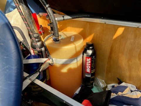

IBob Posted January 18, 2025 Posted January 18, 2025 Marty, at cruise, if I valve off all fuel to the receiver, the low fuel indicator comes on after 2.5minutes. That's about 0.7L. Which is to say it takes a fair sized bubble to give false alarms. But I have seen it in an unvented VG. 2
Blueadventures Posted January 18, 2025 Posted January 18, 2025 2 hours ago, IBob said: Marty, at cruise, if I valve off all fuel to the receiver, the low fuel indicator comes on after 2.5minutes. That's about 0.7L. Which is to say it takes a fair sized bubble to give false alarms. But I have seen it in an unvented VG. It comes on about 80mm down; I plan for 5 litres available. I can see mine where I have it in my Nynja. 3

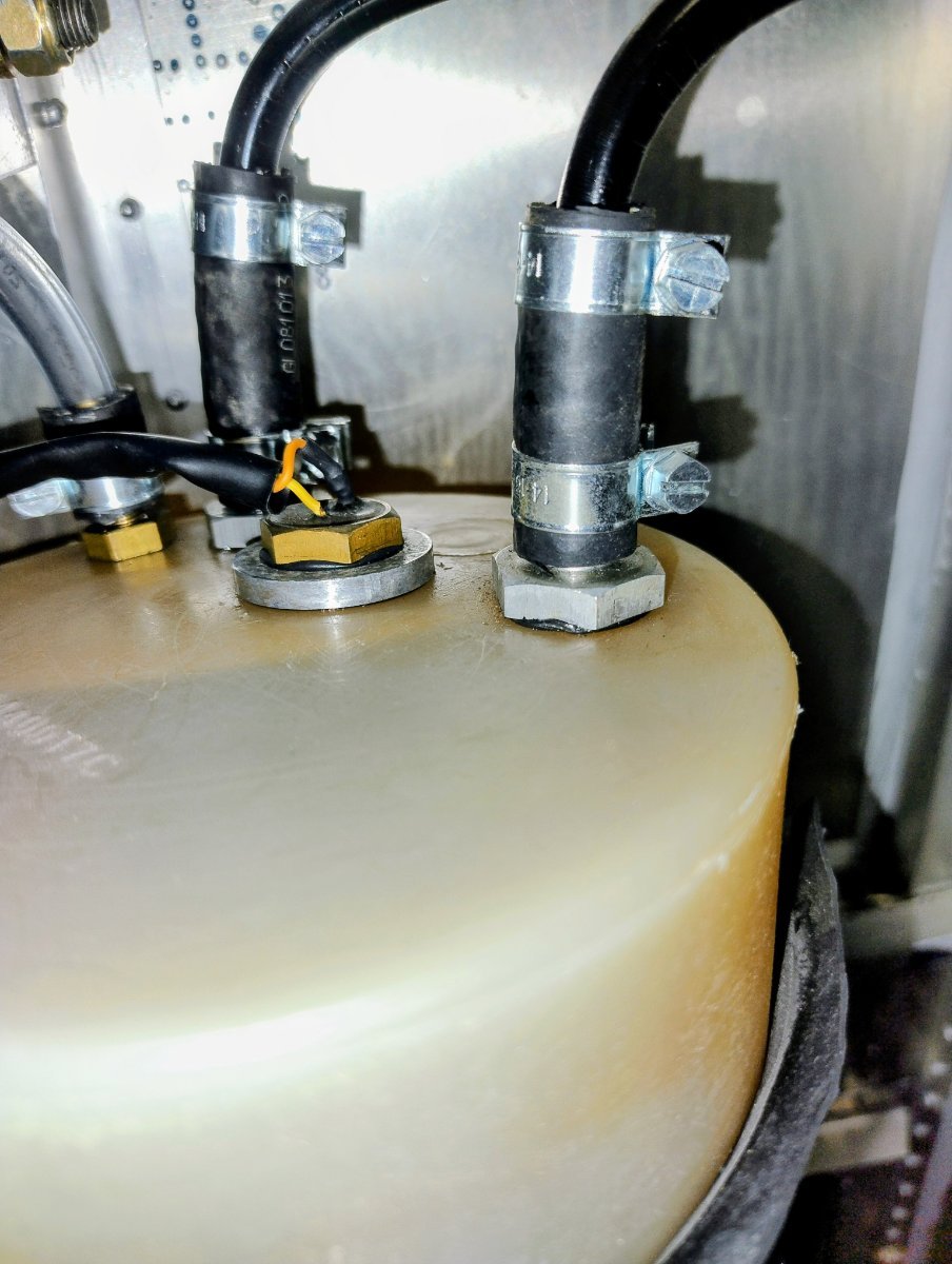

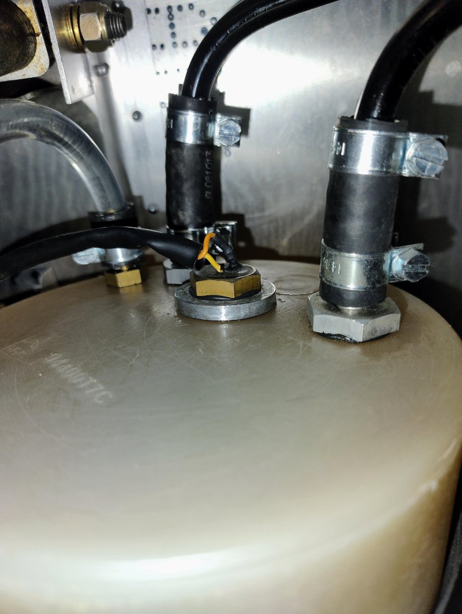

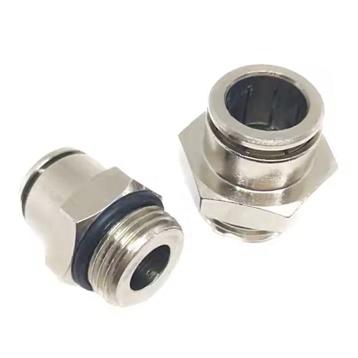

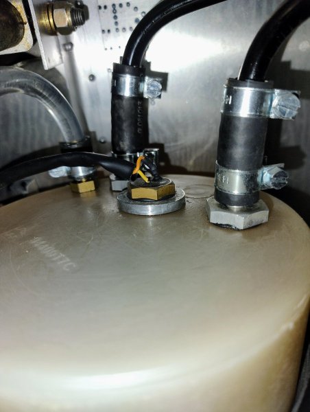

Blueadventures Posted January 18, 2025 Posted January 18, 2025 Marty was the 1/4" hose tail fitted to the collector tank when you got it or did you fit it yourself? 1
IBob Posted January 19, 2025 Posted January 19, 2025 2 hours ago, Blueadventures said: Marty was the 1/4" hose tail fitted to the collector tank when you got it or did you fit it yourself? I was wondering that too: the standard ICP unit comes with just 2 ports (plus the level switch) in the top, so far as I know. The VG model I have seen was built with each of those ports connected to one of the two wing tanks. To give venting they then brought both/all tanks into one port, and used the other for the vent line. 1
Marty_d Posted January 19, 2025 Author Posted January 19, 2025 5 hours ago, Blueadventures said: Marty was the 1/4" hose tail fitted to the collector tank when you got it or did you fit it yourself? It was already fitted. I got the tank 2nd hand from the Sav guy, so whoever had it before might have put it in. 1
IBob Posted January 19, 2025 Posted January 19, 2025 35 minutes ago, Marty_d said: It was already fitted. I got the tank 2nd hand from the Sav guy, so whoever had it before might have put it in. As I recall, the two main ports were threaded females that looked to be moulded into the tank, and the fittings that went into them had some sort of 'rubber' ring to make the seal. I wonder how that third port was fitted to make it fuel-tight? My tank developed seepage from from one of those tops ports, which wasn't evident initially. I had to pull the tank and trim some of the plastic round the fitting to get it to seal properly. May be worth keeping an eye on initially, Marty. 1
Moneybox Posted January 21, 2025 Posted January 21, 2025 (edited) Usually when a plastic tank is rotationally moulded to form a tank a brass cotton reel shaped nut is first bolted to the inside of the mould. That gives you a perfectly sealed brass thread into the tank. If you have to insert a new thread HDPE can be threaded but to get a good seal it pays to put a neat chamfer onto the outside of the hole. The chamfer can give a neat fitting O-ring onto a flanged brass fitting a good seat to seal. Edited January 21, 2025 by Moneybox 2 1
IBob Posted January 22, 2025 Posted January 22, 2025 12 hours ago, Moneybox said: Usually when a plastic tank is rotationally moulded to form a tank a brass cotton reel shaped nut is first bolted to the inside of the mould. That gives you a perfectly sealed brass thread into the tank. If you have to insert a new thread HDPE can be threaded but to get a good seal it pays to put a neat chamfer onto the outside of the hole. The chamfer can give a neat fitting O-ring onto a flanged brass fitting a good seat to seal. Moneybox, as I recall the fittings in my tank are as you describe: threaded brass 'nuts', moulded in. 1
IBob Posted January 22, 2025 Posted January 22, 2025 My tank seepage was a bit scary: No signs of it during initial ground runs or test flights. But shortly after someone said I had a damp patch under, and when I popped the belly hatch the entire outer walls of the tank were damp and shiny: fuel making it's way down the outside. And quite probably an explosive fuel/air mixture in the confined space of the rear fuselage.............( 1
facthunter Posted January 22, 2025 Posted January 22, 2025 I'd be keeping an eye on all this stuff. Any "0" ring must not be able to slip out of it's groove. How long does that PLASTIC last? Does it get brittle.? Nev
