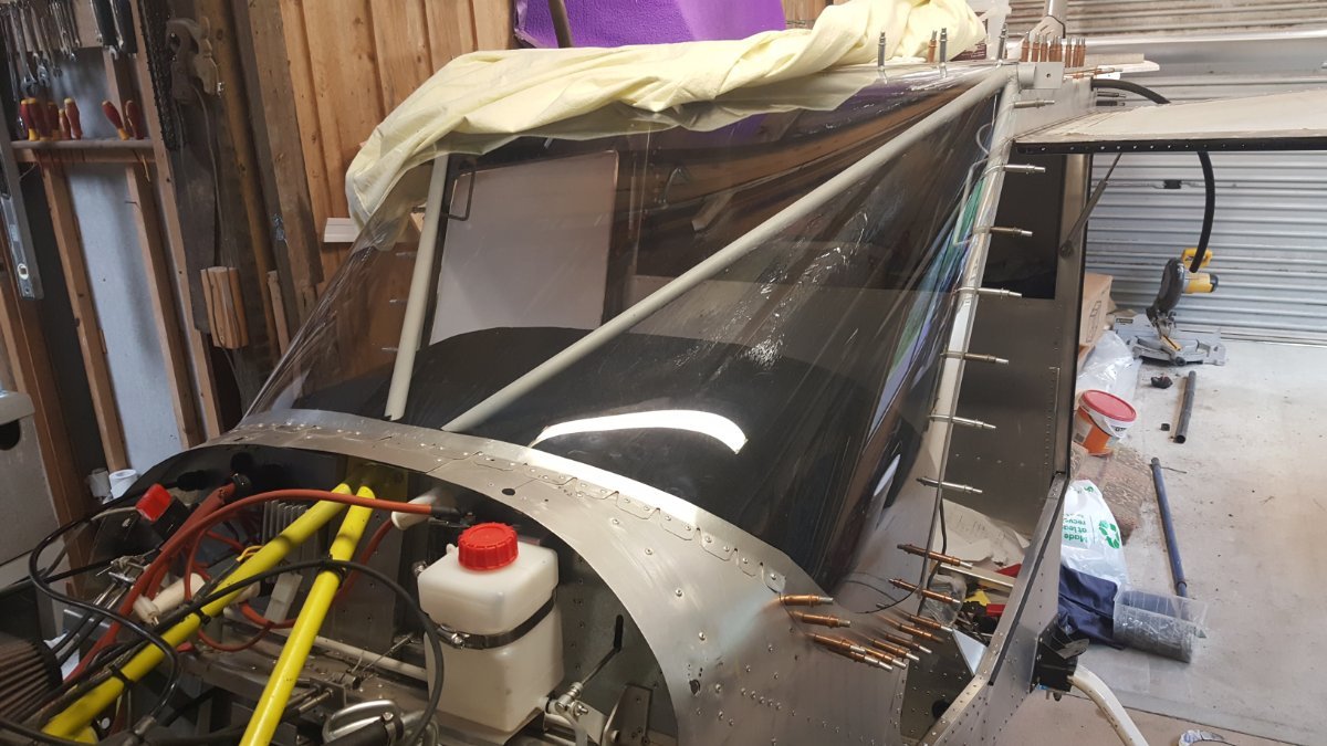

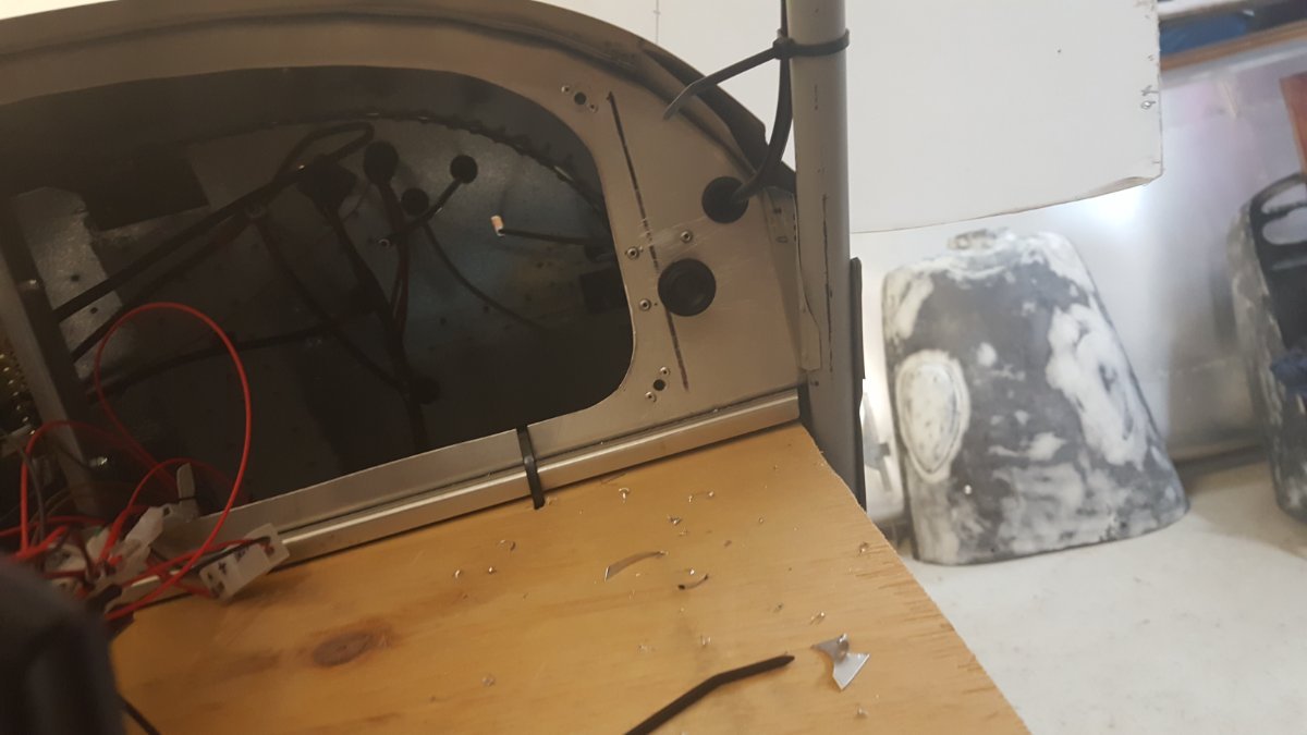

Old Koreelah Posted June 25, 2023 Posted June 25, 2023 Looking good Marty. Bluddy cowl is the most finicky part of a build and a bit like putting skin tight jeans on a supermodel (not that I’ve had that pleasure). I leaned the hard way to allow a bit of clearance for future additions. 1

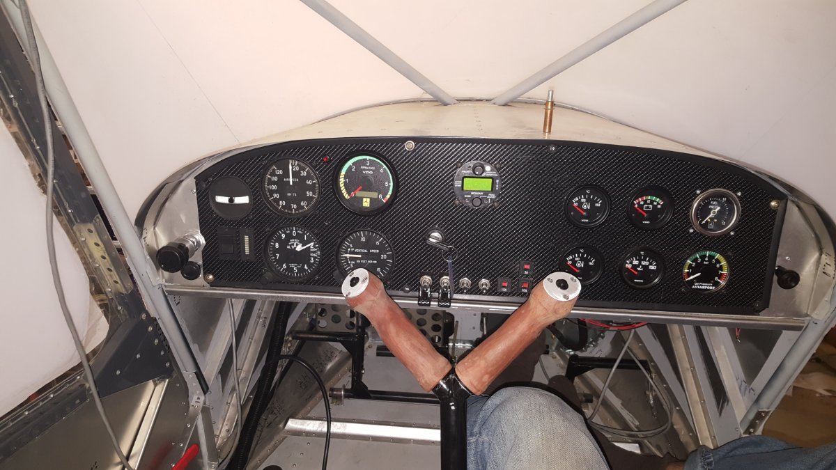

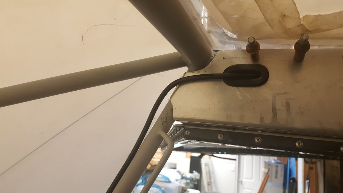

Marty_d Posted June 25, 2023 Author Posted June 25, 2023 Last weekend I carved another wooden grip so have the matched pair now. Pulled through the cables @nomadpete made up for the PTT's and put the stick back on. Kate reckons it looks like an alien' s eye stalks now... 6
Kyle Communications Posted June 26, 2023 Posted June 26, 2023 On 25/06/2023 at 11:39 AM, Old Koreelah said: Looking good Marty. Bluddy cowl is the most finicky part of a build and a bit like putting skin tight jeans on a supermodel (not that I’ve had that pleasure). I leaned the hard way to allow a bit of clearance for future additions. Doing the modified cowl for Mabel was a friggin nightmare......I have a new most hated job now 2 1
facthunter Posted June 26, 2023 Posted June 26, 2023 Pity we can't get nice little radials. They only need a Townend Ring. Nev 1 1 1
Marty_d Posted June 26, 2023 Author Posted June 26, 2023 You're right there @Kyle Communications and @Old Koreelah. Fibreglass (carbon fibre is worse) is messy, sticky, smelly and dangerous. Full face 3M filter mask and nitrile gloves to lay up, cut and sand CF. Compare this to aluminium - clean, nice to work with, and won't kill you unless you open an artery on a sharp bit. Complex curves are a bit of a problem though. So yes - if it came to a choice between fibreglassing and getting those jeans on/off a supermodel, pass the baby powder. 1 2

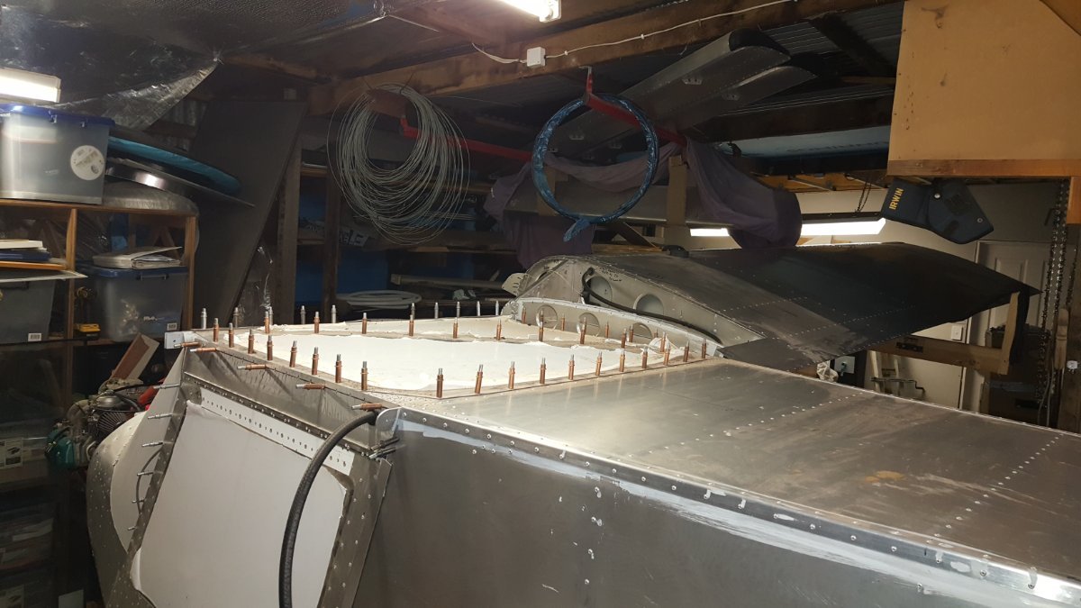

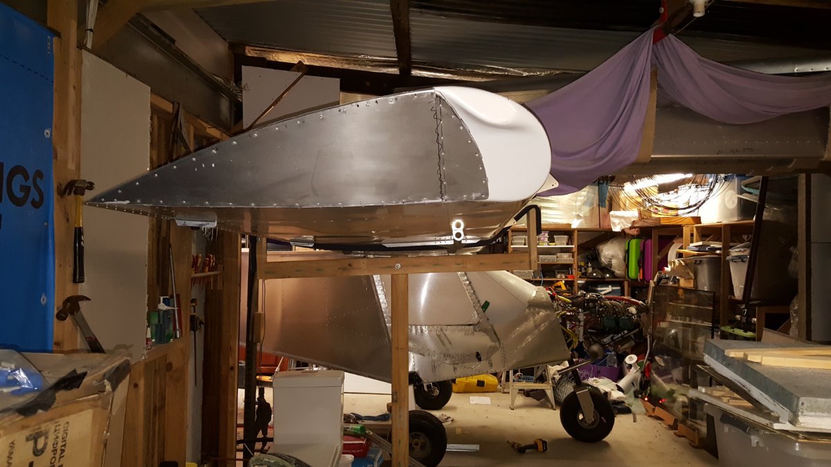

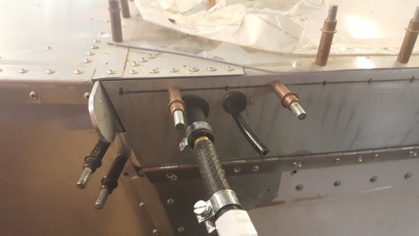

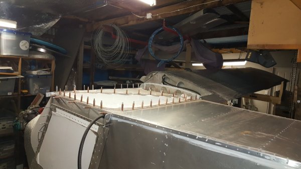

Marty_d Posted July 9, 2023 Author Posted July 9, 2023 (edited) Big day today - for the first time a wing was put in position! Very relieved to find that the mounting surfaces meet neatly. I finished the fuel line on that wing then removed it again, would have been difficult to get to the loo with it in position. Edited July 9, 2023 by Marty_d 5 4

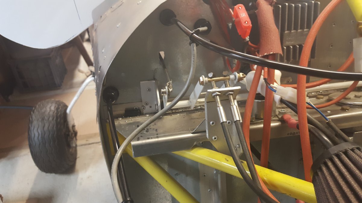

Marty_d Posted September 16, 2023 Author Posted September 16, 2023 Bit by bit I've been ordering bits from evilbay and putting together the fuel system. Manifold has the limiters tapped and loctited in the rear two outlets, starboard is return line to wing tank, 1/4 ally line going thru gland in the firewall, thru corner of dash, up beside the cabin tube and into the sill above the door and thence out to a quick release to the wing tank. Port tune snakes around and thru the firewall above the passenger throttle rod, I have a barb fitted to the gauge so short rubber connection there too. 1/4 rubber lines are sheathed in fireproof cover, I have a bit left over so will cover as much as I can of the return / pressure gauge lines too when the next shipment of hose clamps arrives. 6 1

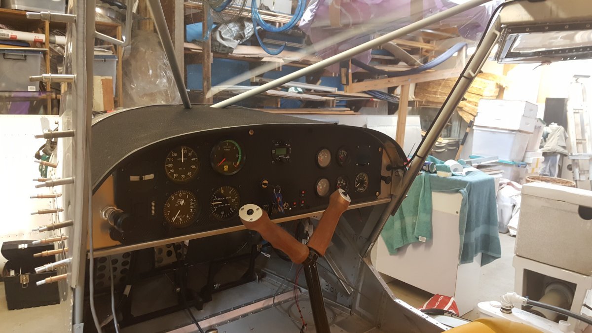

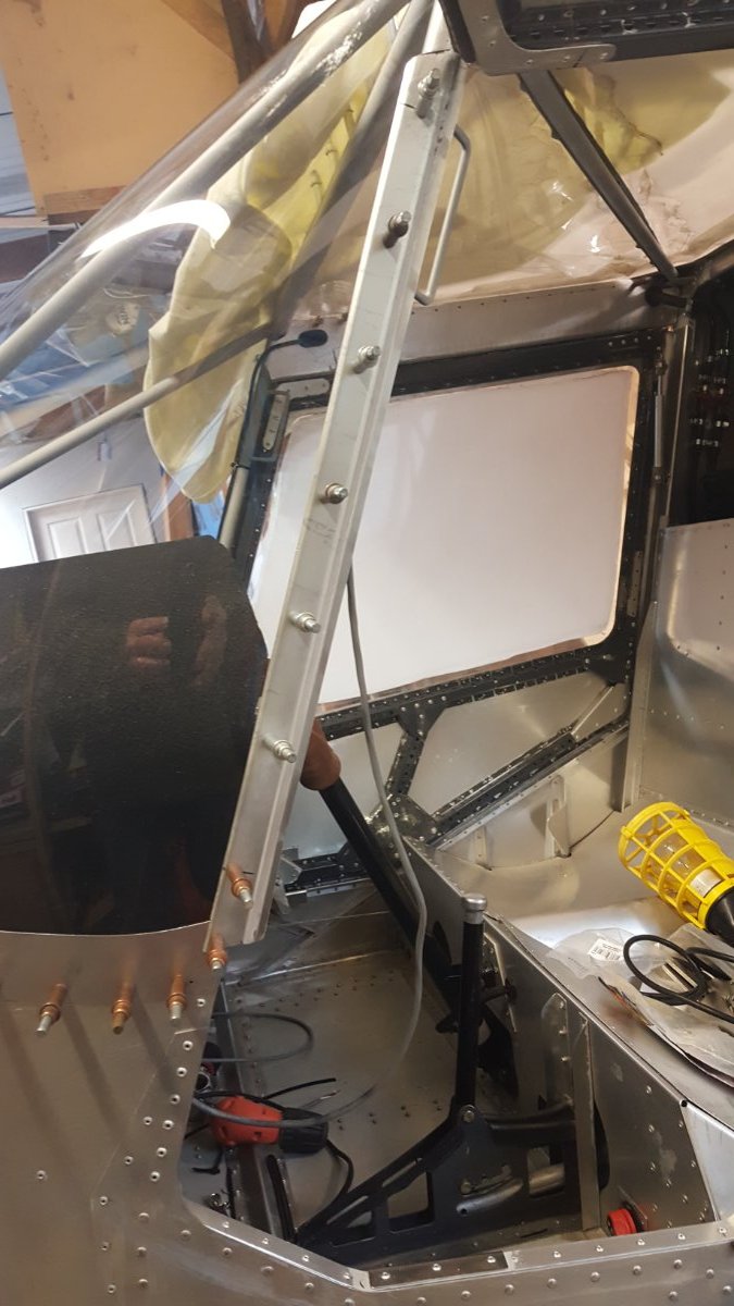

Marty_d Posted October 21, 2023 Author Posted October 21, 2023 I mucked around a bit and worked out how to seat the front of the door properly, and also seat the bottom sides of the windscreen. For the door, a Z-profile bit of 0.025" does the trick, providing a narrow sill for the front to go into. I've put a small self-adhering rubber along the inside of the door, with holes cut where it goes over the rivets, and the door is pretty tight so I'm hoping it's fume-proof to some extent. For the lower sides of the windscreen, a flat piece of 0.016" cut to shape is riveted to the fuse below the edge of the windscreen. This has turned out quite neat so I don't know that I'll even need rubber. I've also test fitted some black felt above the dash, still need to trim then stick it on with spray adhesive before riveting & screwing the windscreen into place. Ripped off the protective plastic too - for the first time I can sit inside the plane and look out through the screen, I really need the internal windscreen wipers for the "brrrrrr" noises now... 4

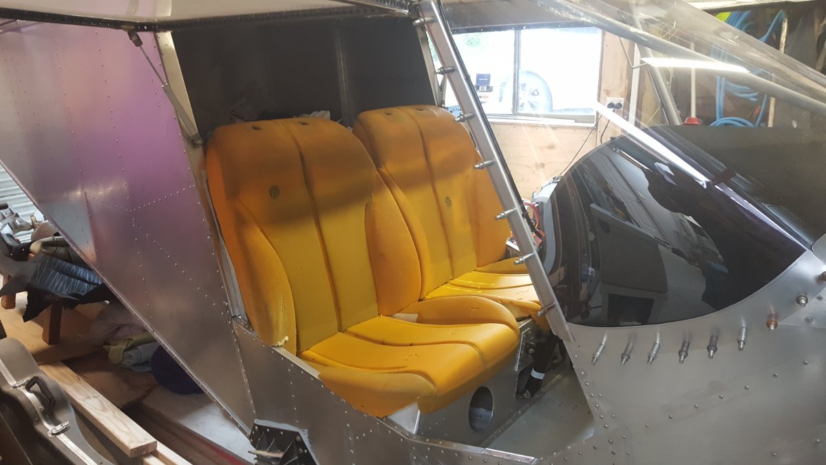

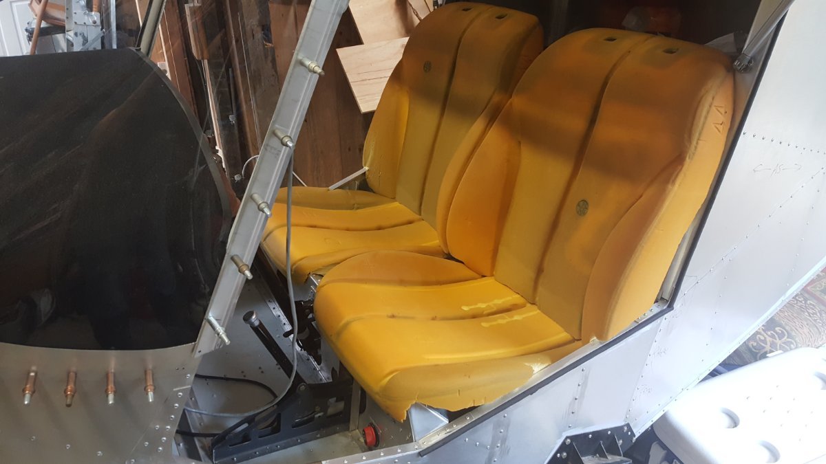

Marty_d Posted November 19, 2023 Author Posted November 19, 2023 I've done a few things in the last couple of weeks. Bought some hose clamps (thanks @skippydiesel for the Icon 35 advice, they fit perfectly) so the cooling system is now all hooked up. Started thinking about seat cushions and seatbelts. I picked up a couple of front seats from a written off Mazda 2, removed the frames and covers and went to work with a breadknife. Quite happy with the result both look and feel, so now "just" a matter of re-covering. Shouldn't be impossible as I have the original covers as a pattern. There's a couple of rips in those and they're a bit boring in colour so I can't really reuse them. Also glued on the felt cover over the top of the dash, looks nice and neat now. 4
