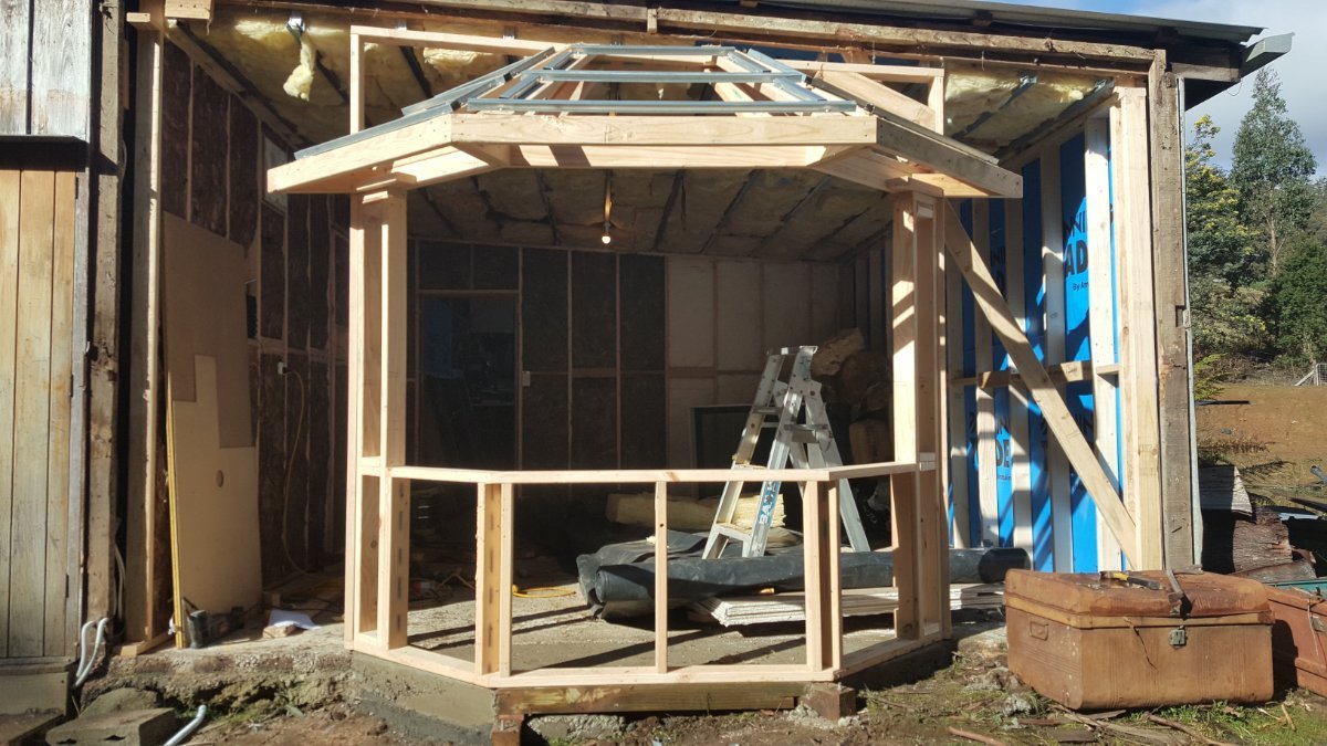

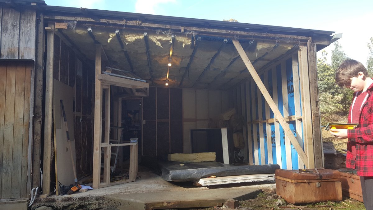

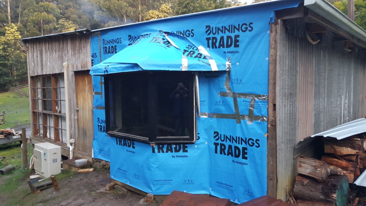

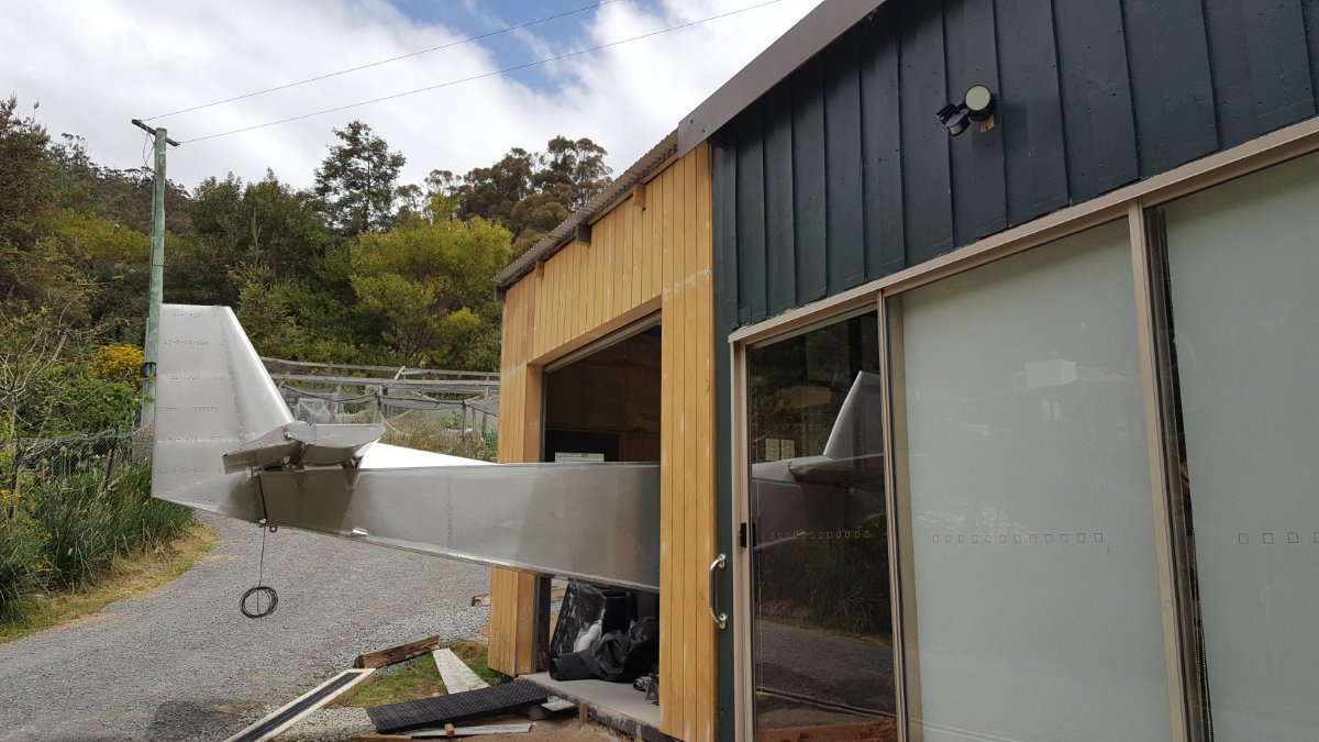

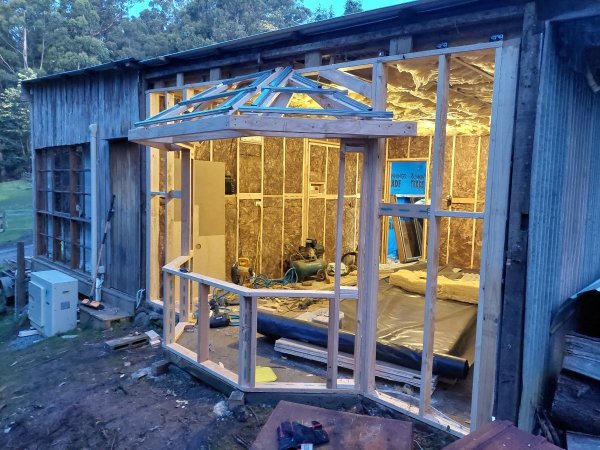

So while this is not exactly a plane update, it is a shed update which involves the plane, 'cos I can't move the plane until I finish the shed and I can't really work on the plane until I move it.
Started the weekend at 6am Saturday, by 8am I had the entire end wall removed, by 9:30 I had the new bay window section in (I had pre-built that over the last few weeks), by the end of Saturday the wall was framed up and mostly rough-sarked to protect the inside from any rain.  Today I put the foil on properly and taped the joins then placed the window and screwed the reveal to the frame.
Still have to fill and properly seal around the window, then I can put the little roof over the top (got the material for that), then batten out over the sarking and put on the EcoPly cladding.
Photos tell the story...

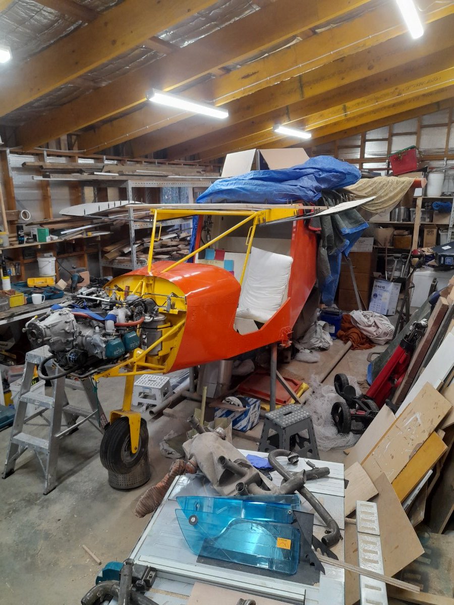

With the shedroom finished (we moved in Boxing day) I've been clearing out stuff in the rest of the shed.
Today with the help of my 12yo son, we performed a 60-point turn with the plane (along with some sideways lifting) to get it around the corner in the L shaped space.
She's now backed up to the roller door and today for the first time,  her shapely behind got some sun! 😁

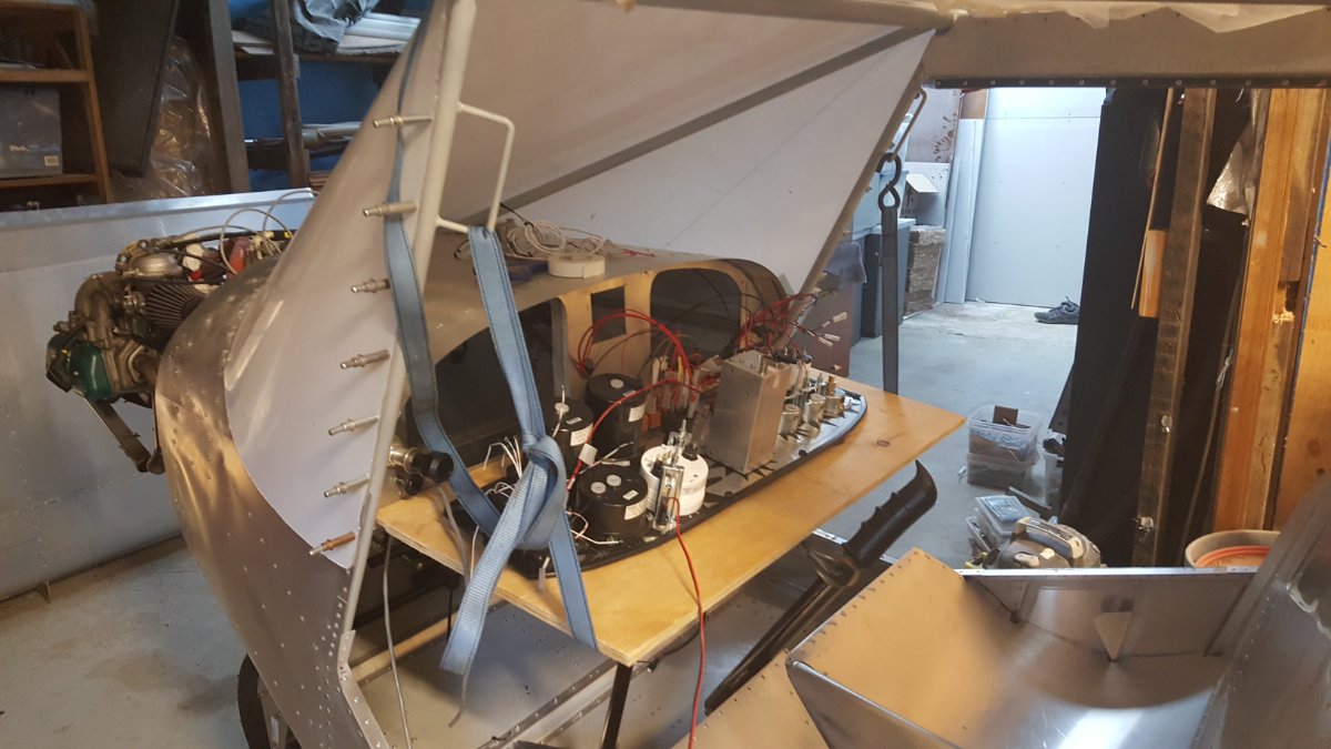

Massive "Thank you!" today to @nomadpete who generously offered his time and expertise.  He spent the afternoon working out my instrument panel wiring.  Still a bit to go but a lot further than I would have got on my own.
Really appreciate the help Peter!
  • Winner 2
Are you labelling?  One method is write label on strip of paper with fine pencil (biro ink fades) and use clear heat shrink to attach to wire.   I kept a sheet of paper, scissors and a very sharp pencil handy and wrote labels for wires, sometimes at both ends to enable later tracing.
The wiring loom was premade. It already has labels on the wires, but since it was premade for a different aircraft, mods must be made to suit a different layout, and some different items. It is messy at the moment, but eventually will be neat and secure.
The loom came with a set of steam instruments I bought. They'd come with a Savanah kit but the owner wanted a glass panel.

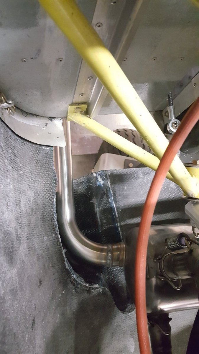

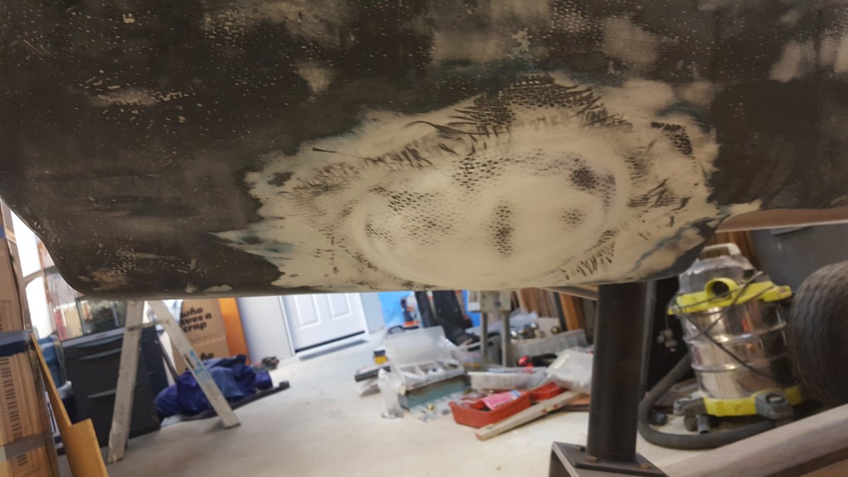

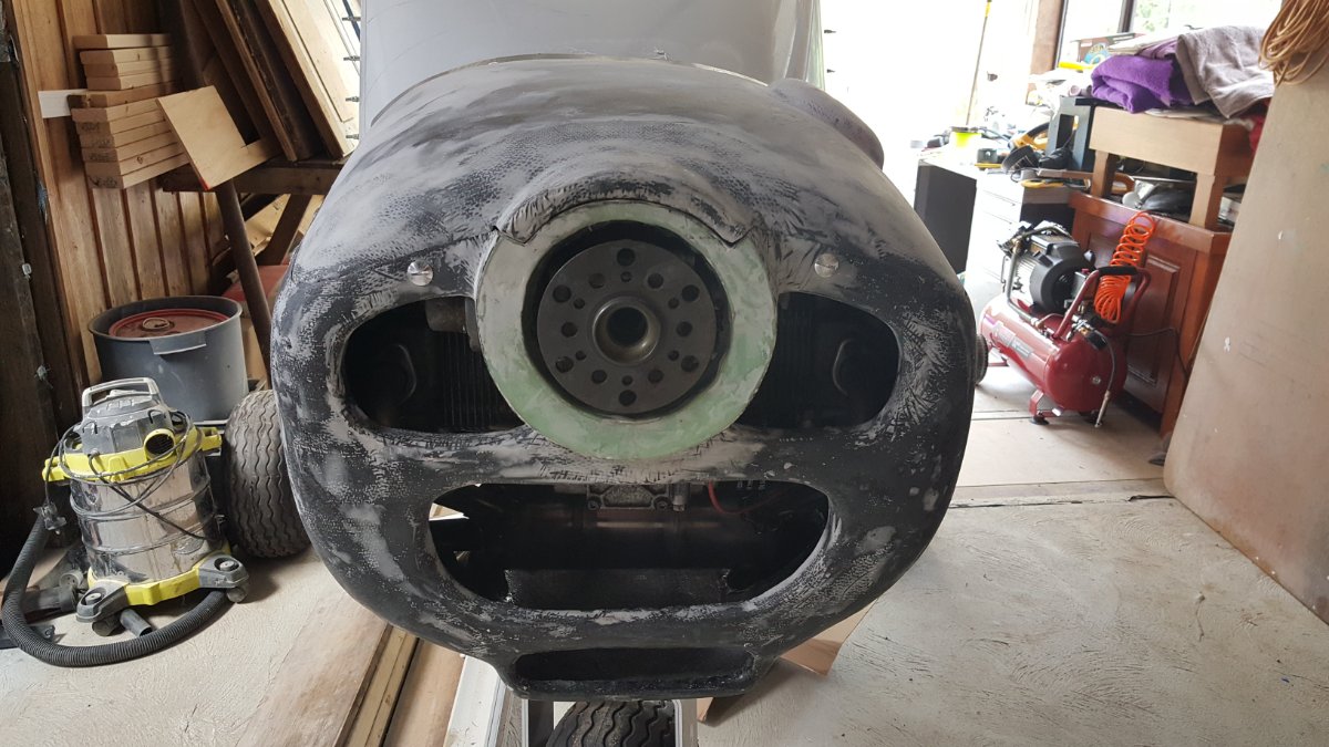

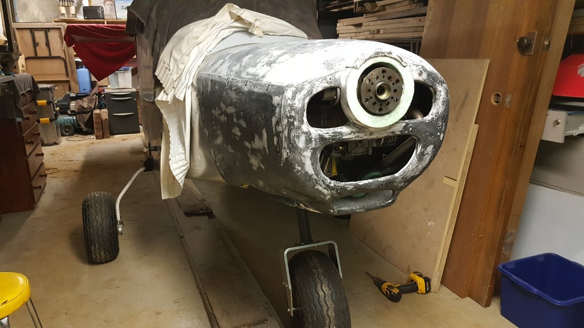

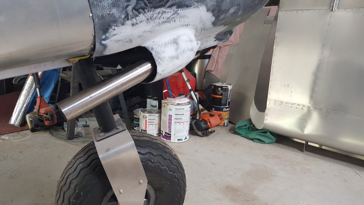

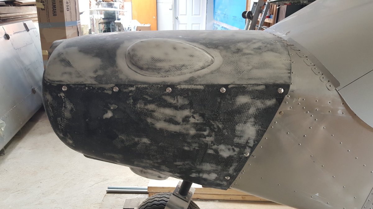

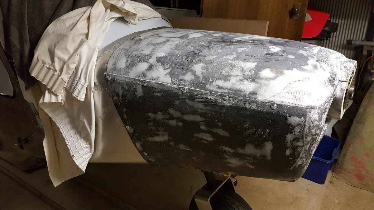

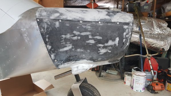

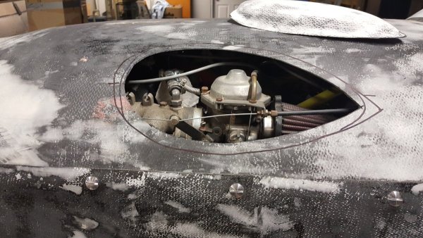

In the last week of my holidays I got a bit of fibreglassing done.  Think I've finished now (although there's always that last little divot you don't see)...
So the bits I needed to add were:
- Top cowl:
a blister to give the port side carby and throttle body a bit of room, throttle was binding on the cowl.  This is because the engine is offset 3 degrees so the back end of it is closer to the cowl on the port side.
- Bottom cowl:
- a shaped outlet which follows the curve of the exhaust pipe from the muffler
- a blister on the opposite side to accommodate the other side of the muffler.
  • Like 5
You scared me there Planey, I went and checked. It's not a ding, just the rivet line in the skin.  Camera makes it look worse than it is.

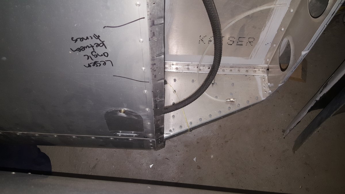

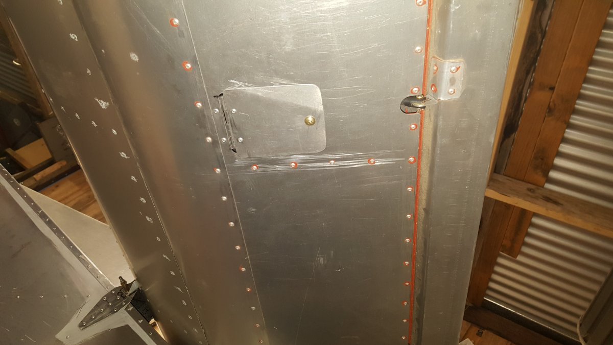

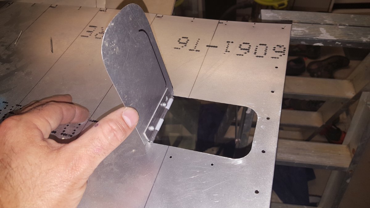

Little doors!  I've been building inspection hatches.  4 so far, with a few to go.
Two are on the wing roots, near the trailing edge, to access the fuel quick-release attachments.  Top of the wing to access where the fuel return hits the tank, and lastly bottom of the elevator to access the trim tab servo.
I found the rest of the aluminium piano hinge I used for the doors, so I figured the easiest and lightest way to do the hatches is hinge at the upwind end and single nutplate at the downwind.
Edited by Marty_d
  • Like 5
Neat work Marty.
If security is an issue, is it possible to install a long pin to lock those inspection doors shut? A section of piano hinge can serve as a secure latch, with the release pin accessible from somewhere inside your (lockable) cabin.
