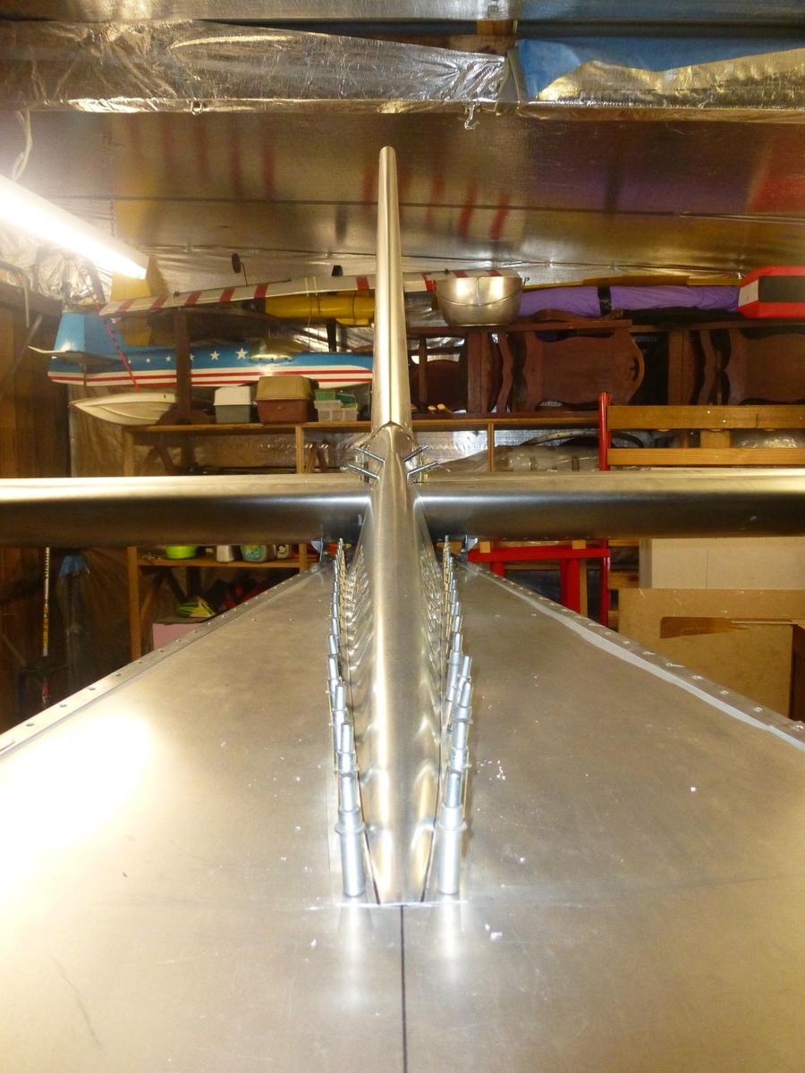

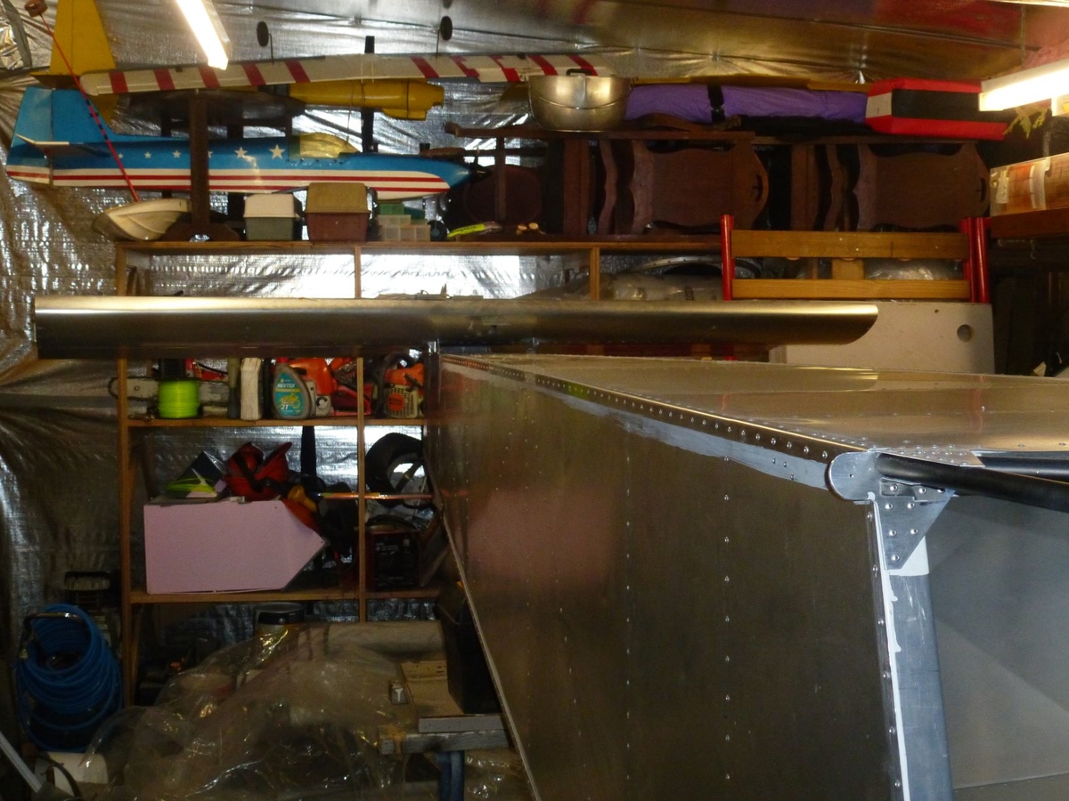

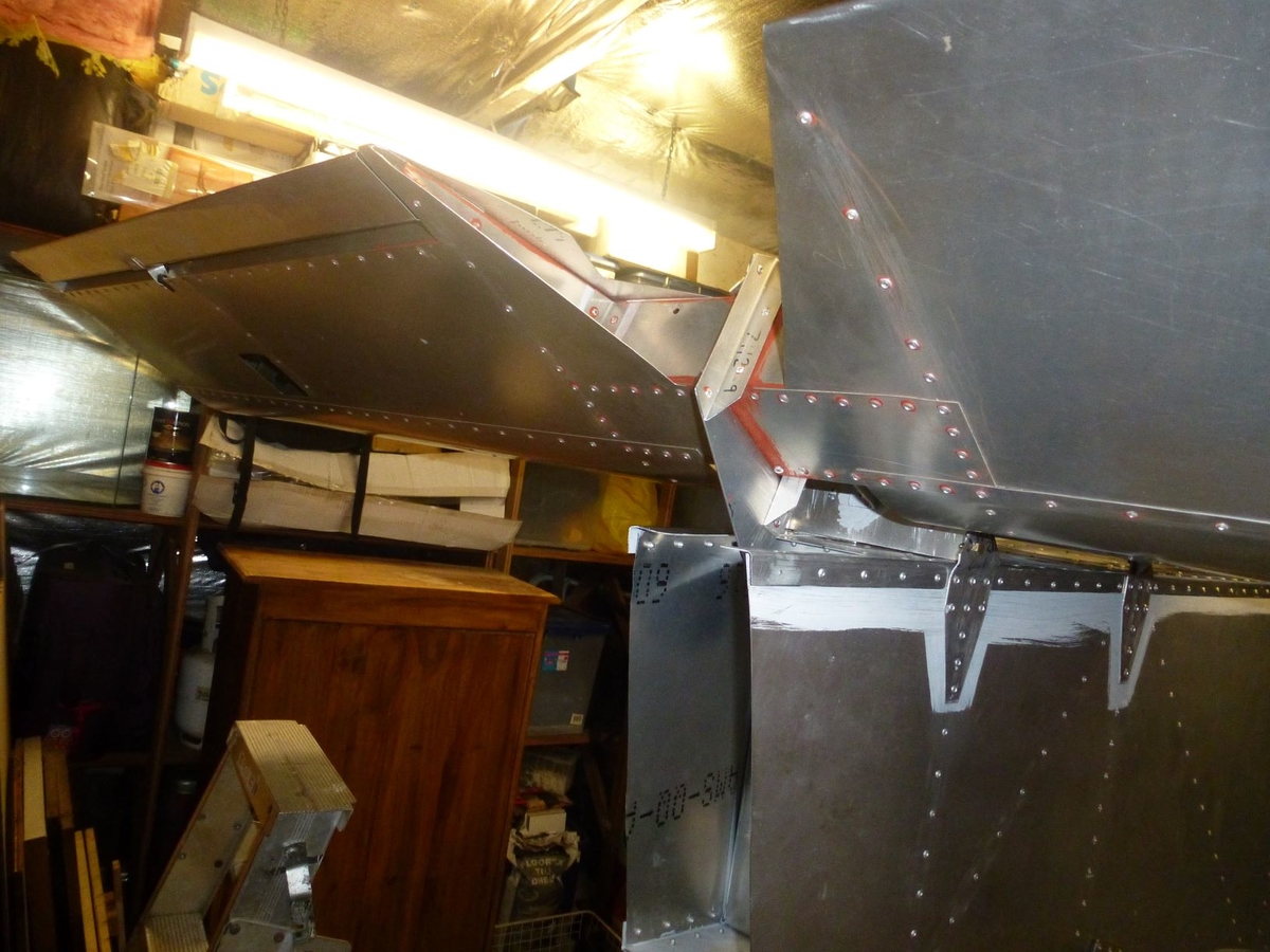

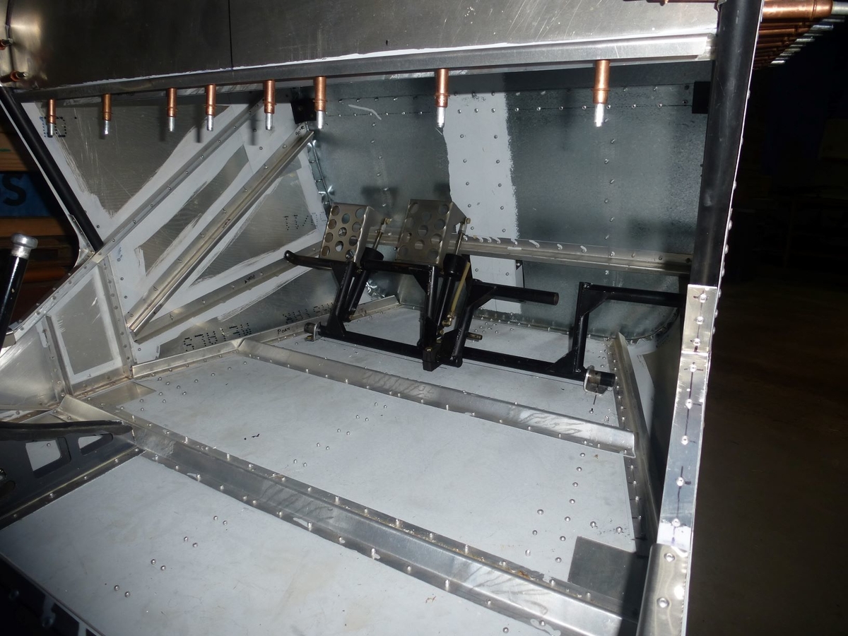

Marty_d Posted November 18, 2018 Author Posted November 18, 2018 Had a chance to do a bit on the plane this weekend, so got stuck into mounting the rudder pedals and bolted the horizontal tail on for the first time. 1

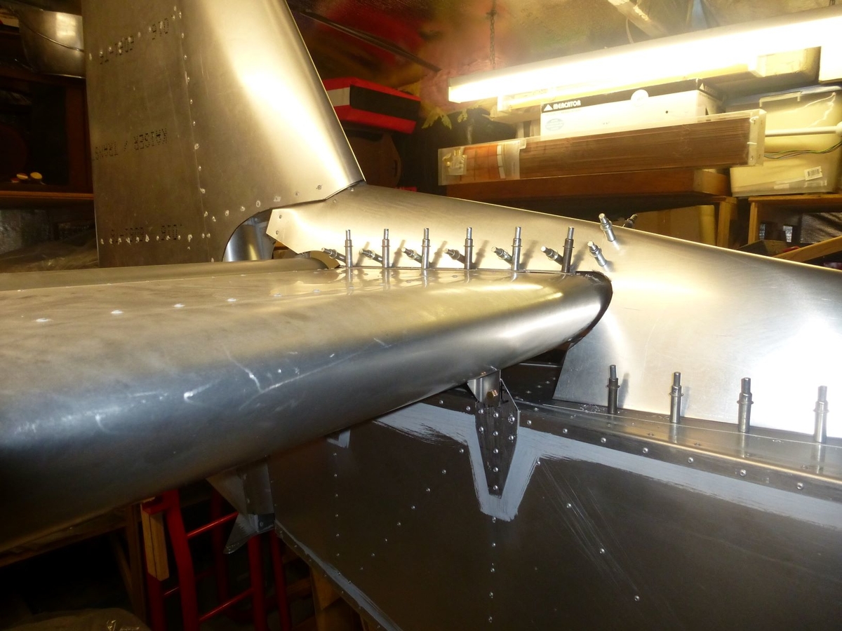

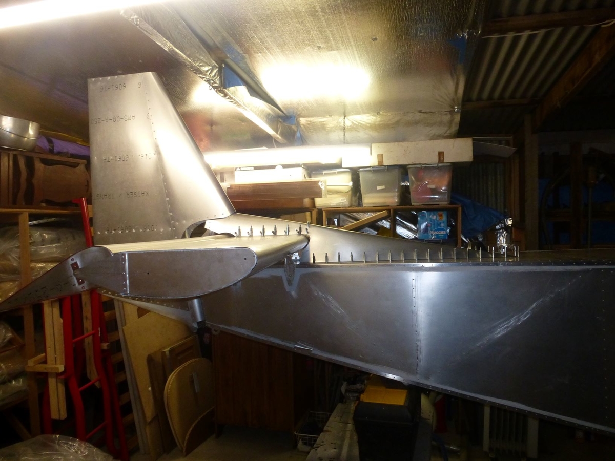

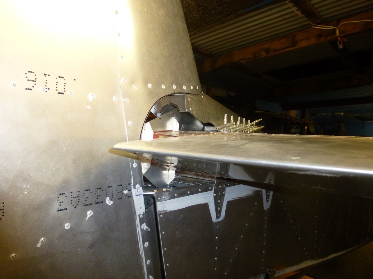

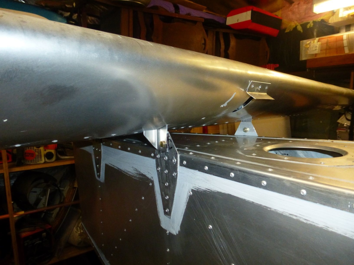

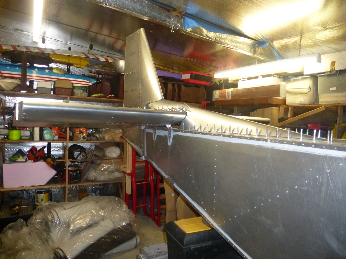

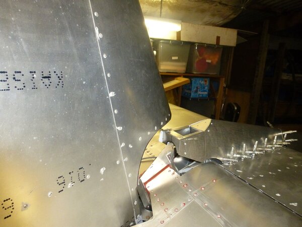

Marty_d Posted December 3, 2018 Author Posted December 3, 2018 Further work on the "south end"... mounted the rudder, fabricated and clecoed the fixed fin. Won't rivet that until the elevator cables are run but will fully prep it. 2

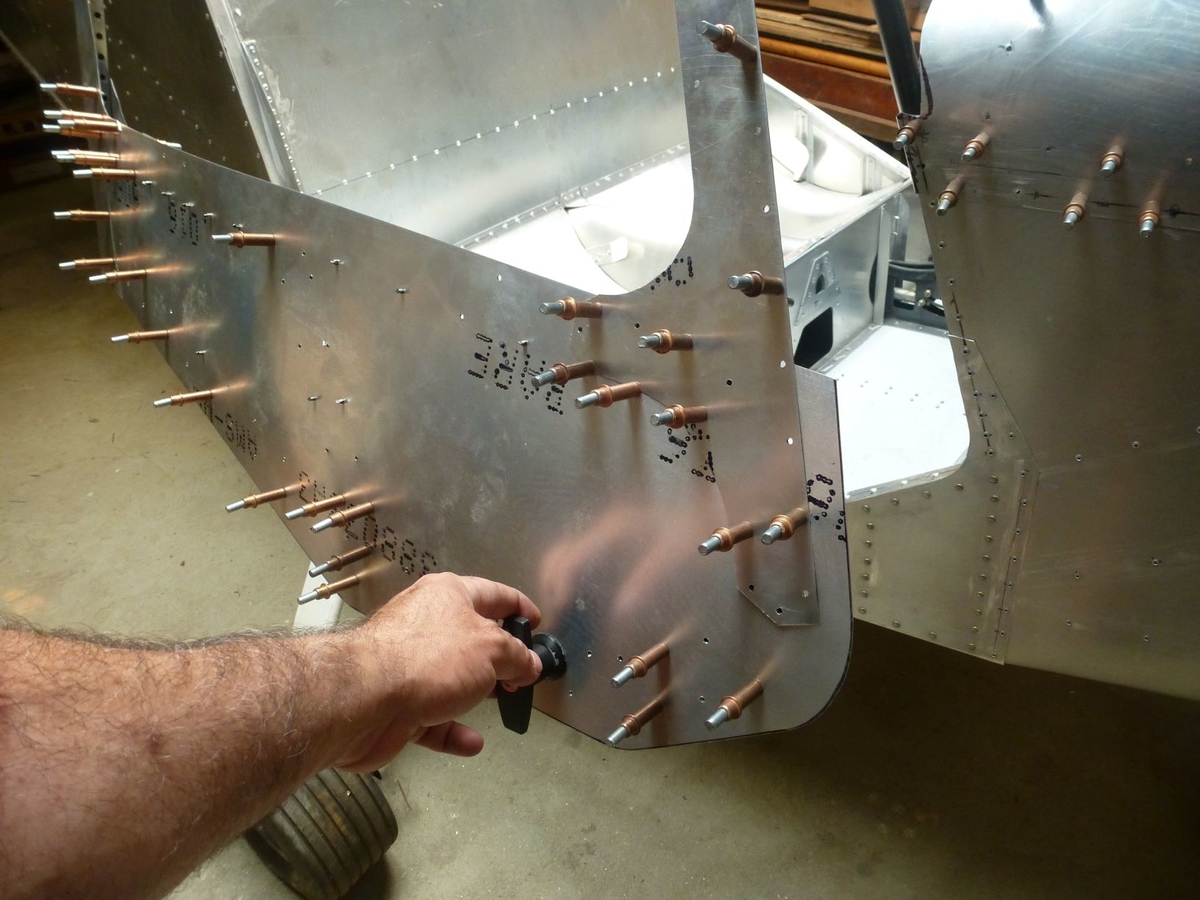

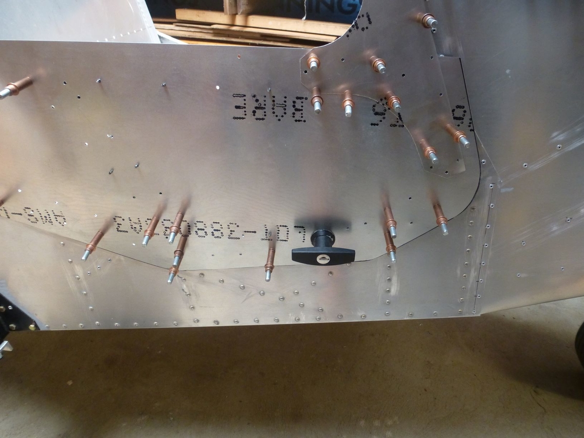

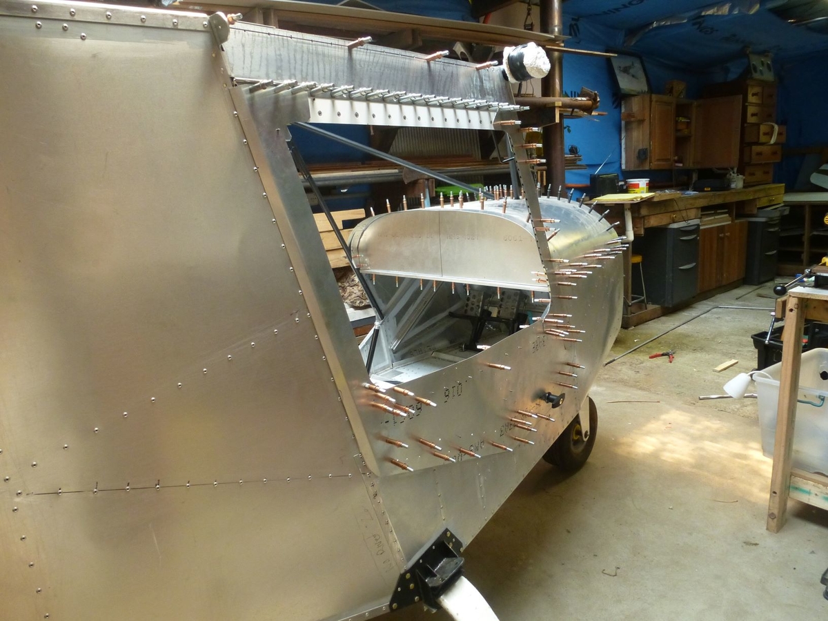

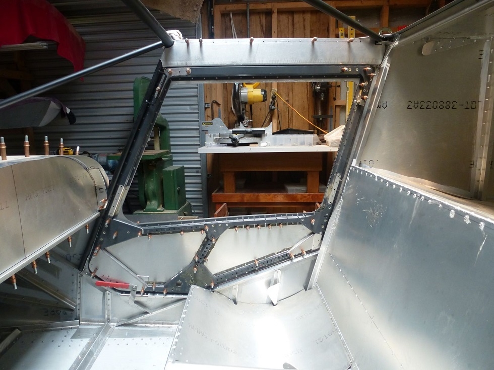

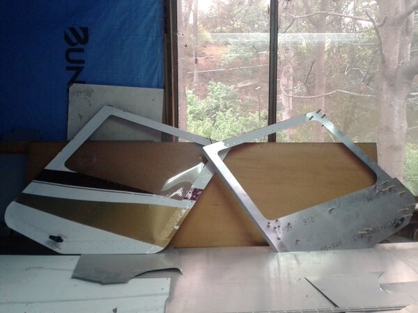

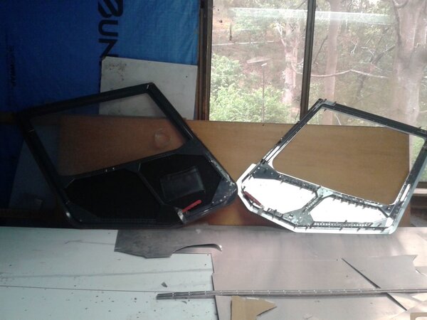

Marty_d Posted January 4, 2019 Author Posted January 4, 2019 Got some work on the doors done today. I have a pair of Savannah doors but unfortunately they're the wrong size, so I'm drilling out the rivets and using the perforated channel on doors I'm making from scratch. Photos below shows an original Sav door compared to my home built one. Subsequent photos show the door fitted to the fuse. Question - the plan just calls for the single interior handle. I reckon that's a bit risky. Would I be better adding two more holding points (but then there's 3 spots on each door you need to open in order to get out - not great in an emergency) - or try to incorporate all of them with bell cranks and rods from the 1 handle? Any experiences or advice?
