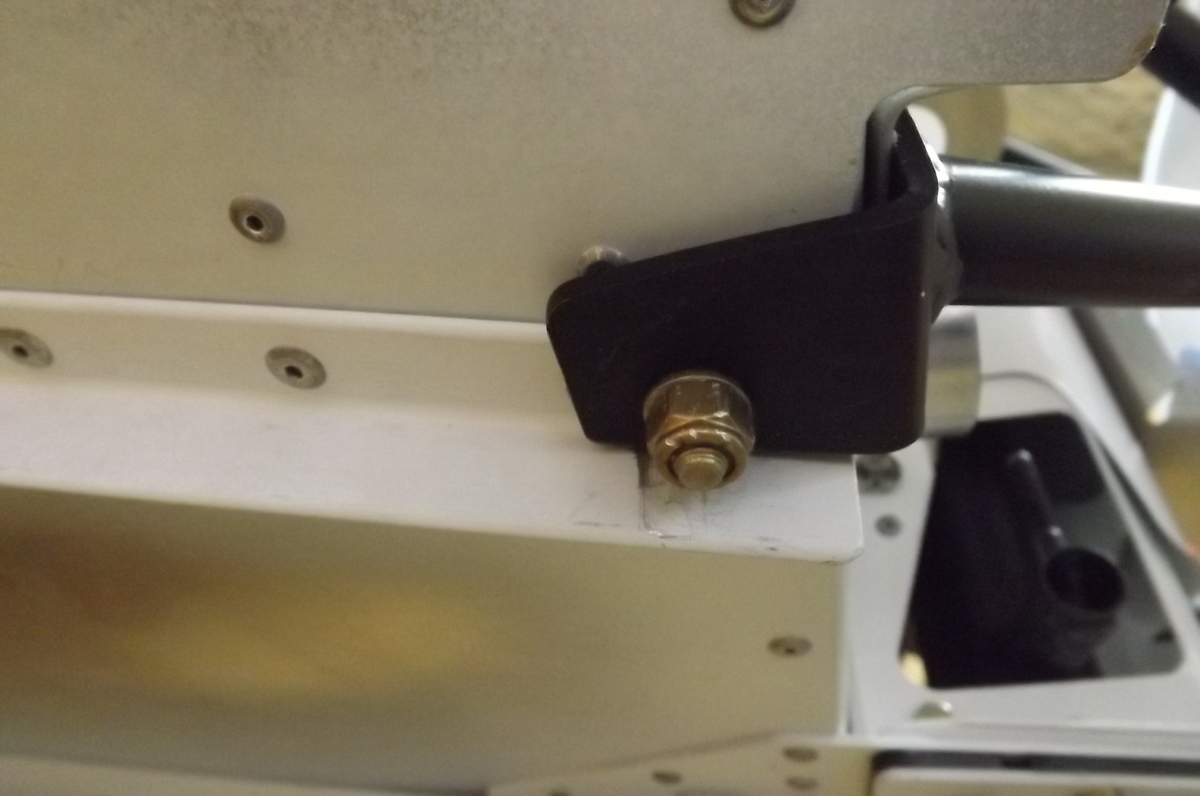

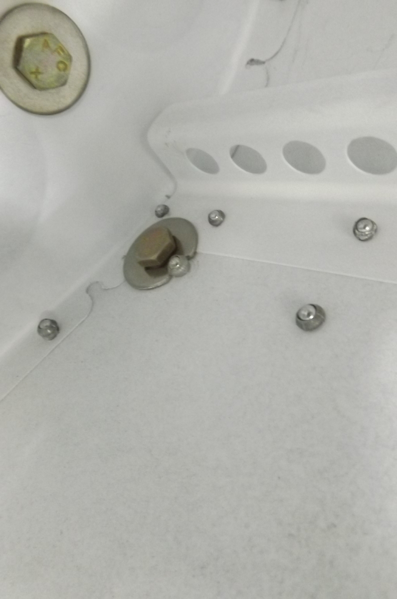

IBob Posted November 14, 2018 Posted November 14, 2018 Came across detail of fastening of bottom engine mount, outside and in, though you probably already got the idea: 1

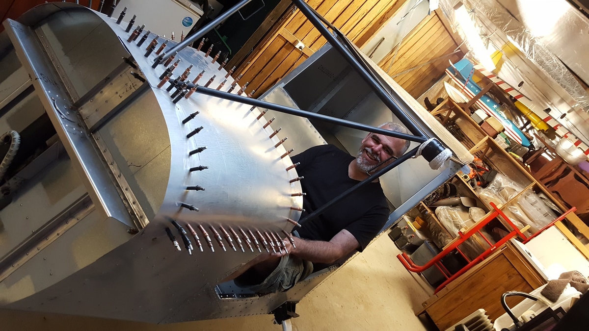

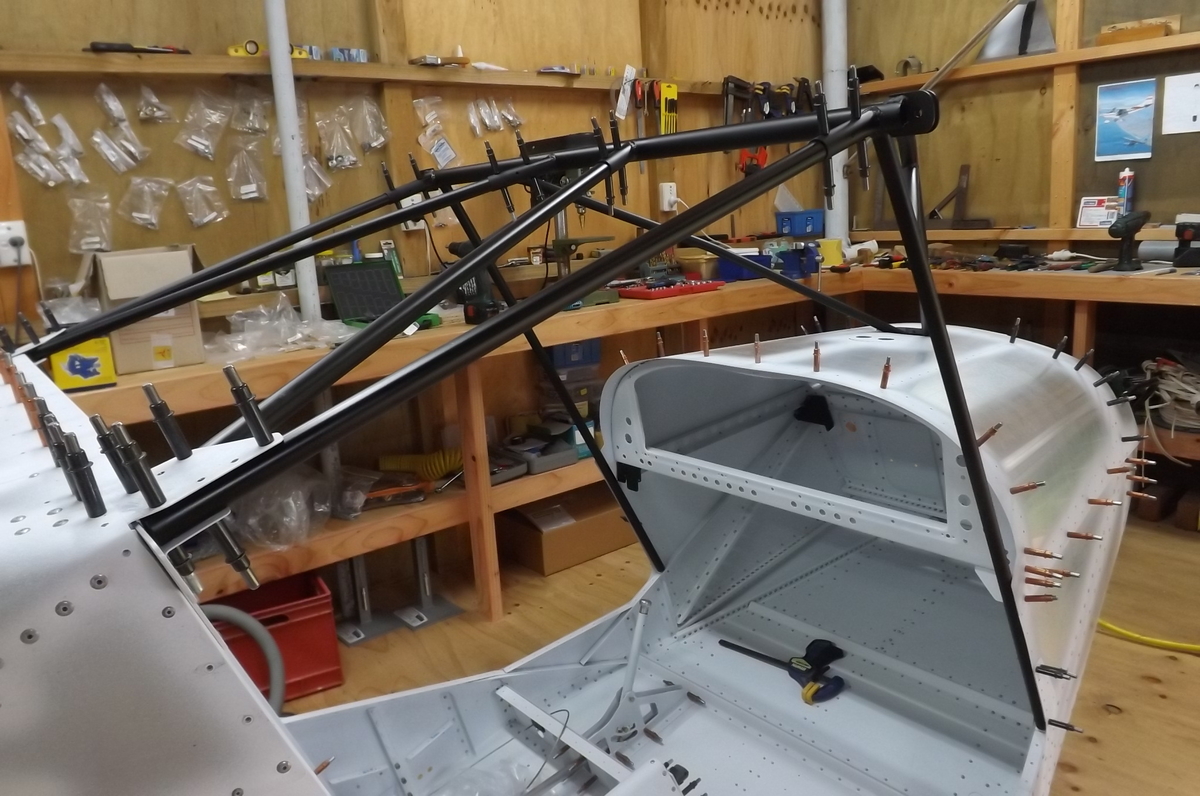

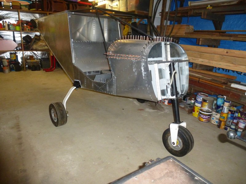

Marty_d Posted November 14, 2018 Author Posted November 14, 2018 Seats done! Got to sit in the plane today for the first time (yes I may have made a "vroom" sound...) I was pleasantly surprised by the headroom on the pilot's side, although the diagonal tube goes straight over the passenger's head so tall ones should strap in tight! 4
eightyknots Posted November 14, 2018 Posted November 14, 2018 ...the ear-to-ear smile says it all! ? 1
IBob Posted November 14, 2018 Posted November 14, 2018 Excellent! The Sav uses a double diagonal, but would probably still be overhead. I'll find out if I ever get through this painting... 1

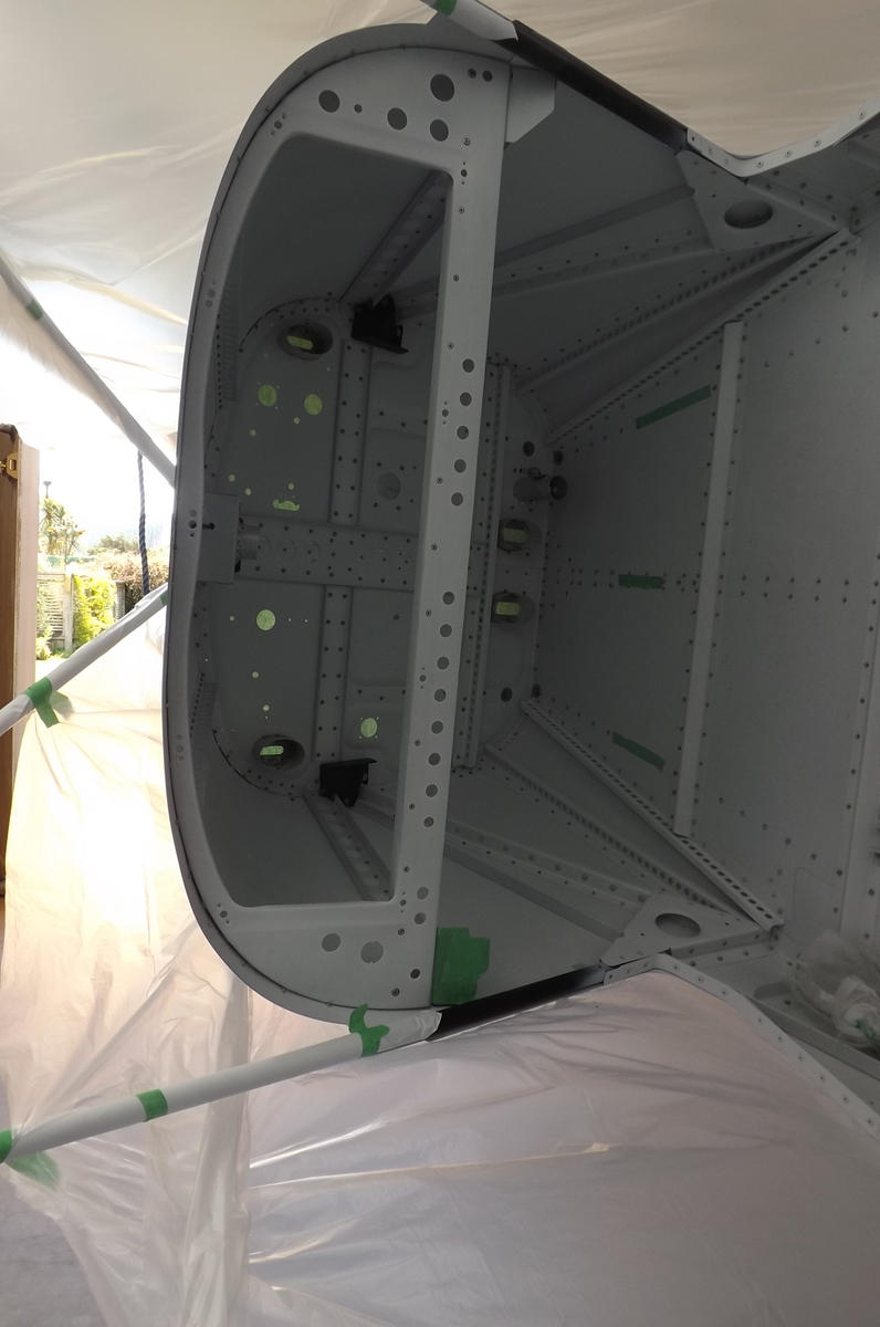

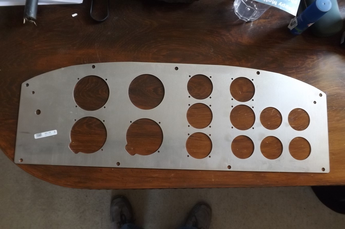

Marty_d Posted November 15, 2018 Author Posted November 15, 2018 I like your removable instrument panel Bob - is that standard or a modification?

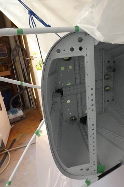

IBob Posted November 15, 2018 Posted November 15, 2018 That's standard, Marty, or was end of 2014 when my kit was boxed. It's all extra weight and bits, but probably takes a lot of the pain out of assembling the panel. As for the panel layout, there are endless opinions on that. As a relative novice (and something of a luddite) I'm quite happy with the steam gauges for starters. I will probably cut a hole on the left and put my slip indicator there, so that and the airspeed are right under my nose. I'm waiting for the day to cool a bit before more painting. It continues to be quite a challenge.......... 1
IBob Posted November 15, 2018 Posted November 15, 2018 That panel frame is fairly rigid, it's pressed with a sort of rolled edge, on both the outer and inner edges. I guess it would have to be to hold the shape of the coaming (?) until the panel goes in.
Marty_d Posted November 15, 2018 Author Posted November 15, 2018 That panel frame is fairly rigid, it's pressed with a sort of rolled edge, on both the outer and inner edges. I guess it would have to be to hold the shape of the coaming (?) until the panel goes in. Yes, that's where the 701 differs- it's just a single piece bent over with relief flanges. You're supposed to leave the top coaming un-riveted so you can remove the panel while you get all your instruments in, then rivet it all together. By the way I like your item no. 7 - "Hot hair to airbox"... shouldn't it be "Hot hair to hairbox"?
