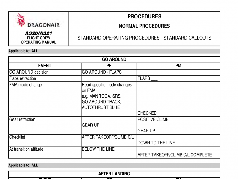

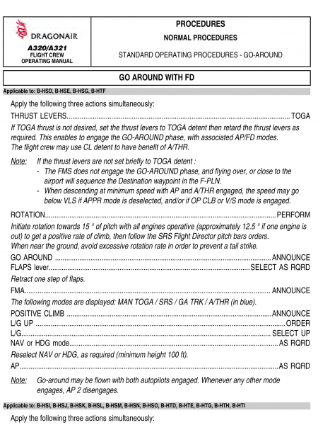

Don't know about the Boeing but on the Bus the standard calls for a go around attached.
Similar principle.

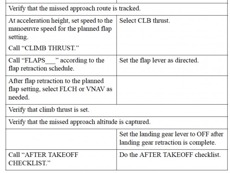

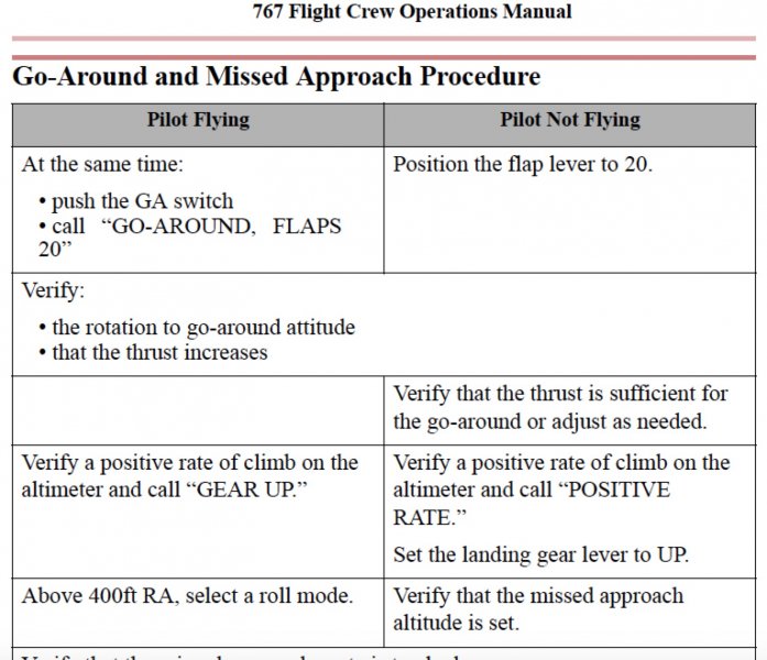

Standard go-around for a B767 (which would be almost the same for a B777 except the "go-around switch" is called a "TOGA switch")
First:
Then:
