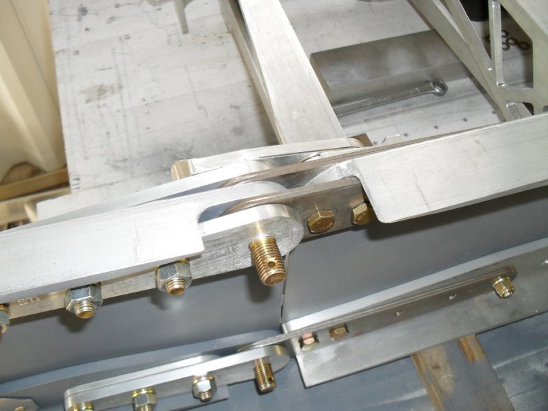

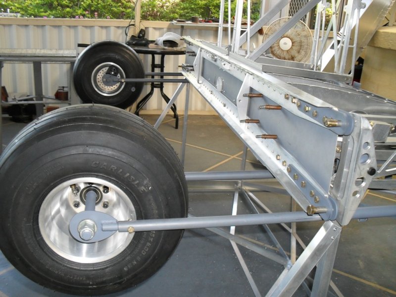

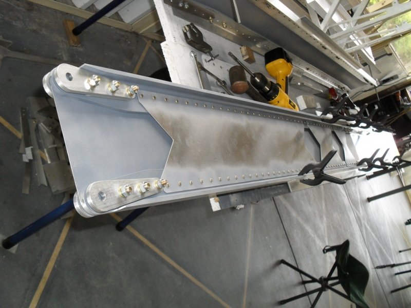

I'm not meaning to rain on your parade but I really think you need to build the whole carry through on the bench before 'inserting' it through the fuselage. Your photos show that you've riveted it into place via pop-rivets to the angles each side of the fuselage - that's a nice simple attachment method BTW, and quite secure enough since it can't 'escape' vertically, so only needs to be held in location laterally - but if you do plan to solid rivet the web then it'd be much easier bucking it on the bench than trying to do it in-situ. If you use pop rivets you'll be building a very limited service life airframe, they'll work loose in a short while in that highly stressed location.
Just for reference I've posted some pictures below of the carry-through I used on AussieMozzie which I never completed, but which is a similar wing arrangement for a pretty much identical weight aircraft. If you compare the size of the structural members you'll see why I think you might be a bit on the light side. Note that on this carry-through I have tapered the spar cap material at the outboard ends where the load is transferred from the aly caps to the nearly 800MPa heat-treated chromoly wing attachment plates, so to compare the actual member size you need to look at the carry through near its centre rather than at the ends, but as you can see, the spars for a cantilever wing need to be quite massive, even when using 6061T6 alloy -

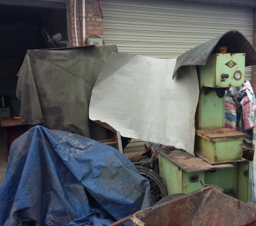

.. and here is the ex-State 6T riveting press I was looking at last week, not the old green one but the newer, sexy blue one under the black plastic on the left that you can't see ..

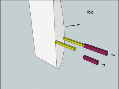

Bored hanging around with my sore hand today so here is a gif of the wing fold using simple tube and a heim joint .. or rose joint if you're British. The Heim company in America took a licence to produce them in the US while the Rose company did so in the UK in case you were ever wondering.
