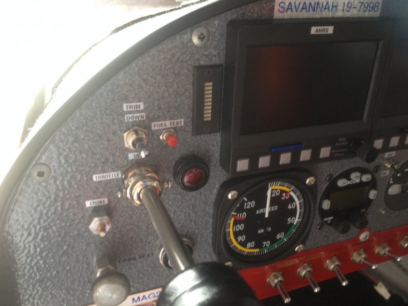

I changed out the silly light bulb in the fuel light which does blow to a 12V flashing 10 mm LED its mounted in the same case...works a treat and the failure rate is almost non existant. The flashing also attracts your attention

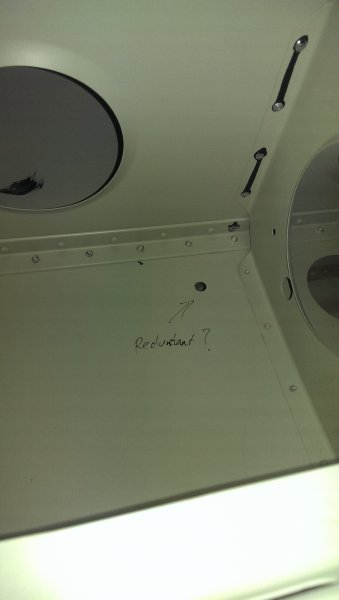

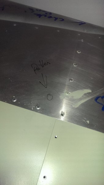

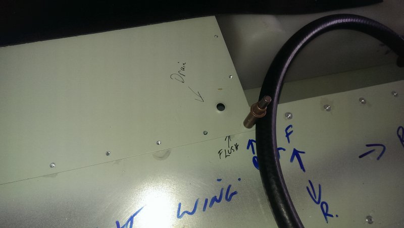

Breathers of the four tanks. Manual says I holes top and bottom skins. I can see the top but the bottom hole is a drain ??? Inner rear location. Correct. So the existing hole in the top is redundant with the auxiliary tanks. Any tips ??? Or just drill a hole in the top and bottom to suit. Any pics would great. Lyndon

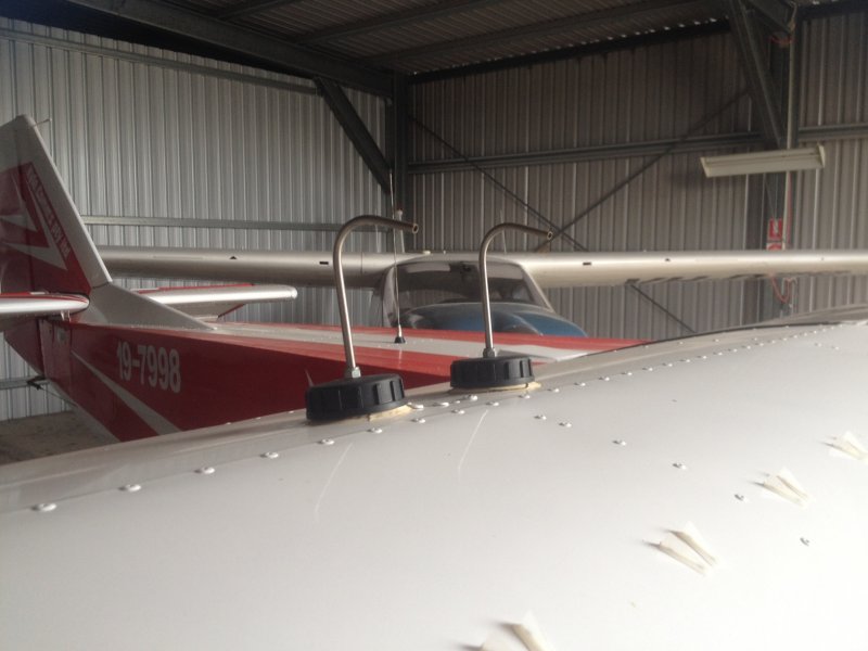

I had mine like that but went away from it after a bug blocked a tank from draining. I posted here about it...I would put the breathers in the caps like I did and probably more than half of the Sav owners have done now

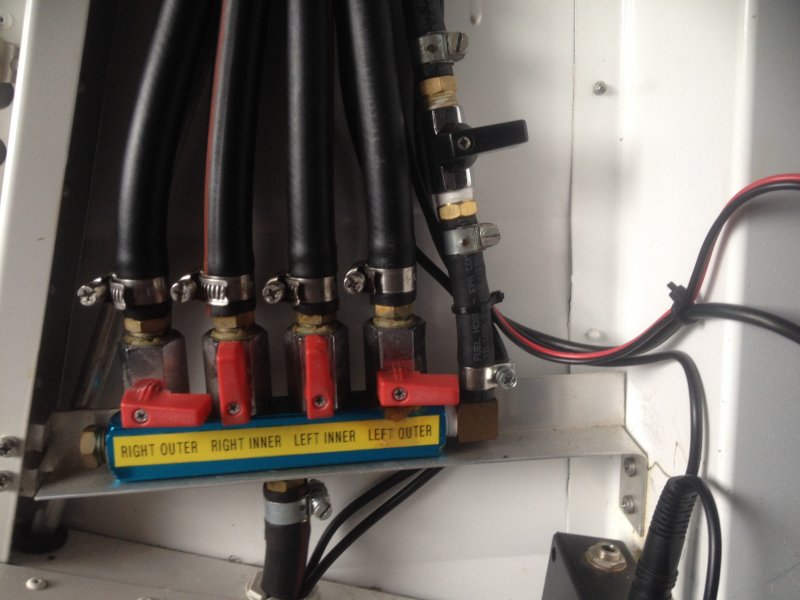

i have a 3 tank setup, left and right inboard tanks are setup via taps, on and off only for left, and the right side, is switchable between right inboard and right outboard, ( or reserve as i call it), and off. the engine return feeds the right inboard main tank. when i fly with 3 full tanks, i take off on right main only (with the engine return otherwise it will overflow) , and fly for about an hour, this drains about 18 ltrs from it, then ill turn that off,
Then i run on the right outboard reserve tank until its dry, as in, when the light comes on in the header. (the reserve tank has no level gauge) the inboard right tank is almost full again as well.
i have noticed that when i open the right main tank, after the light in the header tank goes on, it takes a while to go out, sometimes quite a while, but thats usually fixed when i open the left tank as well, and fuel can then crossfeed between left and right inboard tanks to even out their levels. if i get a bit worried, or annoyed about the header tank light still being on sometime after the tank change, i will fly unbalanced for a min or 2, this fixes it pretty much every time.
i think those drain holes are to allow water to drain out if any leaks through the skins, or the cutout for the fuel cap when in rain, also, as a drain if you have a fuel leak to stop it draining into the cabin.
Hi Lyndon,

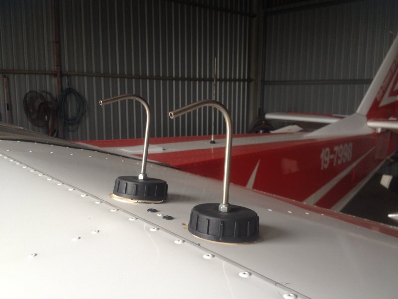

I completed my VG XL in 2010, and during construction I read a few blogs warning against putting the through-wing breathers between tanks, as a tank movement can block the breather and stop fuel flow from that tank. Consequently I put breathers in the fuel caps (copied from a Gazelle) and they work perfectly. This was also suggested by another follower, I see.

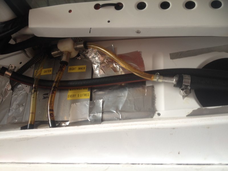

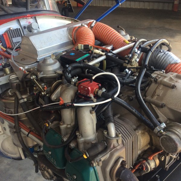

Attached are the pics as promised. Shows my overflow from the engine going into the RHS of the manifold and the fuel tap which allows me to tun it off if I want to and also where the overflow/air return for the fuel reserve goes to the top of the inner tank. The new SS tubes for te breathers and the flashing LED setup in the original fuel reserve light
  • Helpful 1

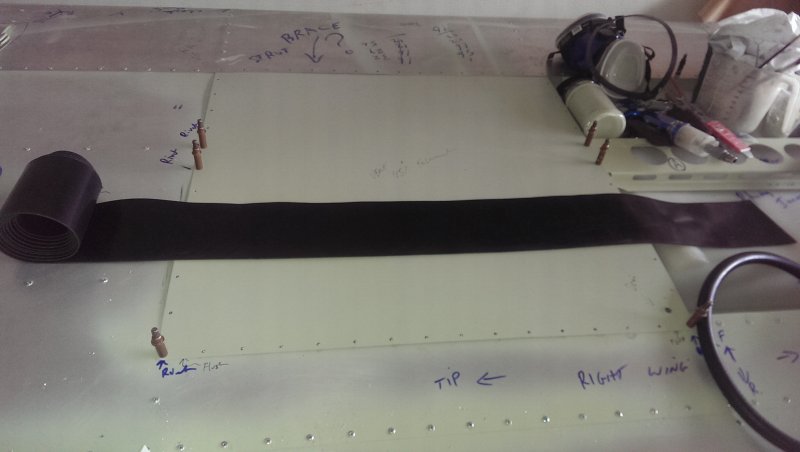

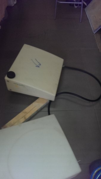

Thanks for pics. Looks very nice. Opinions on matting for the tanks. Book recommended top and bottom. I have got some rubber. I guess enough just to stop rubbing. When I washed the tanks out I just could not believe how heavy two tanks in each wing will be.

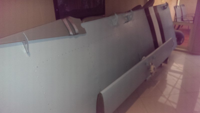

Progress
Looking good, Lyndon. And some coincidence: I was revisiting some of the conversation on prep and painting, and wondering how you were going. I'm the tail surfaces and one wing into my S build; finally got the tanks sorted. I think, I hope!

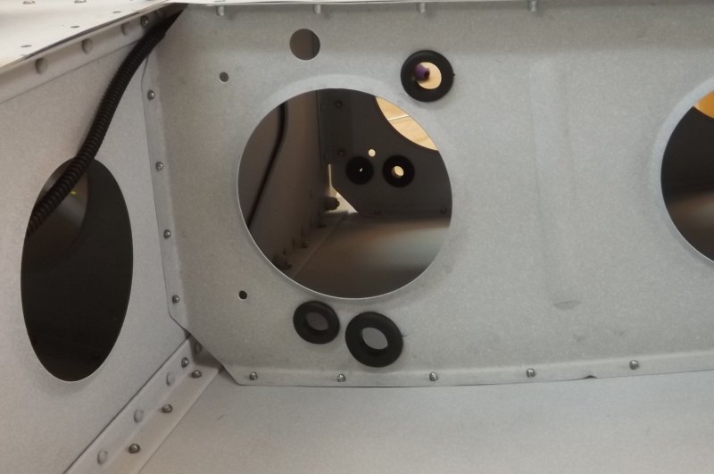

I can't speak for your fuel level pipes; mine just go into the side of the tank, as high and as low as practical, and positioned so as to avoid butchering the rib lightening holes. This is what I ended up with. It's upside down. I moved the bottom level pipe hole back to avoid the rib lightening hole. That's the grommet at the top there.
