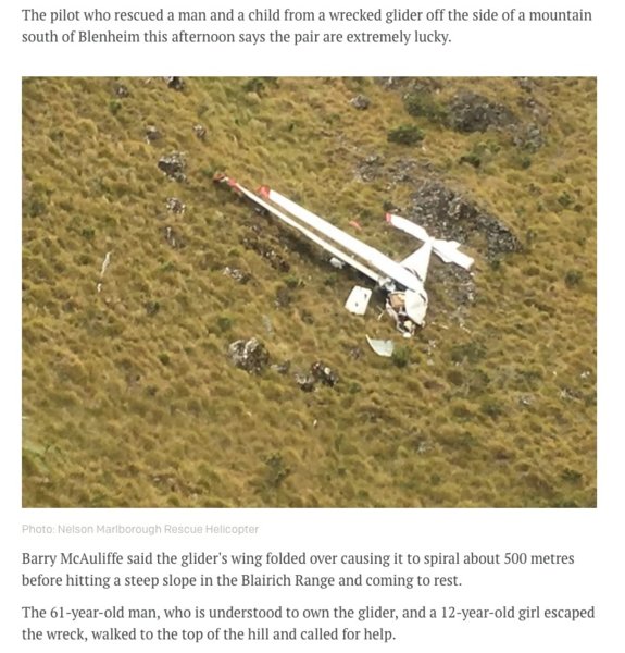

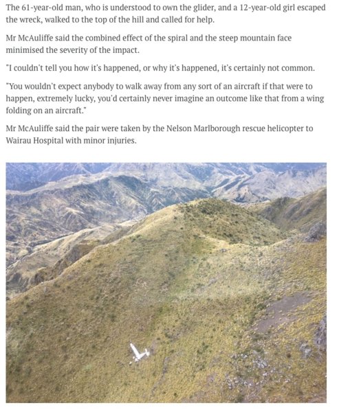

pylon500 Posted January 4, 2018 Posted January 4, 2018 Just an update; Miracle escape for pair after glider crash
Nobody Posted January 4, 2018 Posted January 4, 2018 Just an update;Miracle escape for pair after glider crash [ATTACH]53294[/ATTACH] [ATTACH]53295[/ATTACH] The news article mentions catastrophic wing failure... Question - How many here fly gliders too? 1 2

SDQDI Posted January 4, 2018 Posted January 4, 2018 Steep mountainside or not that is still an unbelievable outcome. It is hard to see too much detail in the pictures but I can’t really see a long impact area down the hillside which you would think would be needed to slow the fall slowly enough.
pylon500 Posted January 4, 2018 Posted January 4, 2018 Steep mountainside or not that is still an unbelievable outcome.It is hard to see too much detail in the pictures but I can’t really see a long impact area down the hillside which you would think would be needed to slow the fall slowly enough. I get the impression it may have come down like a sycamore seed, the mountain slope just adding that little extra deceleration to not be a sudden stop. Have to wait till we hear from Gary.
bexrbetter Posted January 4, 2018 Posted January 4, 2018 Well that is a fairly harsh "I told you so" nobody. I don't mean any criticism to you nobody but it does come across a tad harsh. Well it was a fair 'one on one' and nobody won. Well somebody won, but it was nobody, i mean, arrrh, forget it. Glad we can rib people about it as the Pax walked away. It's a good result for Morgan as this avoids it happening in tragic circumstances and clearly shows where he has to re-engineer, and give his engineer a mouthful while he's at it. All this is moot if he actually clipped the wing along the side of the mountain of course. 2 1

kgwilson Posted January 5, 2018 Posted January 5, 2018 This is the report from the local Marlborough Express. The pilot and passenger are not named. Lucky escape from glider crash south of Blenheim It would seem that the wing failed and folded over as it is seen on the ground. This prevented the ballistic parachute from being deployed & the glider then spiralled down like a sycamore seed as Pylon said about 1500 feet. They were very lucky & I bet extremely dizzy on contact with the side of the mountain.
Happyflyer Posted January 5, 2018 Posted January 5, 2018 It’s reported the aircraft rego was ZK-CZJ. Morgan 10 Cheyenne owned by G.S. Morgan. https://www.caa.govt.nz/script/aircraft-register-query/RegisterationMarkForm See also Incident Morgan 10 Cheyenne ZK-CZJ, 31 Dec 2017
facthunter Posted January 6, 2018 Posted January 6, 2018 The wing appears to have bent over a considerable length near the wing root.. Compression failure in the top elements?. Not a very thick section. Nev

bexrbetter Posted November 11, 2019 Posted November 11, 2019 Have to wait till we hear from Gary. I have.. A wing root doubler plate failed, simply wasn't thick enough and hence buckled/failed after hitting a big bump.
