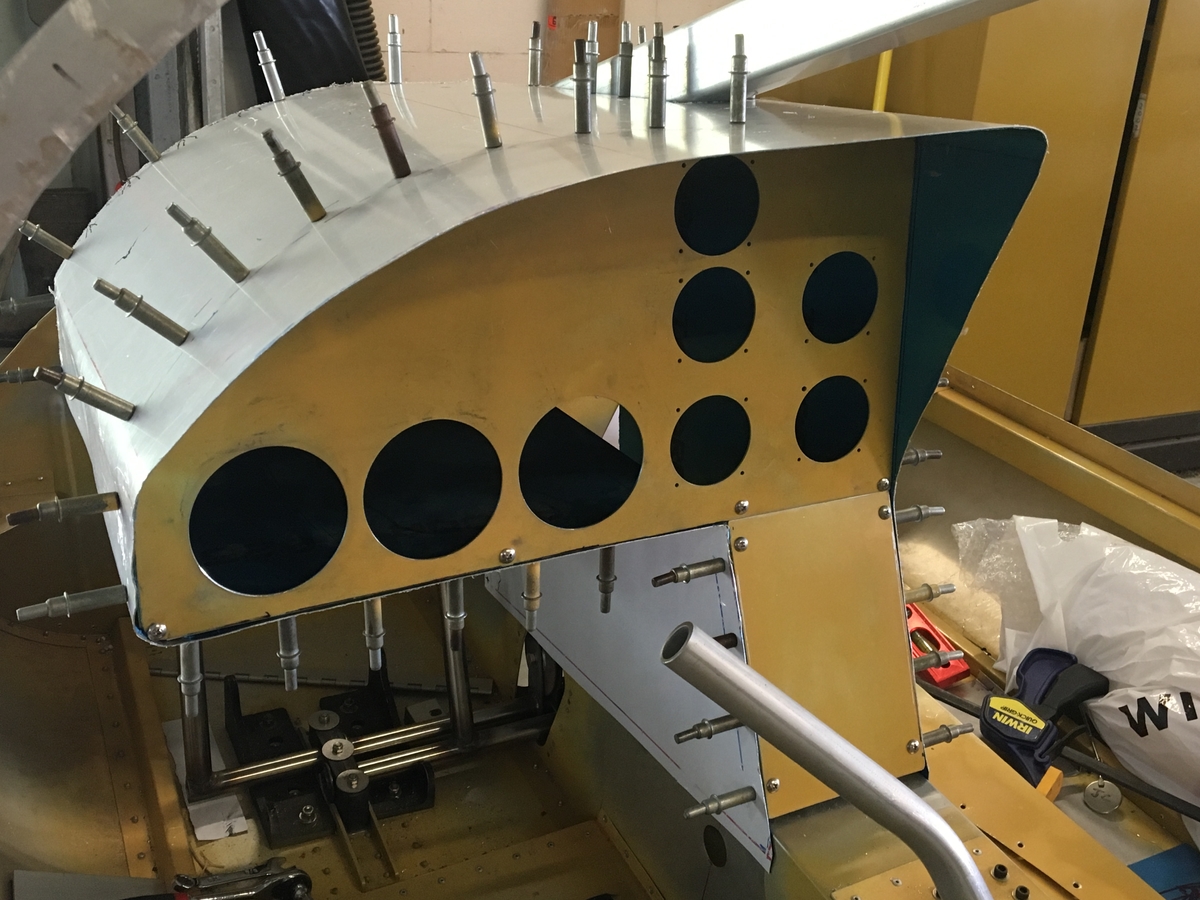

Here we have the beginnings of my instrument panel with abit of work to go yet and a few instruments.

Another question concerns the use of some sort of reflective dulling material around the outside of the instrument panel (pictures above).  The plastic is off it and I have riveted it together and the only clecos remaining are along the very bottom where it joins the tunnel.
Couldn't you use a matt paint on the outside of the instrument panel?
