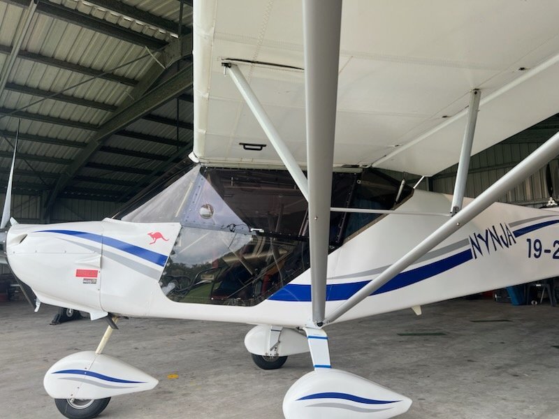

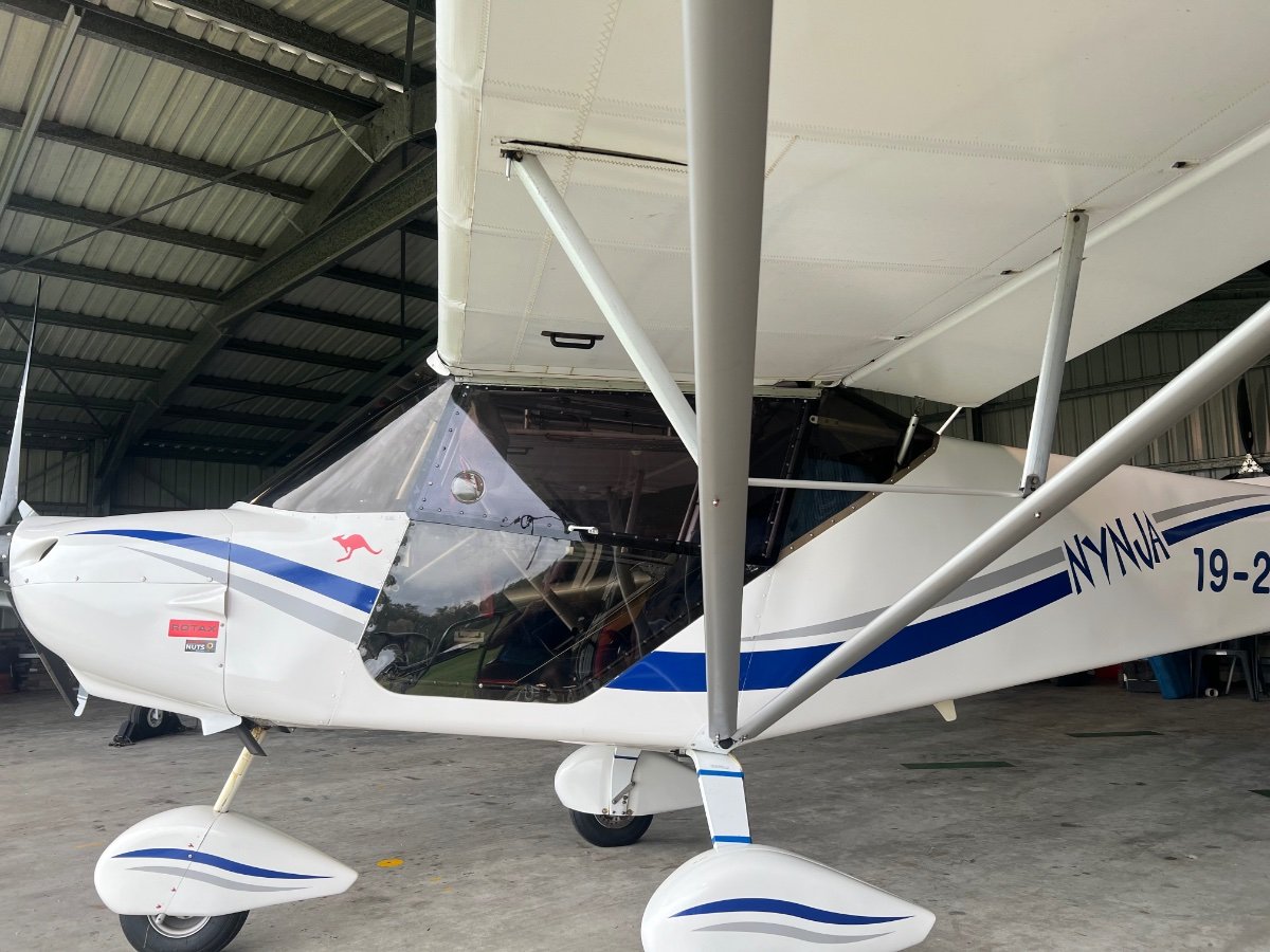

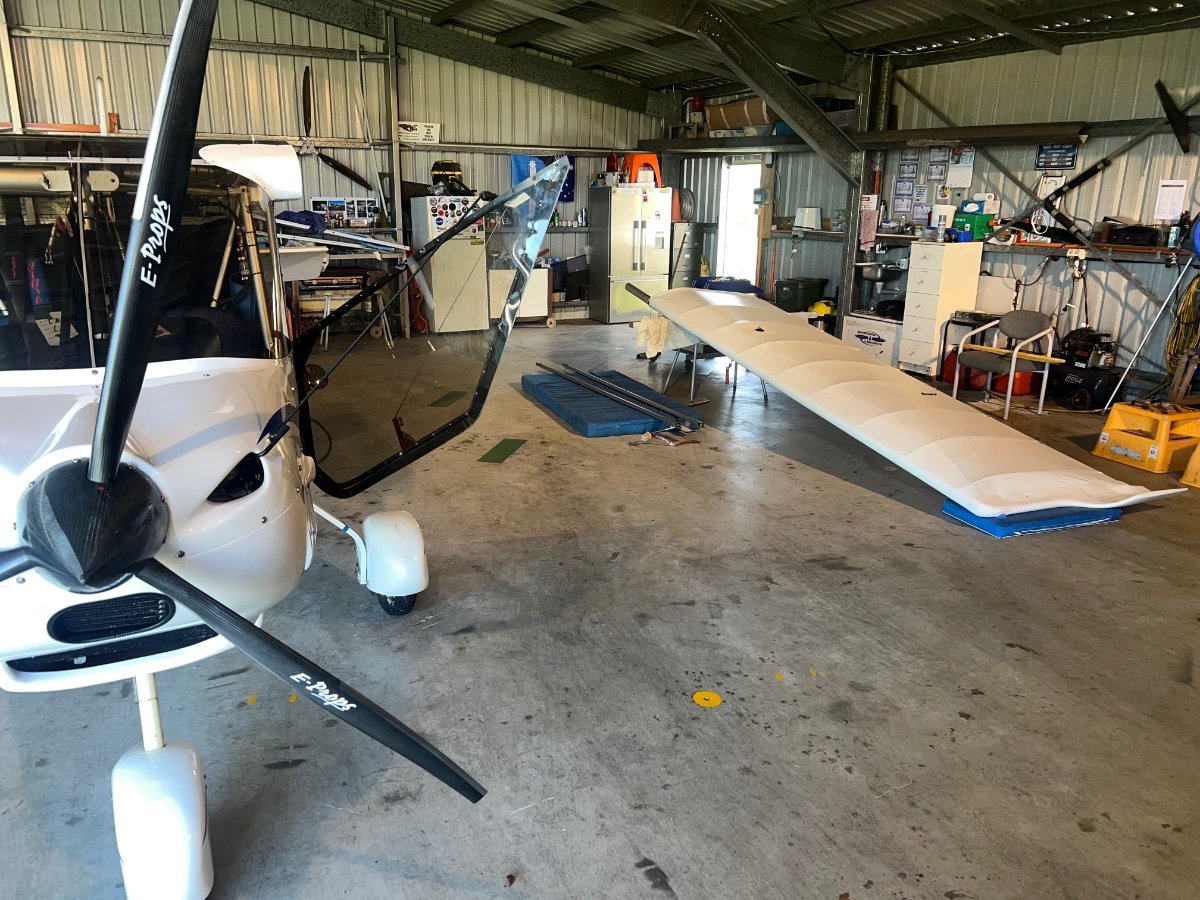

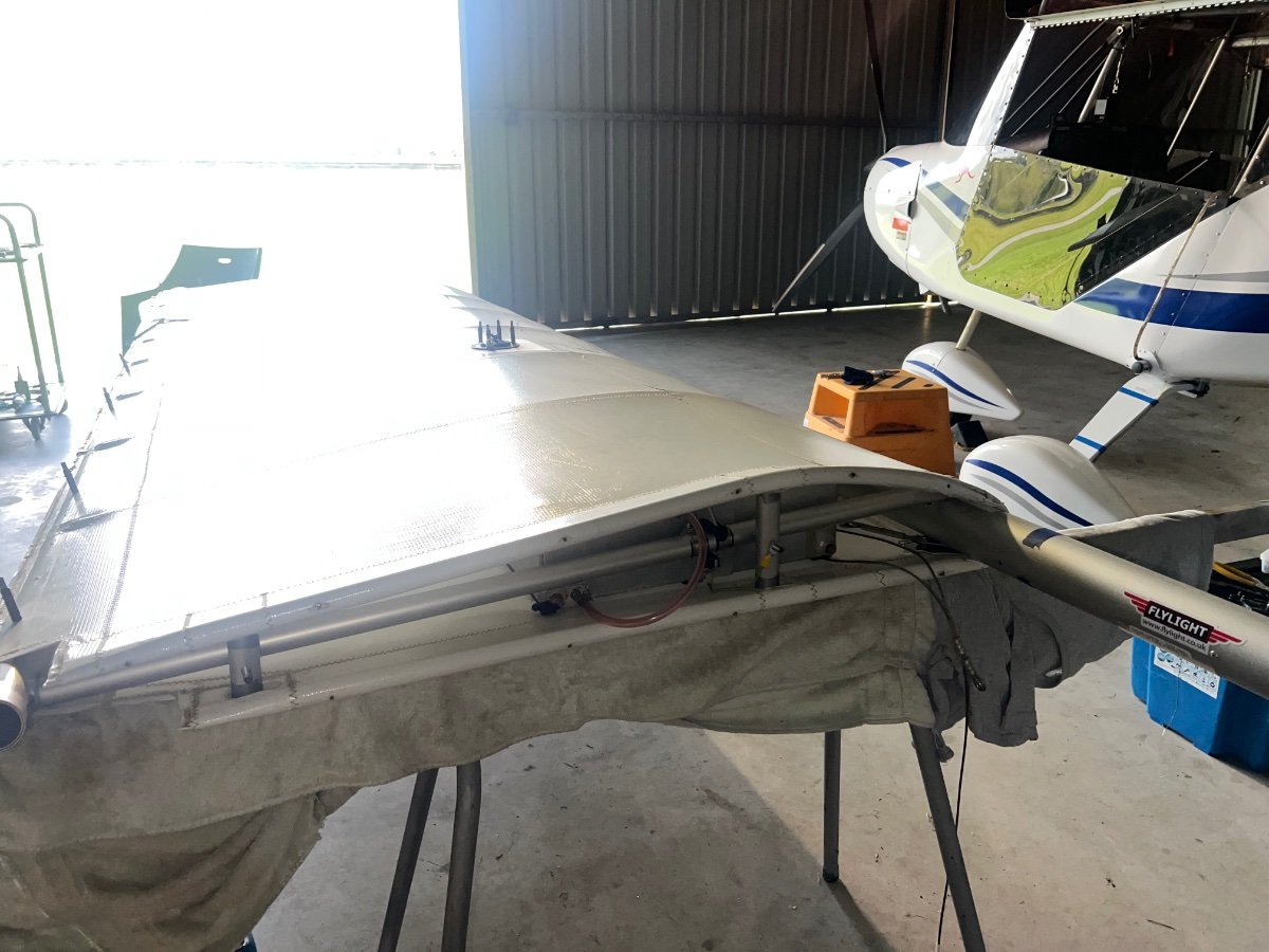

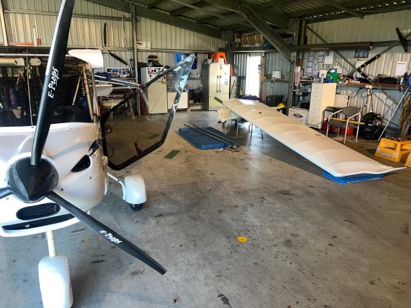

Blueadventures Posted February 27, 2025 Posted February 27, 2025 Finally happening; started work to fit 600kg upgrade brackets and brace wire into wings today. Drained fuel, disconnected aileron cable and removed ailerons. More planned for tomorrow afternoon. Should have wings ready to come off for Saturday afternoon then the fun / work begins. Doing mate Ben’s was a good experience and a couple of comments from Paul at Flylight about some update refinements they do all helps. 2 1

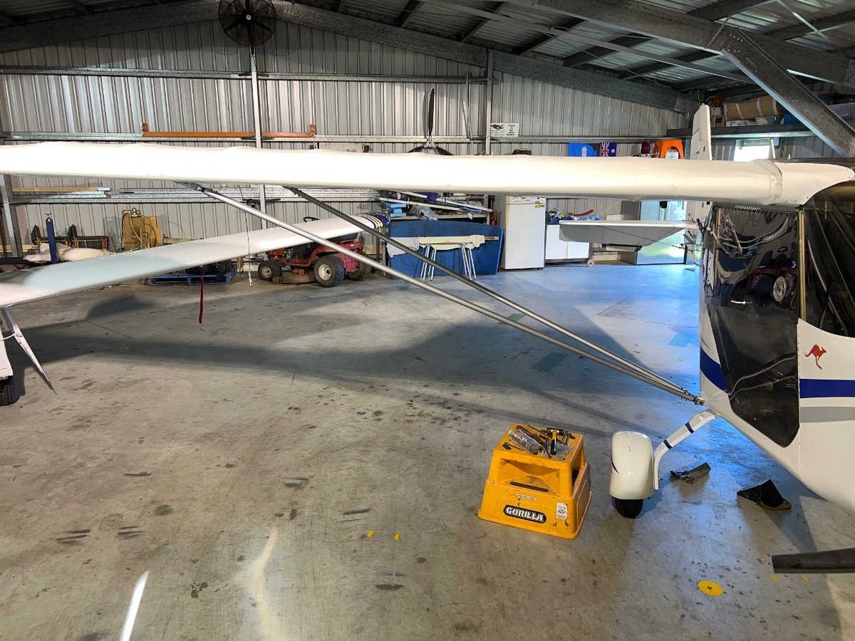

Blueadventures Posted February 28, 2025 Posted February 28, 2025 Ready for wings off tomorrow, all bolts backed off or nuts removed. first one at least. Had a visitor in the hangar today. Zoom in and see it looking at me; maybe smiling for the photo. I don’t like snakes. 2

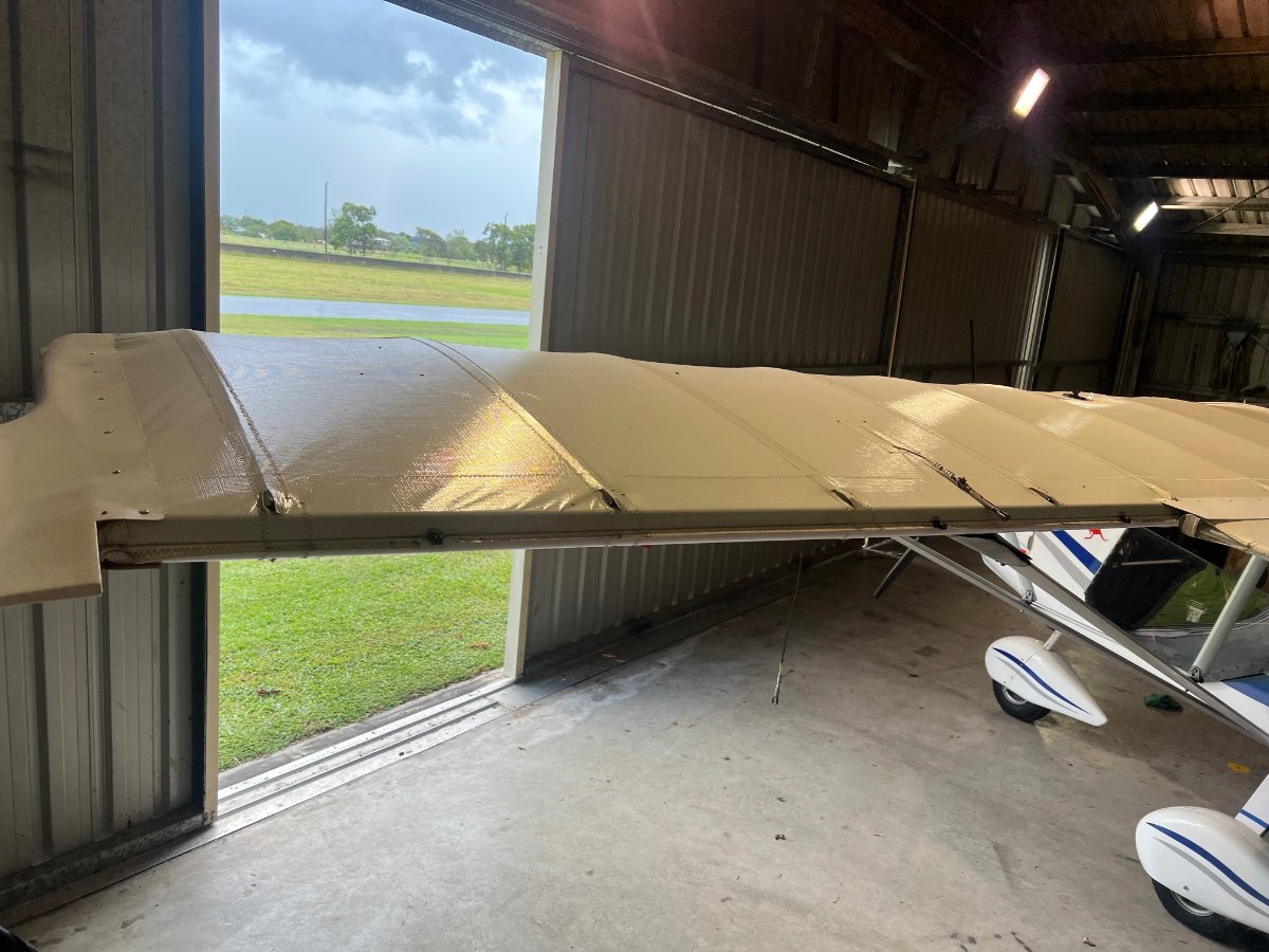

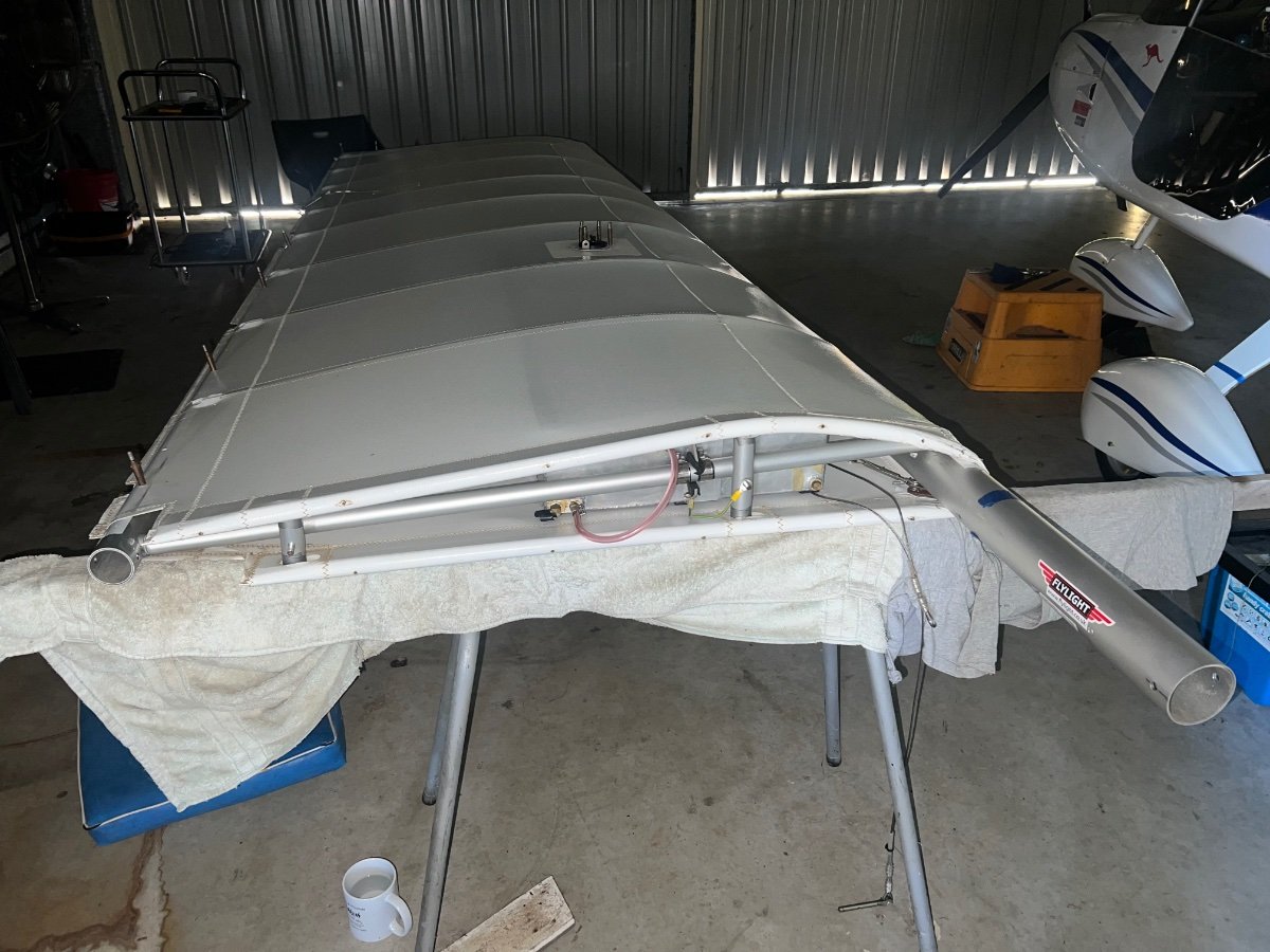

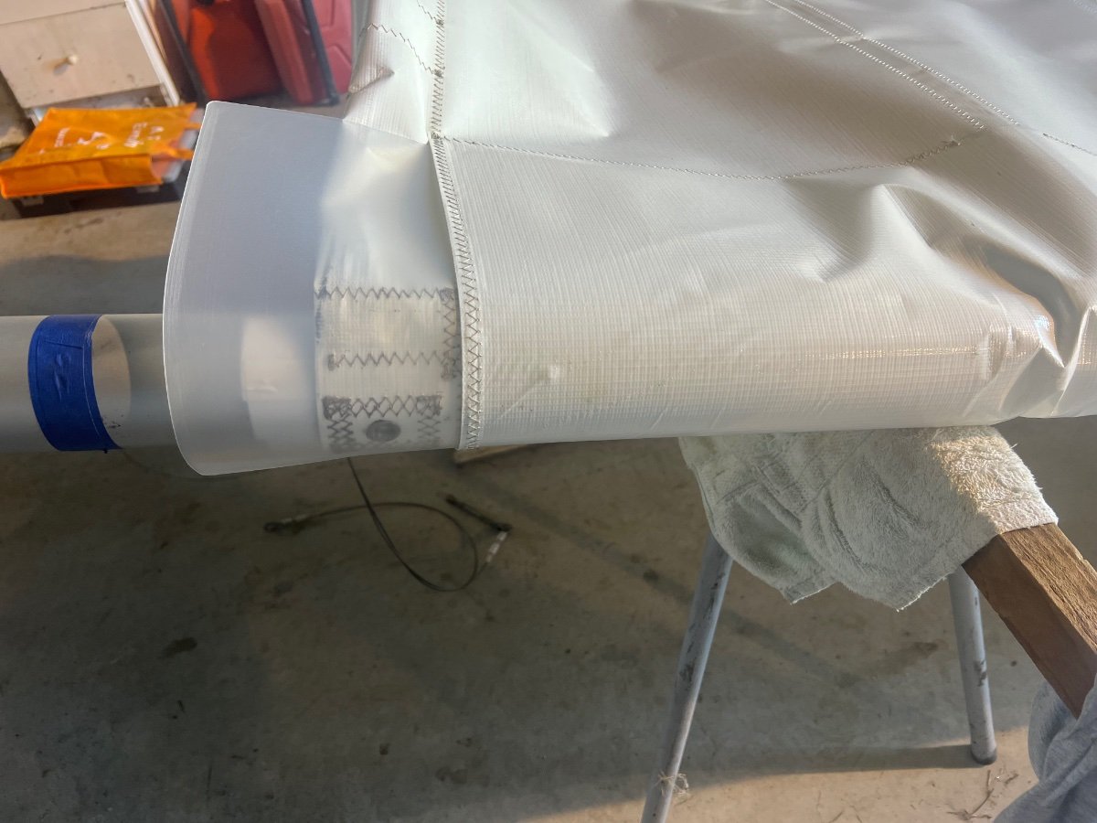

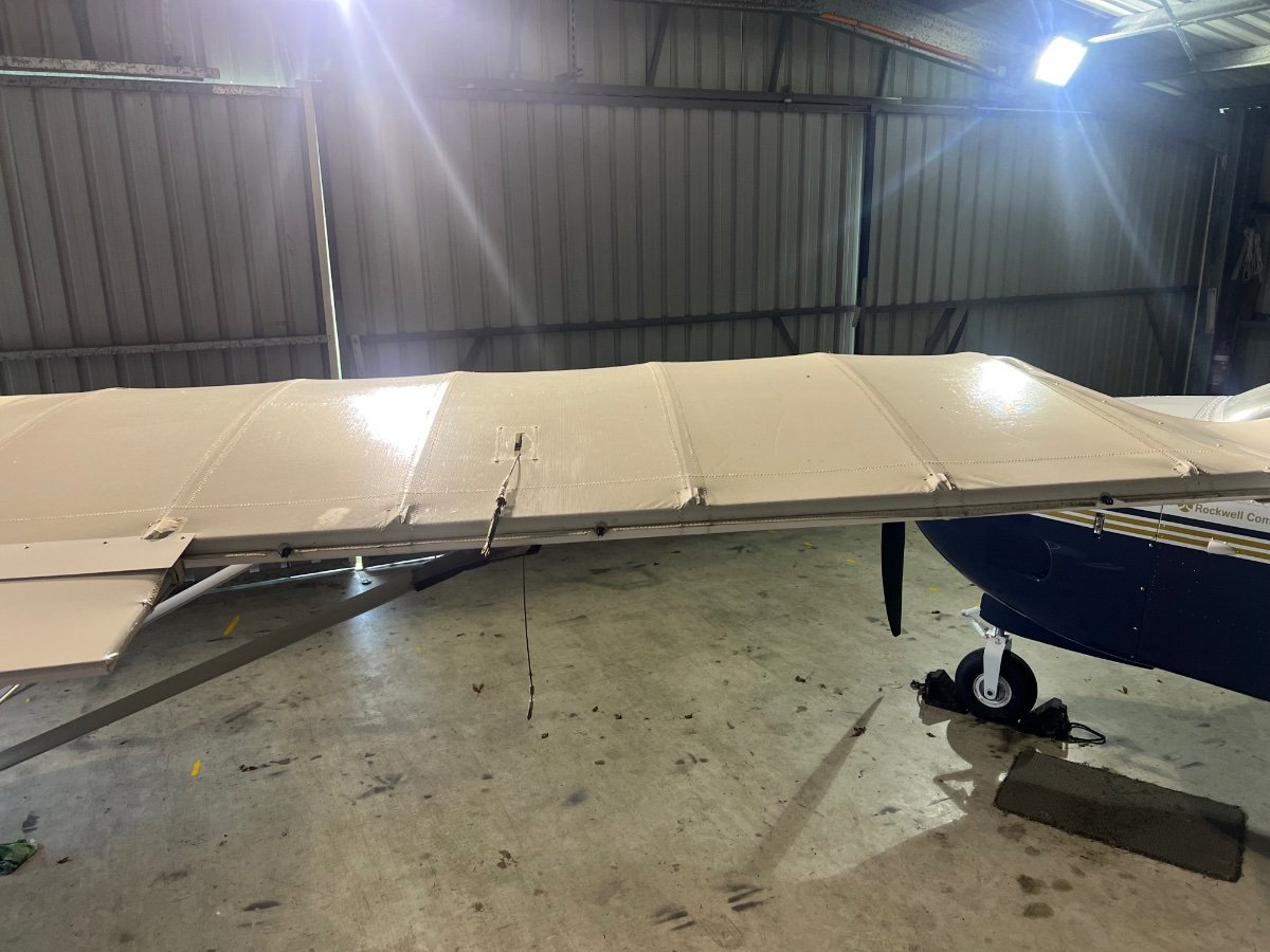

Blueadventures Posted March 6, 2025 Posted March 6, 2025 (edited) 5 hours ago, Moneybox said: Poor old snakes get a raw deal don't they. He was probably looking for rats or mice and there are very few snake bites if they are tampered with. Yep, they do a good job, it was gone next day, somewhere else in the hangar. Was not a killer if bitten so a hangar pet. Got one wing finished today. Just need a suitable time next few days to put back on and get the other wing off. Added an update of plastic sheet to fill out the inner section where we get a wrinkle effect, worked well. Fitted new fuel contents tube while had things apart. Edited March 6, 2025 by Blueadventures 5
Blueadventures Posted March 6, 2025 Posted March 6, 2025 (edited) 1 hour ago, Col said: That xlam skin still looks brand new Mike! 👍 The plastic sheet insert takes the looseness out in that first forward panel of the skin. Got the 0.8mm sheet from office works. Edited March 6, 2025 by Blueadventures 1

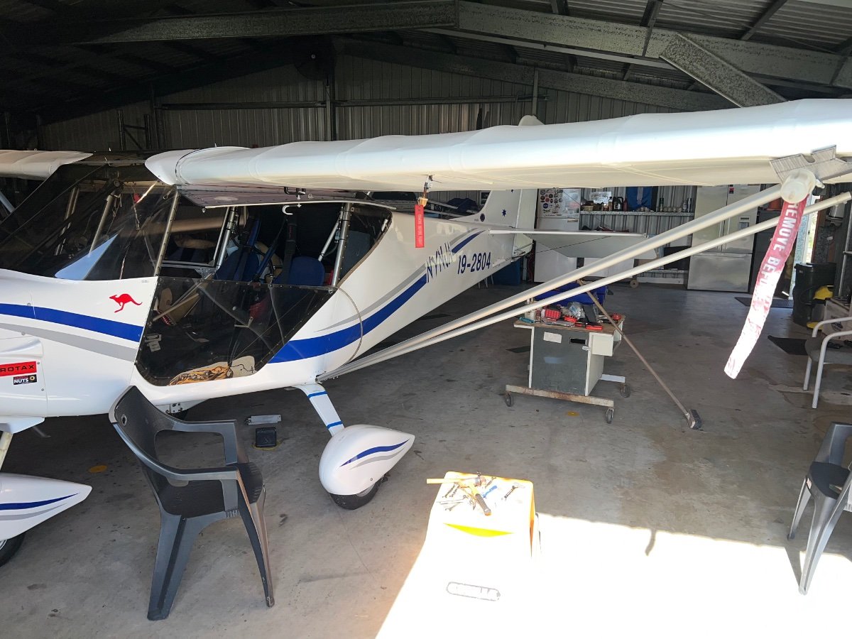

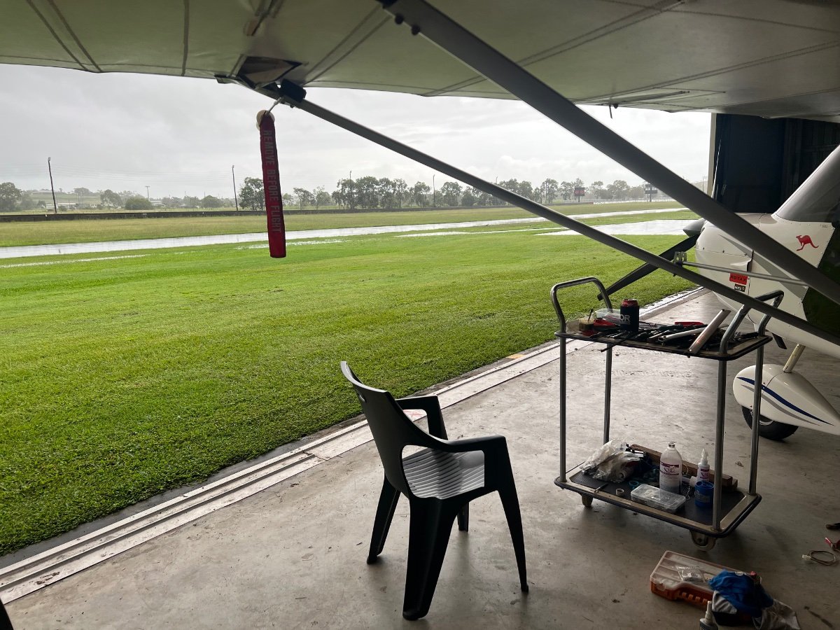

Blueadventures Posted March 20, 2025 Posted March 20, 2025 (edited) Finished the installation of the 600kg upgrade parts yesterday. Set the flap and aileron adjustments. Having a break today then do a recheck and ask a mate to do a double preflight check over. Then perform a new weight and balance. Next fill the tanks and take her up. Need the rain to back off for a short period; looks like the rain has set in for at least another week (it is our wet cyclone season this time of year). Edited March 20, 2025 by Blueadventures 5 1

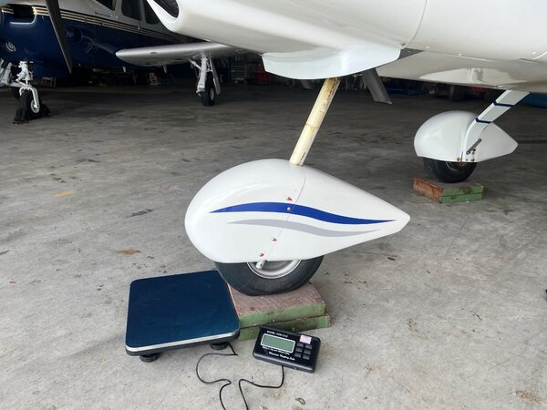

Blueadventures Posted March 23, 2025 Posted March 23, 2025 (edited) Getting ready to weigh tomorrow. Just need all items and engine oil out. Nynja at it’s level orientation for weighing. Edited March 23, 2025 by Blueadventures 3 1
Underwood Posted March 23, 2025 Posted March 23, 2025 Looking good BA. There are quite a few 600kg Nynjas over here now and the owners seem well pleased with them. I'm staying with the 472kg limit as I rarely fly with a passenger and rarely end up unable to get fuel. A pair of jerry cans in place of a passenger are carried when needed. Be interesting to read what your ZFW ends up as.

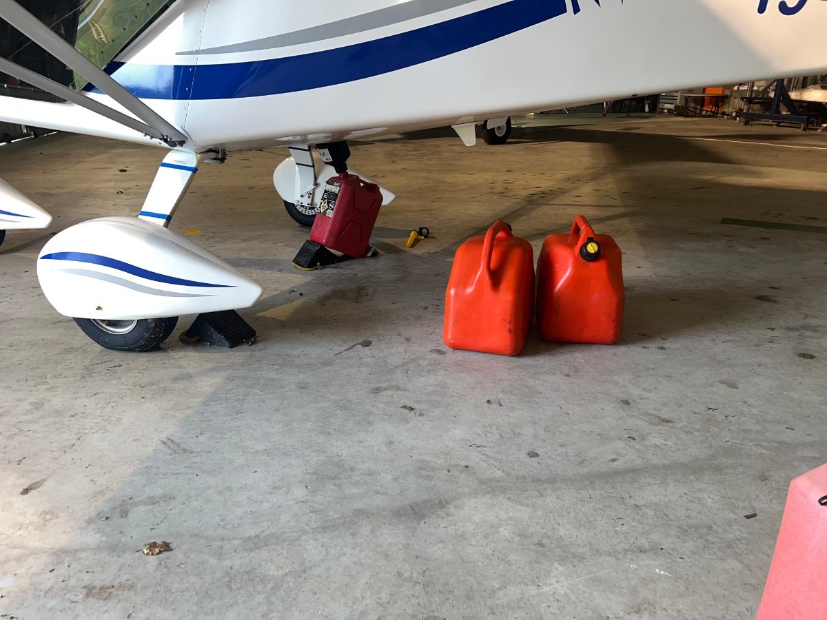

Blueadventures Posted March 24, 2025 Posted March 24, 2025 (edited) Weighing today came in at 312.6kg had 2 litres of fuel in collector tank and oil in engine. If I had checked that I would have drain it. I had taken the plane of its blocks so unable to re weigh, may do it again. Collector tank is on Stb side just behind main wheel. Have sent an email to Jarrod at RAAus to ask about w&b method of approval. Edited March 24, 2025 by Blueadventures 1
Moneybox Posted March 24, 2025 Posted March 24, 2025 2 hours ago, Blueadventures said: Weighing today came in at 312.6kg had 2 litres of fuel in collector tank and oil in engine. If I had checked that I would have drain it. I had taken the plane of its blocks so unable to re weigh, may do it again. Collector tank is on Stb side just behind main wheel. Have sent an email to Jarrod at RAAus to ask about w&b method of approval. Just weigh any fluid you remove. 1
Blueadventures Posted March 24, 2025 Posted March 24, 2025 2 hours ago, Moneybox said: Just weigh any fluid you remove. Thanks I'll wait for a reply from RAAus, likely be busy with Avalon being soon. (Reply message says up to 10 days.) Weather too ordinary to fly and helping a mate with a reskin and replace new lexan in some areas on his Nynja so will wait for a reply. I'll reweigh just need someone to fit the blocks as I lift the wing and nose. Ony have to unpack the repacked the onboard gear.
facthunter Posted March 25, 2025 Posted March 25, 2025 Push the Tail down is the easiest way to lift the Nose. Lift near the strut attach point (carefully). Nev

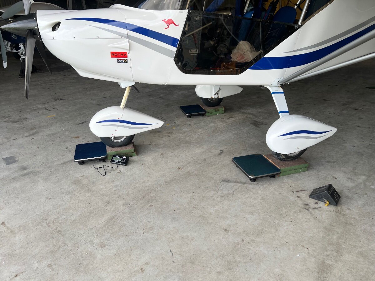

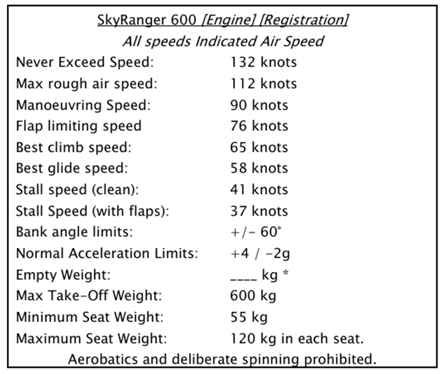

Blueadventures Posted April 4, 2025 Posted April 4, 2025 Re did the w&b today and measured the moments had two mates helping out with putting on blocks and rolling onto weight cells. First weigh was 309.45 and 2nd 309.60. No fuel this time. Spoke with Jarod at Tech yesterday very helpful as usual. All images now in a photo record of the weighing and I'll do the other sheets and send in for next week. With luck may get back end of week or the week after. Have the new placard fitted for 600kg. New speed numbers below. It'll be a tough aircraft - rough air max is 112 kts. Shame they are not in schools as not many chances to experience by flyers or students. There is one factory build in South Australia but not hired or used in a school. Listing my empty weight as 310kg. Weather is not the best at present so no rush to fly and still need to do triple check and have an independent check of controls and the fitout. Can't wait to fly the upgraded bird. 4 2
