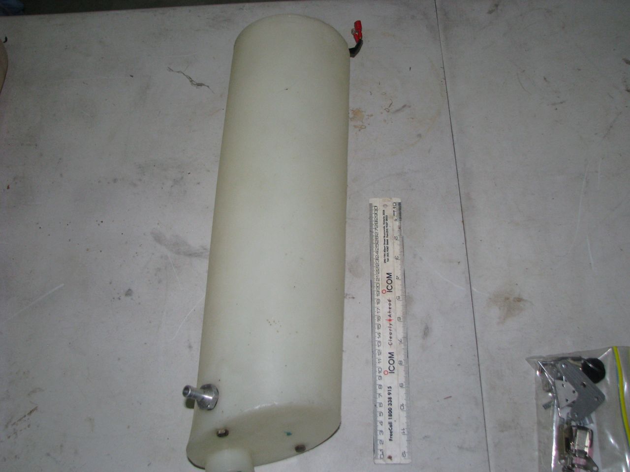

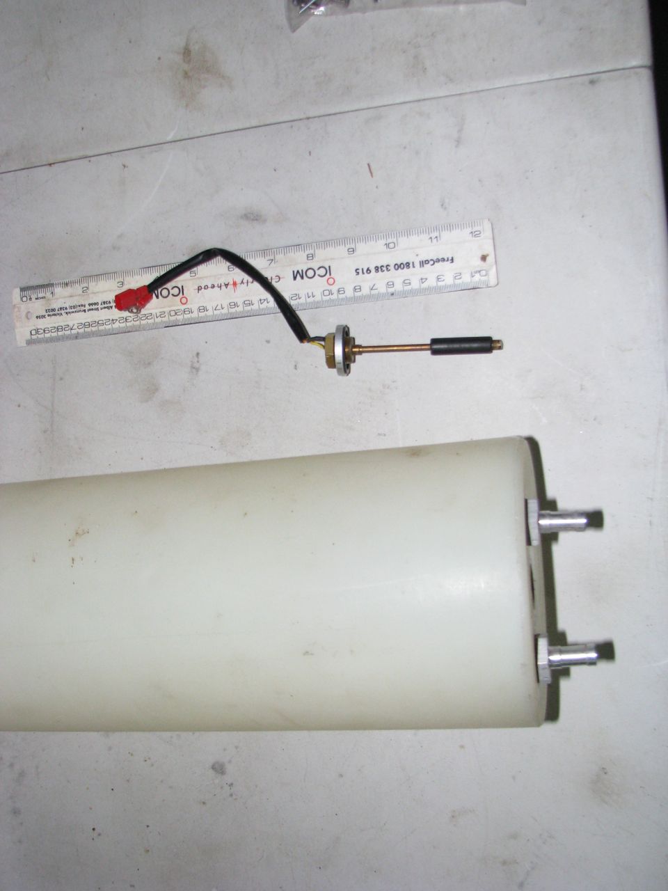

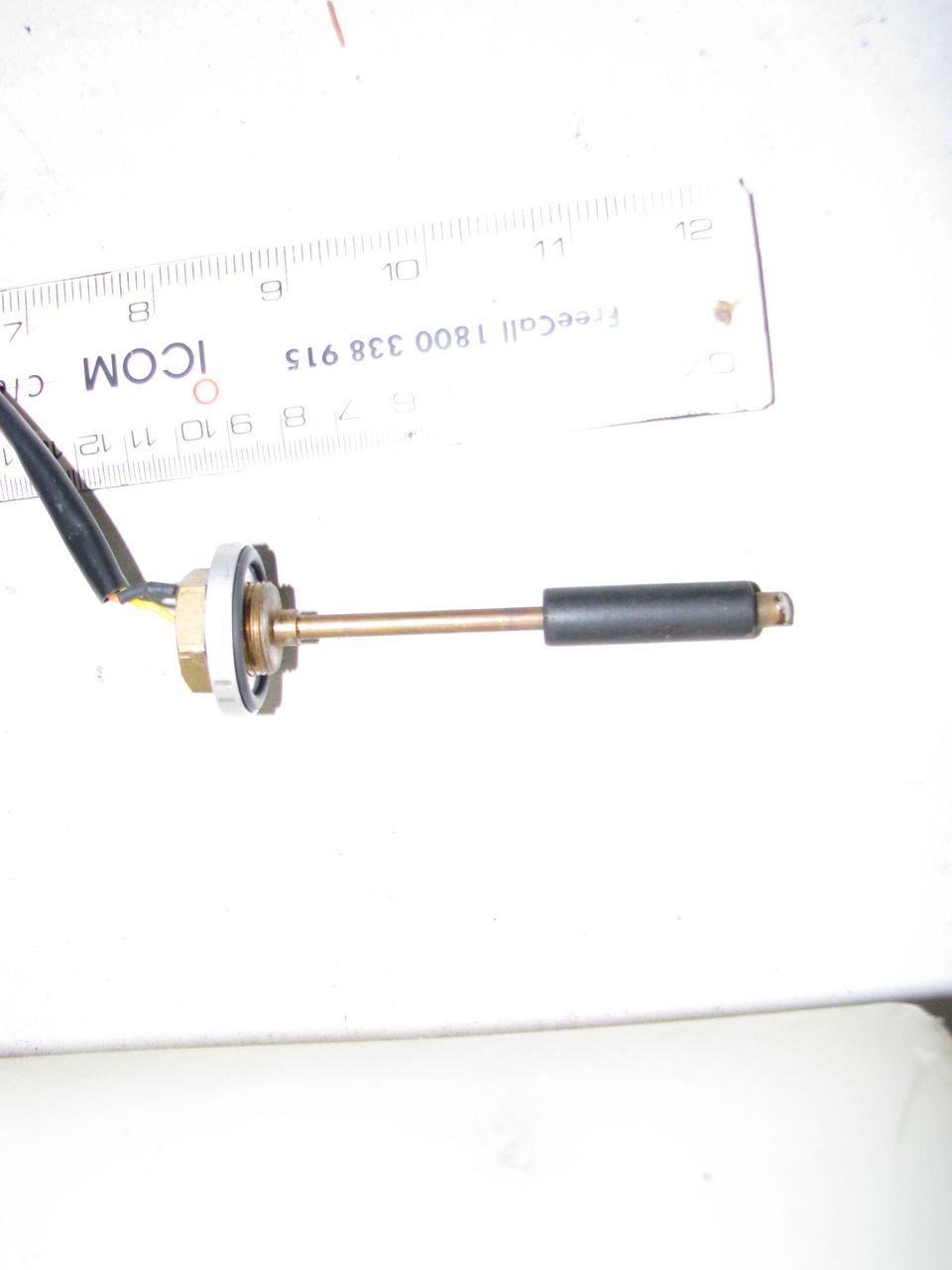

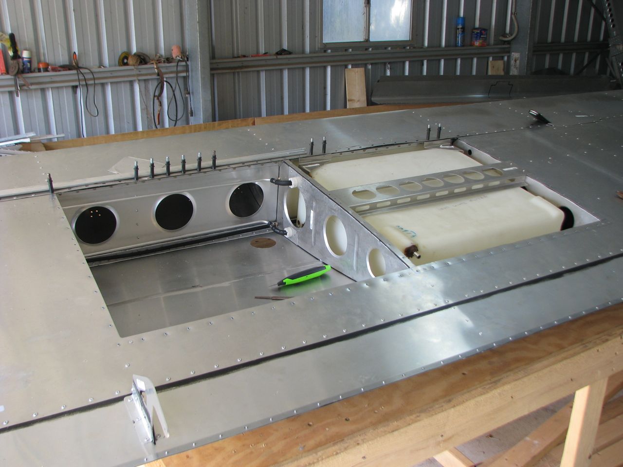

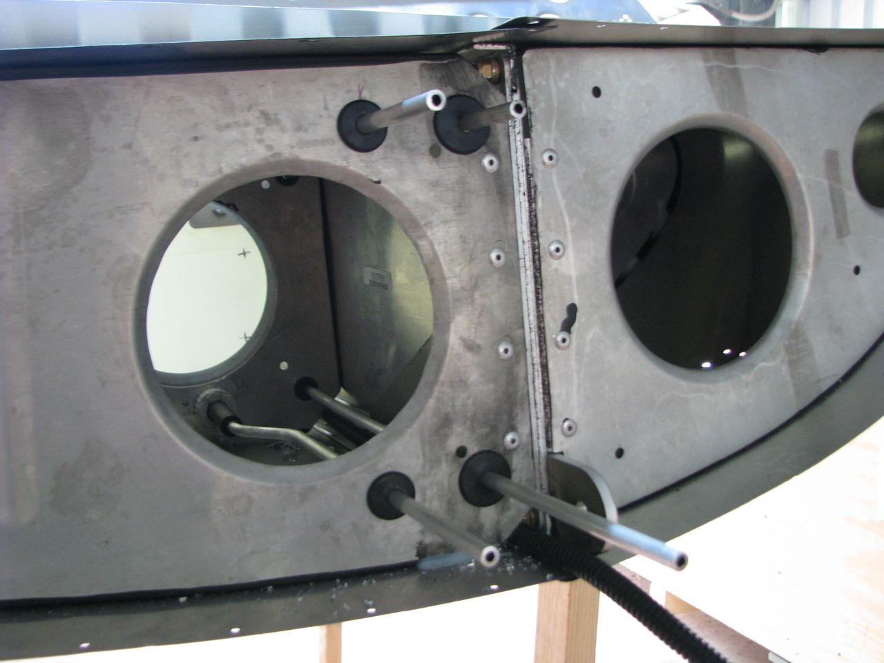

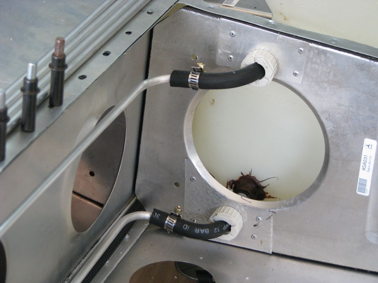

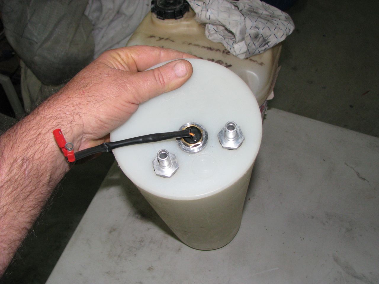

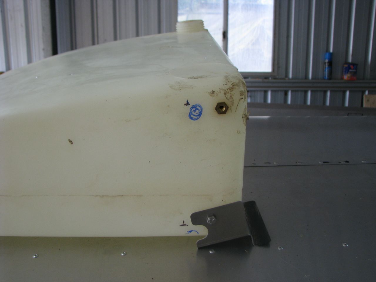

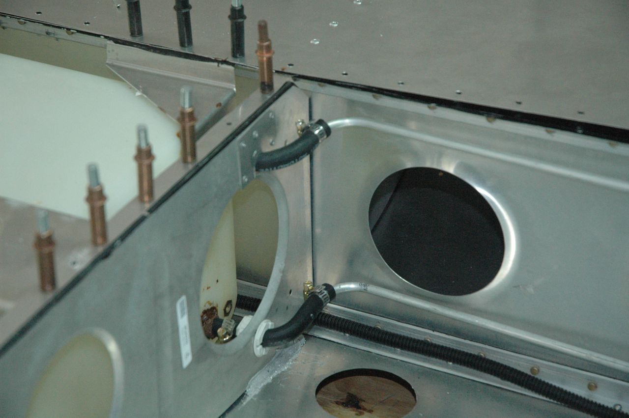

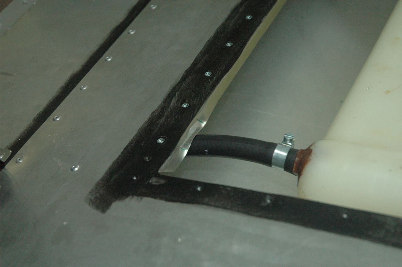

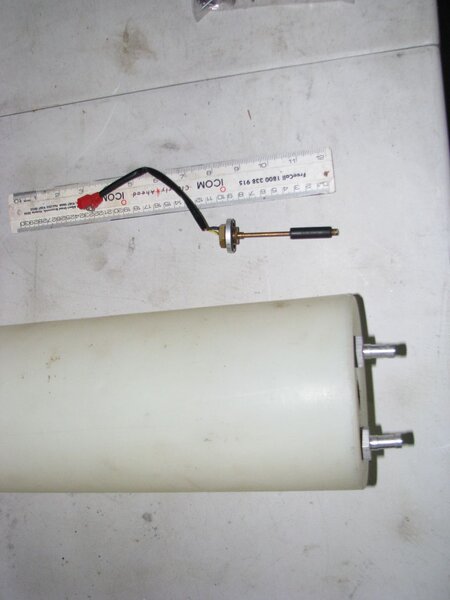

Just got home from being away this weekend. Got the sav reserve tank and took some pics for those who maybe interested. Now looking at it in detail it probably would be 10 litres and it has the fuel drain at the bottom to get rid of any water etc. The bottom pipe is the feed for the engine the 2 at the top one is for the in from the tank the other is used for a breather back to the top of the tank so when it does empty and the light comes on when you switch tanks it should fill up easily because of the breather and then the light goes off. If it doesnt go off after switching tanks then start looking to land quickly I would think. I took the sensor out of the tank it just screws out as there is a threaded bush molded into the tank. it looks like a capacitive sensor. I am sure you could get the complete unit or even just the sensor from Reg Brost or Outback Aircraft direct

Mark...great pics as im thinking about this setup for my build. The breather at the top, does that vent out to the atmosphere higher than the main tank or does it vent into the main tank?
Scotty
I will be running it to the top of the tank. I have 4 tanks and have fitted the top and bottom fittings in all so I can monitor the fuel level. The breather will come up and just Tee into one of the top pipes these are out to atmosphere via the filler cap so will allow which ever tank I am switched to to drain into the reserve tank and refill it once the indicator has come on. This way when you do switch the tanks the light should go off this way you KNOW the engine is getting fuel

Hi Mark...thank you again for the pics. Im not being pedantic here or pretend to know what im doing but is it normal practise to use hose clamps on fuel lines like that in a plane? Please tell me if it is as im learning here and will come to a time when I will have to do that. I thought (scratching my head) that all lines like that had to be screw fittings?

Bubbleboy, It is common practise on our level of aircraft to use screw-clamps and rubber fuel hose. I won't use any fuel line unless it is black, from the US. I have been dissappointed with the red rubber hose, as it seems to crack the outer sheath fairly readily. If you putting fuel line in a position where it won't be easily accessable, like for instance Savannah wing-tanks, than I would definitly use US made, black rubber hose, and nothing else.
All rubber hose looks good and equal when it is new. I see a lot of fuel line with years of use on it, so I am in a position to make good comparisions. It is something I take a particular interest in, and there is nothing but US made hose in my plane.
If you are pushing rubber hose onto barb fittings, look for a good tight fit, but not so tight that you need to be Attula the hun to push it on. Also not so loose that you use the clamp to squeeze the rubber onto the barb to seal it. you can double clamp on lines that are pressurized by boost pumps if you have the room for two clamps. I use nothing but quality Tridon brand Stainless clamps. Do not overtighten clamps.
Fuel line leaks are a pain, and dangerous, so do your best to avoid ever having any !...remember keep it as simple as possible, for added reliability.............................................Maj...024_cool.gif.7a88a3168ebd868f5549631161e2b369.gif
The most important thing relating to clamped hose fittings is to have a rolled raised portion that the hose goes over or have a strip of metal under the clamp attached to some part adjacent ot the hose connection. The hose just cannot rely totally on the clamping force. Thought I'd mention something that is not always done. Nev
I do not know Savannah but I would recommend a solid fuel line for this.. In fact all fuel lines should be solid pipe except where there is a transition between bulkheads for vibration. All flexible fuel hose within the engine bay should be covered with a fire sleeve wrap. I agree with Maj on the double clamps.... 026_cheers.gif.2a721e51b64009ae39ad1a09d8bf764e.gif
Bubbleboy, It is common practise on our level of aircraft to use screw-clamps and rubber fuel hose. I won't use any fuel line unless it is black, from the US. I have been dissappointed with the red rubber hose, as it seems to crack the outer sheath fairly readily. If you putting fuel line in a position where it won't be easily accessable, like for instance Savannah wing-tanks, than I would definitly use US made, black rubber hose, and nothing else.All rubber hose looks good and equal when it is new. I see a lot of fuel line with years of use on it, so I am in a position to make good comparisions. It is something I take a particular interest in, and there is nothing but US made hose in my plane.
Excellent...thanks guys! I can say I learnt something today!

You picked up on that mistake I made back then. The wings were one of the first things I made getting on to almost a year ago now. Those clamps are stainless Tridon clamps that Maj suggested BUT they are not like the rest of the clamps supplied in the kit. Those clamps are all solid no "teeth" holes in them. The main fuel line has them you can see in the pic and I have these now in the smaller size for the ones you picked out in the pics. Although there is no pressure on these lines I am replacing them with the norm used throughout the kit on all fuel lines. I will fix these up when the wings come back over to here. I made them at my mother inlaws place as I didnt have the room here then. I also have nutserted all the cover panels for the tanks rather than rivet the panels as done in the kit. This will give me easier access if anything goes wrong in the tank area or I have any leaks...a lot of work to do all the nutserts but better than having to drill out all those rivets and there is a lot in 4 tank covers
