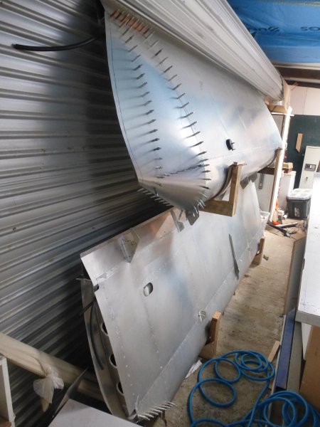

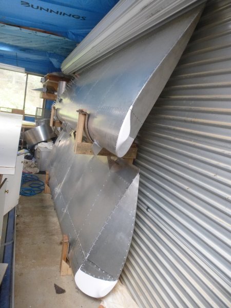

Marty_d Posted September 15, 2015 Posted September 15, 2015 Second wing done!!! That leaves... er... (counting on fingers)... zero wings still to build! 2
eightyknots Posted September 15, 2015 Author Posted September 15, 2015 Good job; what is next to be built?
Marty_d Posted September 15, 2015 Posted September 15, 2015 Thanks 80kts. Slats and flaperons next I think... should be a bit simpler than the wings, in the instructions there's only 39 pages combined for them (as opposed to 178 pages for the wings). Mind you then comes the fuselage which is half the bloody book.... but as my wife said to cheer me up, "You had to build 2 wings, you only have to build 1 fuselage!"
