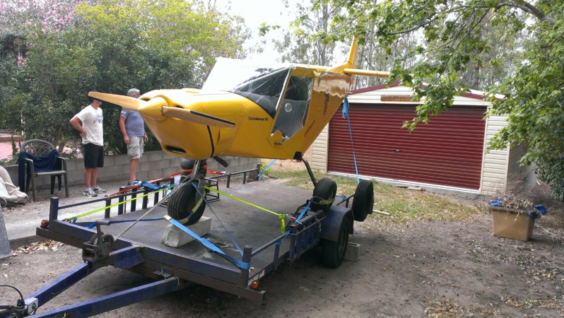

I do believe I'm getting closer![ATTACH]23784[/ATTACH] [ATTACH]23784[/ATTACH]
Don't know why that pic loaded twice and no idea where the video went!

Personal history being made! Only need to paint the wings now, room in the shed to work now the fuselage is out! IMAG0373.jpg.0f14b08960ccb365e57e12a4a00b6889.jpg
