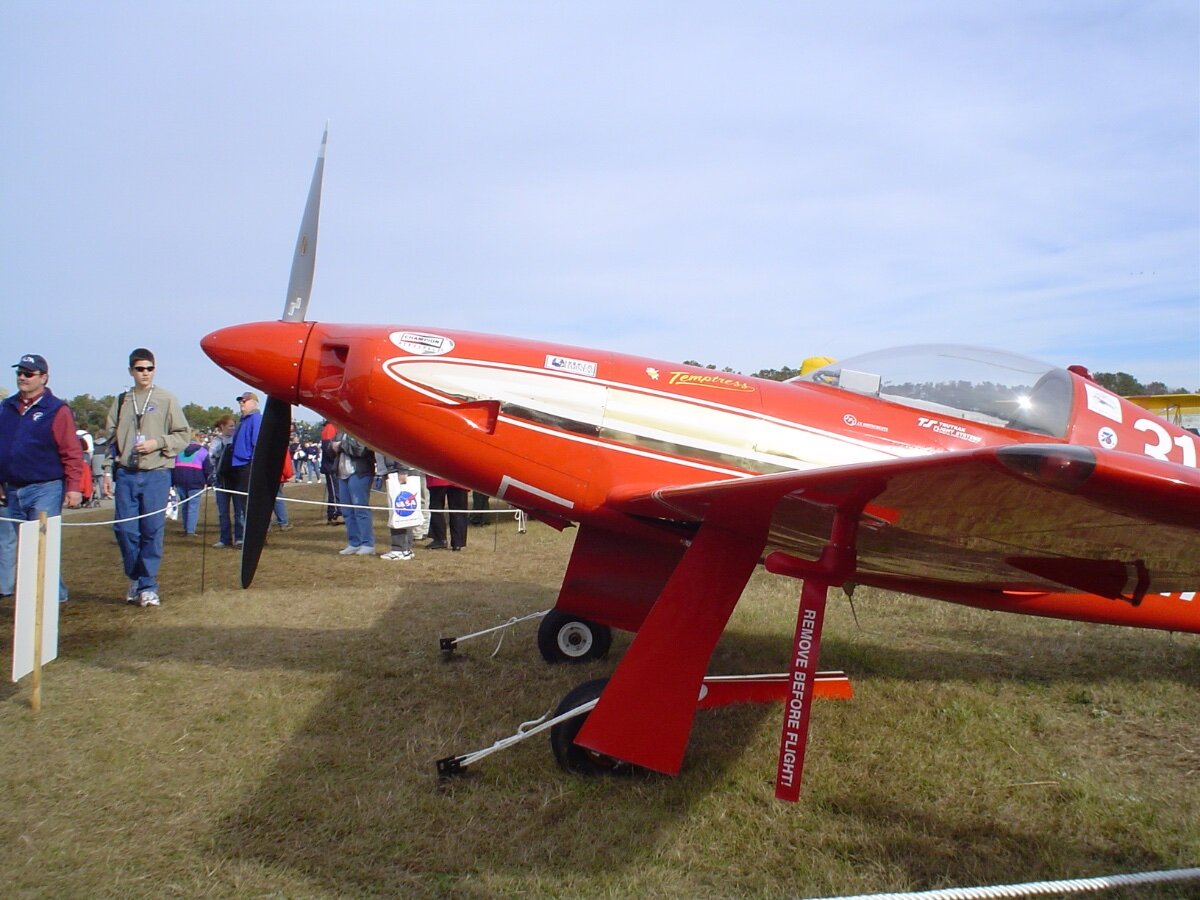

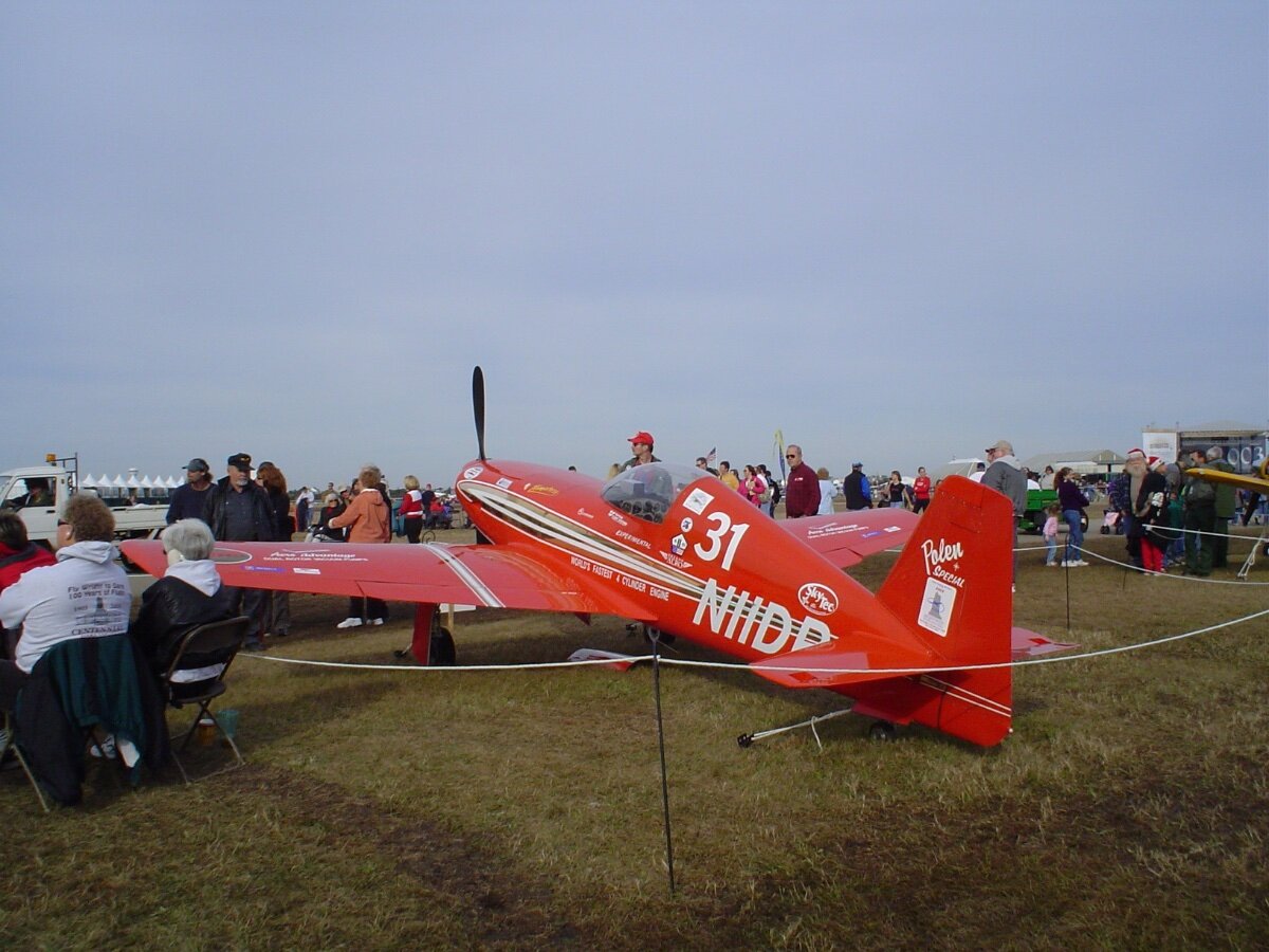

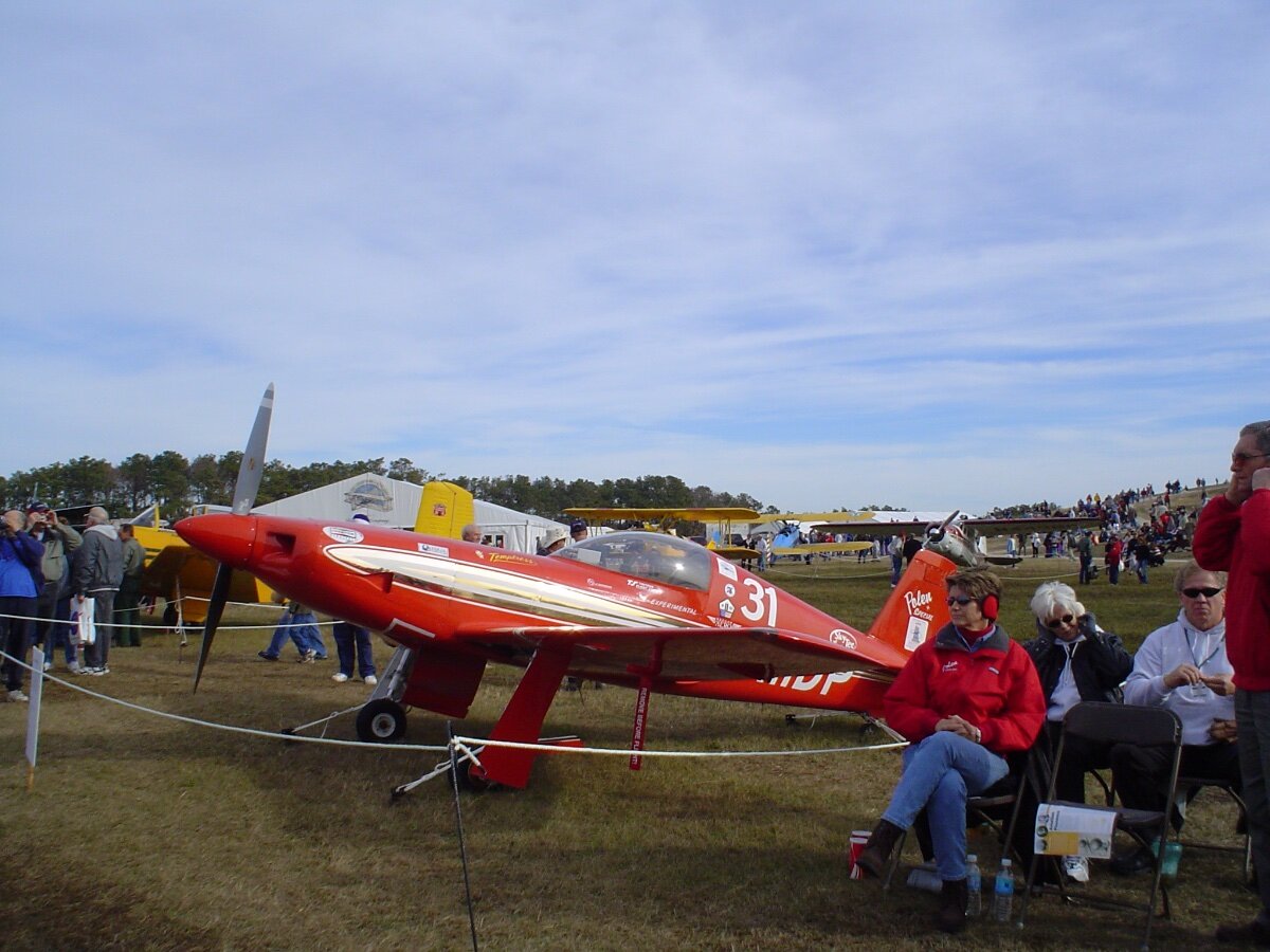

danny_galaga Posted 19 hours ago Posted 19 hours ago I was looking for an old backup CD of some software, which I didn't find. But instead I found my backup CD of the photos I took in Kittyhawk, North Carolina in 2003. I'm sure to find other interesting pics, but this was really interesting. I had a really good chat to the owners back then. I asked them about how they got the cowl so slim, and one of the problems they were having is the exhaust pipes burning through it. So between the pipes and the cowl surface was actual heat shield tiling from the Space Shuttle! That insulation was able to be really thin. That's an 0360 under there! https://en.wikipedia.org/wiki/Polen_Special 3

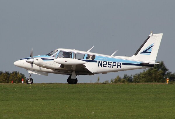

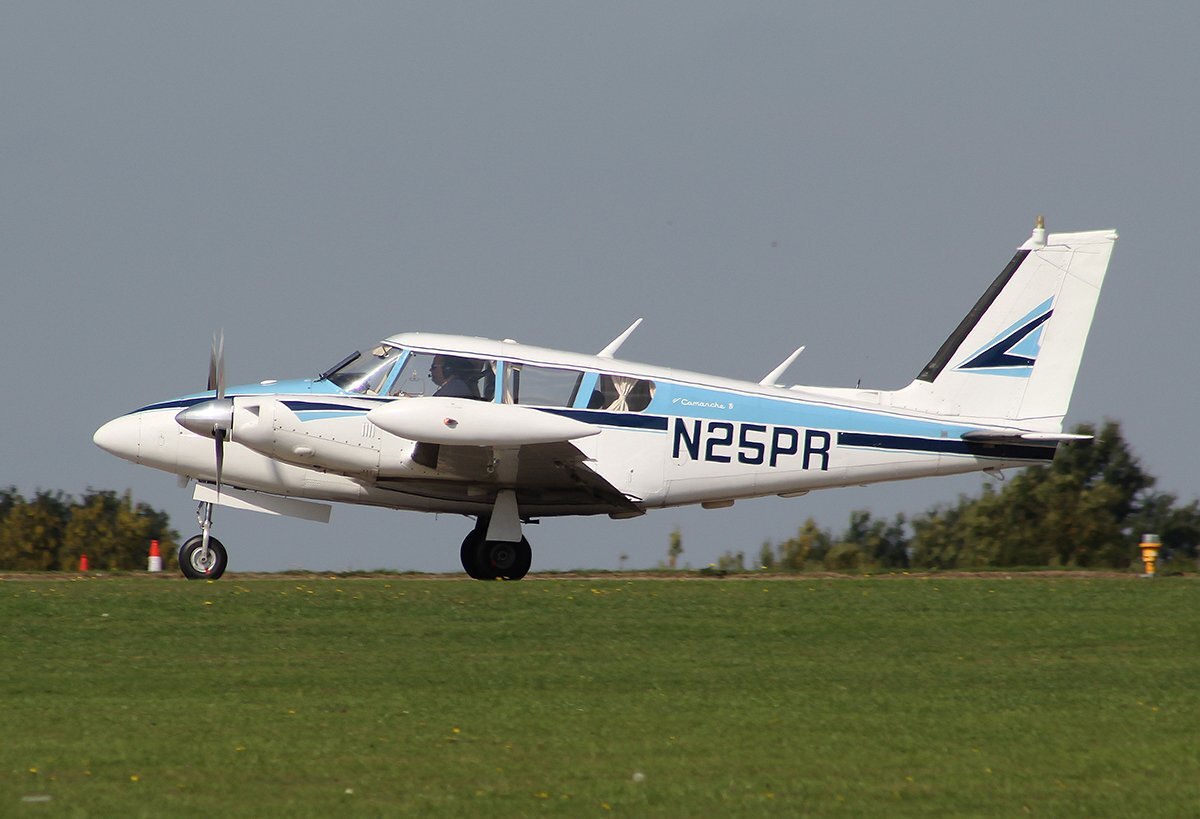

danny_galaga Posted 5 hours ago Author Posted 5 hours ago 12 hours ago, Thruster88 said: Cowl looks very much like a twin comanche. Well spotted! Yes it mentions that in Wikipedia 🙂
Reynard Posted 5 hours ago Posted 5 hours ago Do Comanches have any history of engine overheats ? Particularly heat soak ? That tight cowl must make airflow ‘interesting’.
facthunter Posted 2 hours ago Posted 2 hours ago With cowl flaps and exhaust augmentation only poor operation will cause an engine over heat. Mine (VH-LLV) was turbo charged from the factory when I got it. It also had an oxygen system for flying over the Rockies in the USA. It flew to here as well, across the Pacific. Some Navajo's got cooked but always by operator error.. It can be a high workload in a light Piston engined twin. Nev
